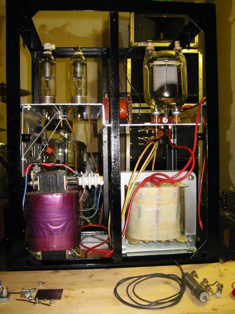

Hier ein Bild von meinem GU-48 pp Amp

Anyhow, a picture's worth a thousand words. That's a freakin' cool lookin' amp!

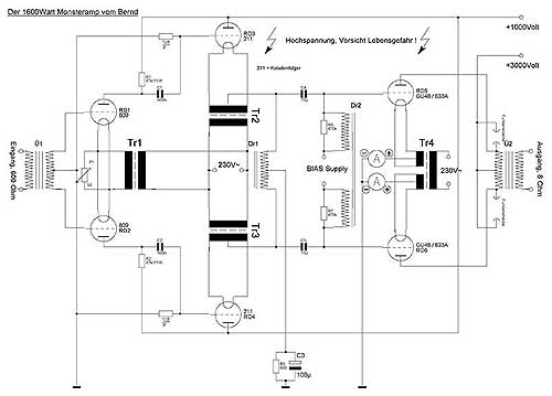

Otherwise it would be difficult to run class A with 3k on the plates. I could always be wrong, so I thought I'd ask.
Thing is it runs in class B not A...
Bernd was kind enough to send me an e-mail about the amp with a link to a gallery where the design is hosted.
I must say this thing scares the living daylights out of me...
Have a look:
DIE MOEHRENBUDE...
I'm assuming the "A"s with +&- around them are that.
They look like CTs for the heaters to me but I'm not sure either...
Cheers,😉
D'oh. Those are, of course, the mA meters. Must. Jumpstart. Brain.
Wow. He's running those full tilt? I wonder how he damps the clanking when he walks. That's one heck of a beast.
I get "funkenstrecke" translated as spark gap. Now I'm scared. I was wondering how he'd deal with the transformer kicking back during cutoff.
I am duly impressed and suggest considering prolonged psychological counseling.
