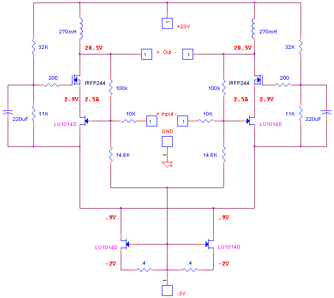

Okay . . .
I understand that when we stay in the concave area of the Vds-Id curve of LU1014, we get the 2nd musical harmony of Triode. Therefore, we want to stay in this concave area. However, if we have a constant Vds as a fixed DC – i.e. vertical line of the constant Vds in the Vds-Id curve, we might get the effect of the 2nd musical harmony which might be not as best as we expect. If so, we might need to make the vertical constant Vds line slightly inclined (counter-clock wise) by introducing a bit of “modulation” on top of the fixed DC.
Unfortunately, all these effects will be canceled off when we have the differential layout. The reason is that the 2nd musical harmonics of left and right sides will be summed up and appears as a 3rd musical harmonic to the output.
Ayo . . . not to pour cold water to the “:flame:” . . . but . . .
O.K. we can get a little closer to the ZV7-T. Nelson said he liked it :D :D :D
I wanted no capacitors :whazzat: their almost gone. I wanted Inductor loading like the ZV7-T :yes: I wanted JFETs :headbash: Here is a Super Symetric version :smash: :smash: :smash:
But I still like the evolutionary variation of Grand Son Of Zen T :cheerful: :cheerful: :cheerful:

Some further work in the design progress :smash: :smash: :smash:
Magura, I investigated your comment 2x80mH inductors:smash:
And, Carpenter I believe uses this value too :confused: :confused: :confused: The reason I used 270mH is basically to maintain gain to a minimum freq. I think the 270mH should not be down to 8 ohms until about 5Hz :D 2+ octives below 30Hz. O.K. I guess I'm over doing it :confused: However, I'm wodering about Nelsons comments regarding a Henry of inductance :confused: :confused: :confused: I guess the 80mH will be about 8 ohms at 15Hz. A full octive below 30 :D
In my simulations I originally had trouble using a transformer model and reverted to 2 inductors until I straitened out some issues. However, I thought it time to re-think some of this bis.
The inductor load is not just an inductor. It is a coupled set of matched windings connected at the center tap. Or, a 1:1 transformer connected out of phase at one end. When doing this we cancel any feild with the Iq to be left with only the DC resistance as a load at idle, fine:D But, with differential action taking place caused by signal amplification, we dont see just the 80 or 270mH. We see the 2 in series making 4X the individual winding inductance. However, that would be only 2X per side. Isn't this thinking correct :confused: :confused: :confused:
Therefore, if we have 80mHs/winding, the actual load on each side will = 8 ohms at about 8Hz. Or bout 2 octives below your minimum expected frequency. Effectively a 160mH load???
Am I out in space or what :confused: :confused: :confused:

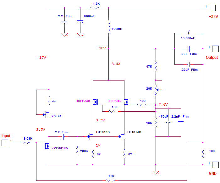

I made a test setup of a J-ZV7-T a while ago, which sounded better than all the other mutations I've tried so far (I've built most of the suggestions made on this board, counting out the buffer stuff). Now a clever guy would just post the schematic, but that's not going to happen cause I've lost it :bawling: and the amp is no longer in one piece. It was obiously the way to go though!
I will try to find the time for making a new test setup (pretty hung up right now) and TRY not to loose the schematic before I get to post it ;)
Magura :)
Hi Magura,
I assembled a jfet diff pair last night. I'm using the same schematic as for the ZV7-T mosfet version minus feedback loops. I bumped the gate to ground resistance to 220k and added 0.5 ohms to the source pins and 2 ohms between the drains and choke. I've worked her up to 12V, and have 0.5V on one source resistor, but no voltage reading on the other?
