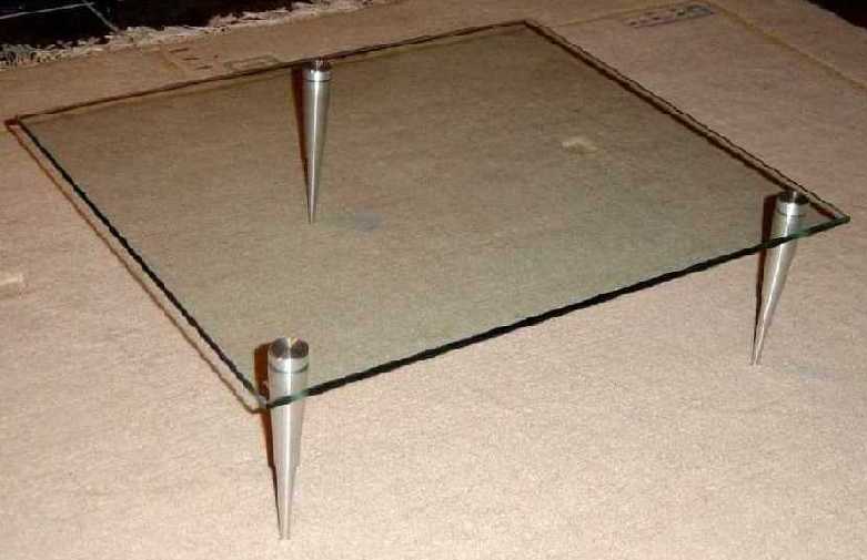

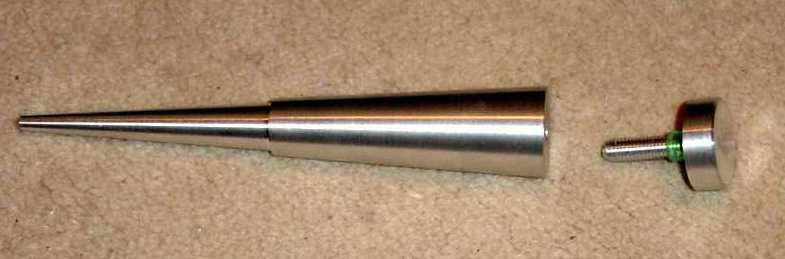

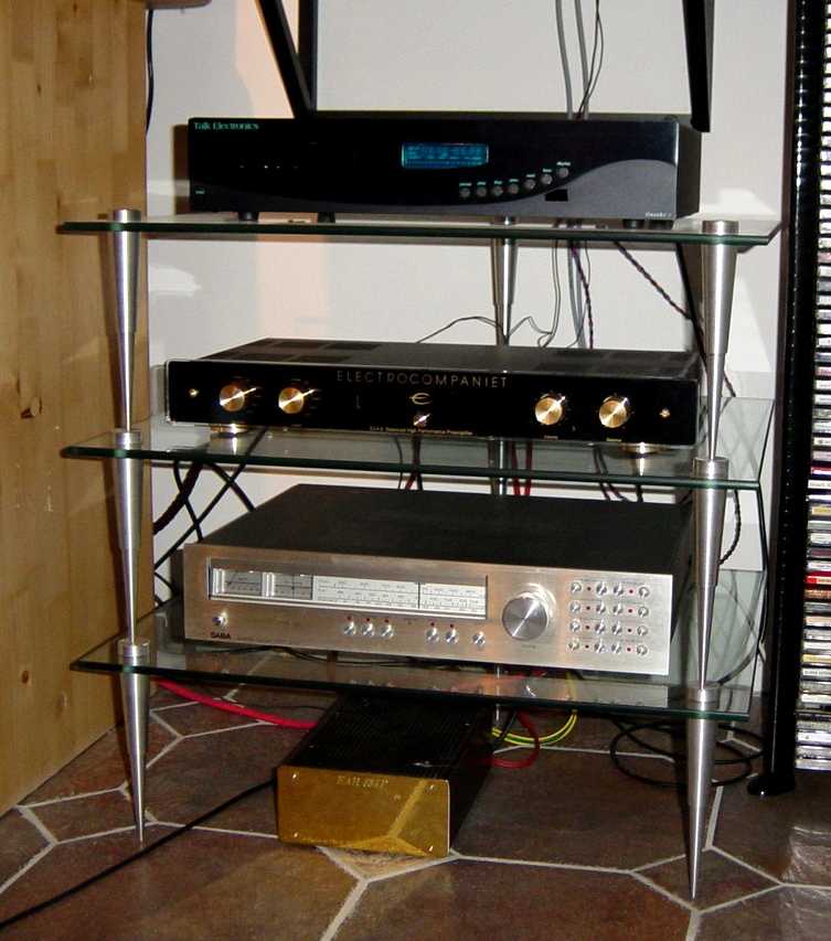

I realy liked the Gryphon equipment rack calld Simphony when I saw it first. But it cost about 1400$. This is simple clone or mutant better said made at aprox. 150$. Basic design of the suport leg is taken from Simphony, but this is three legs stand, with no screw conection betven shelwes. Supricely stabile, strong (tested on 50kg), and (it`s a mater of taste ofcourse) nice looking. Relative unexpensive. Maybe a good idea. Legs are Al shelwes - reiforced 8mm glass (it can be stone, wood, acryl.......). A few pictures.
BTW - it is not realy a DIY project, it can not be done at home unless you have the right tools, but it is a good example of corelation betven real material cost`s and selling price for some product`s.
regards
Marijan
picture 1 - stand comleted
picture 2 - one peace of shelwe
picture 3 - suport leg

Hello Per Nielsen,
As I said it is not realy a DIY project. I couldn`t made them at home. I ordered the glass and legs from the workshops dealing with that stuf.
Otherwise, dimensions are: reinforced glass platform 500x600mm 8mm thick, legs are 18cm tall Al conus from 30 to 0mm (spike), total weight is cca. 25kg while the Gryphon has cca. 45kg using stainless steel legs, four of them, and 10mm glass. Material costs for original clone would be around 300$.
It may look the oposite (construction is a little exotic) , but stability is amazing.
regards
Marijan

An interesting idea...I see a few points that can make for an improvement already....
Just imagine some silicone rubber damping rings slipped around the conical pillars at strategic places, for instance...:idea:

Hi Frank
Yes, that was an intention, silicon or teflon rings on the two contact places betven metal and glas on every shelwe. There is allso an idea to use a sendwich platform (acryl-al-acryl), or idea for exotic looking platform made in sendvich form: top plate-4mm black acryl, midle plate-3mm transparent acryl, botom plate- 4mm black acryl again - polished sides. Then you could dril a center hole from the botom side of platform, reaching the midle-transparent layer of the platform (not throught black top layer) and insert a litle buton batery powered light with a micro switch. Imagine that in a half dark room. Three rings of light and components floating on it. Haha, a kind of diy SFiction.
Stend is very fleksibile, you can made an extra shelwe any time you want, you can prolong the legs with aditional pice of Al,you can use any kind of material for platforms........
