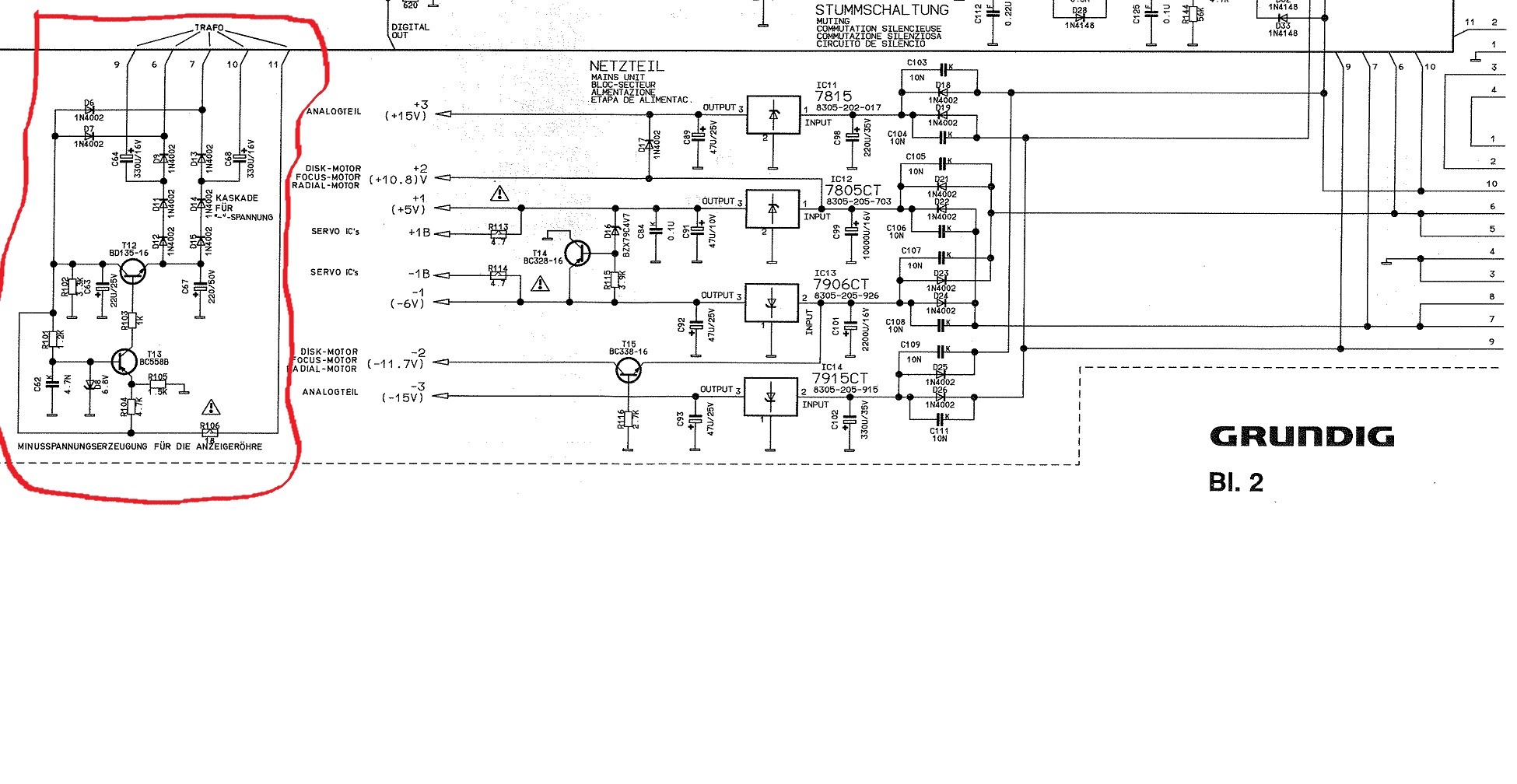

Hi, Can anyone eplain to me what is part of the PSU is doing or where its going? Its seems to share the lines from the transformer but what is it powering? Thanks in advance...I've circled it in red

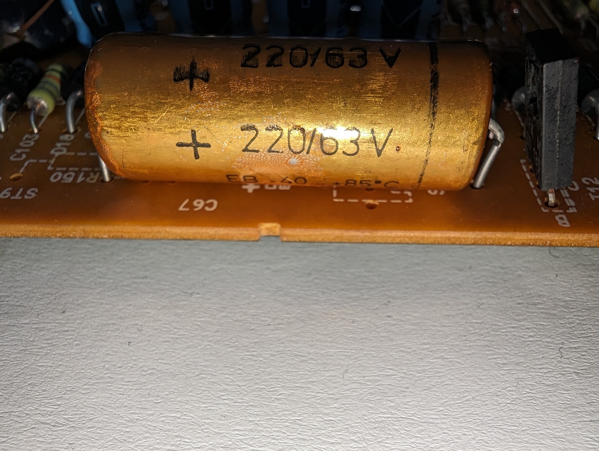

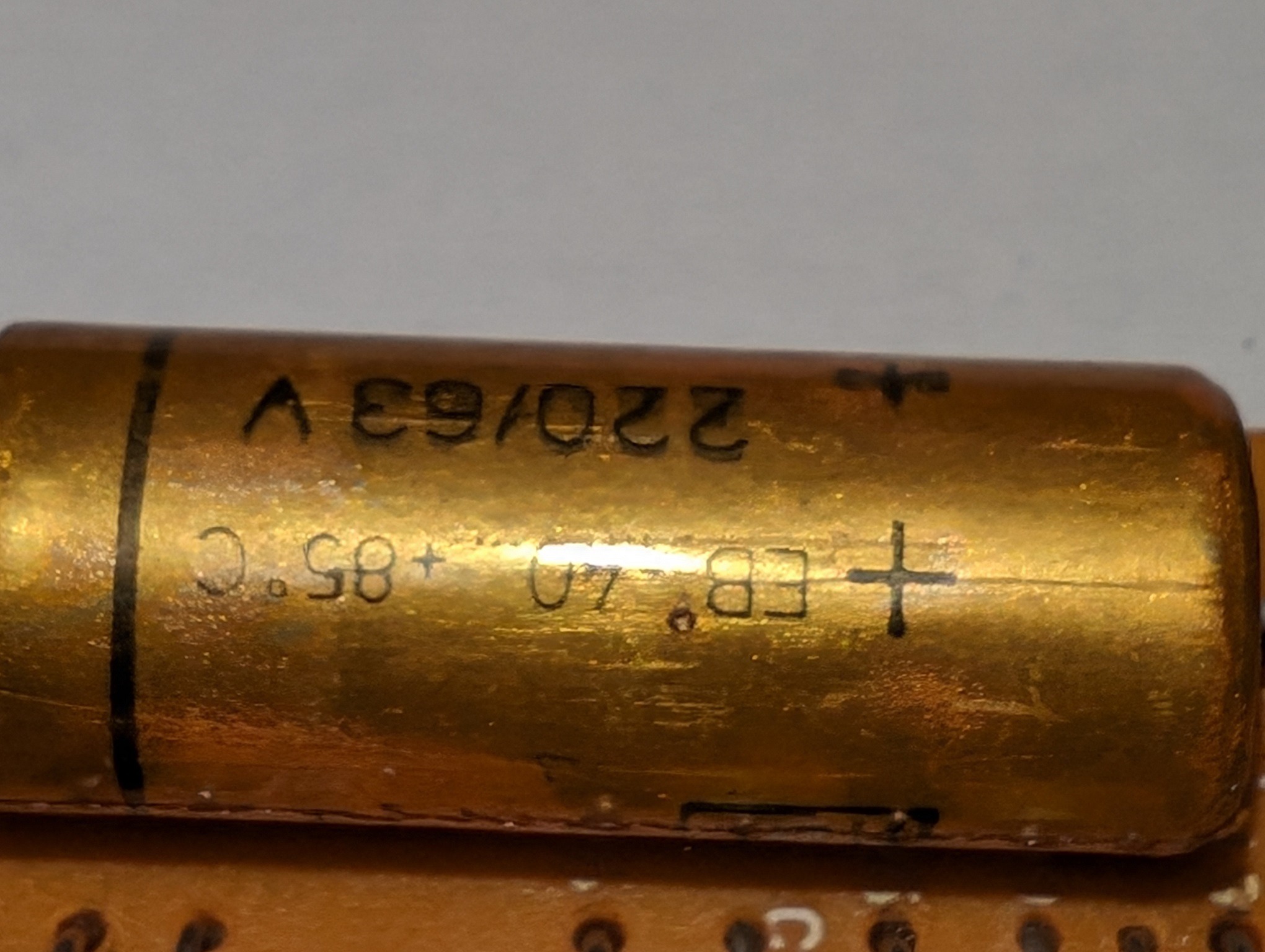

Wow thats the longest word I ever seen! But why use such a high end German capacitor? These ROE are expensive. There is cheaper brands on the board.

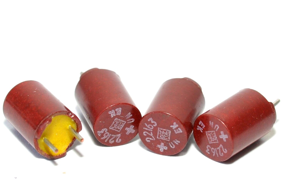

ROE (Roederstein) was pretty standard back then. Look inside a B&O product from 70-80..... It is filled with these.
Steady supply, easily available and not expensive at the time.
Nowadays they some have claimed "superior sound quality" resulting in some hype, and prices raising to rediculous for 40 years old
NOS capacitors. Unfortunately not all of ROE´s live up to that. The small radial RED EK ones dried out and showed sometimes less than
10 years lifespan. They cracked and dried out. Not worth the trouble contrary to the hype.
The orange ones shown in your pictures strangely enough seem to have an everlasting lifespan.

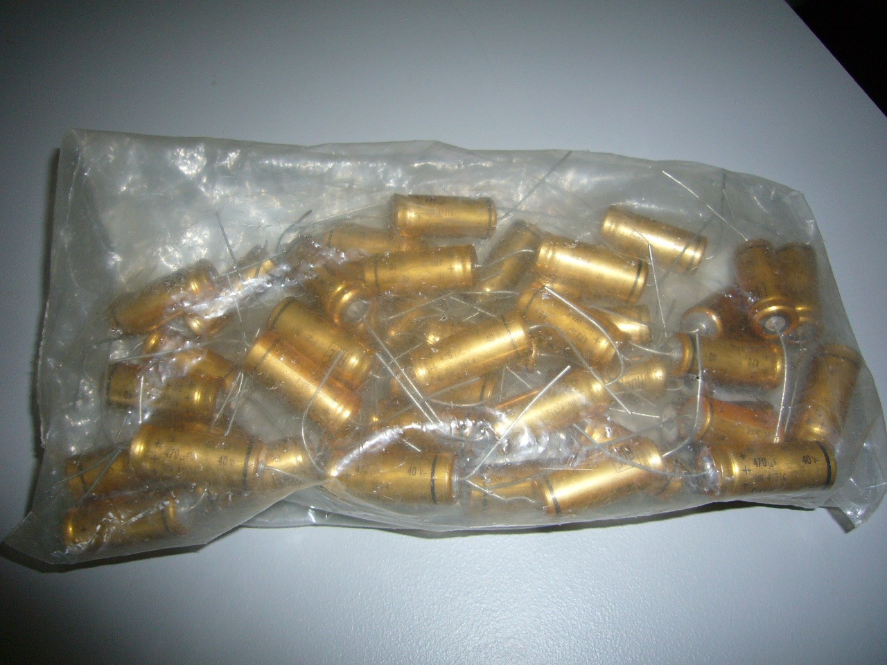

Somewhere in my "mess" I have some bags of 470µF/40volt, from back when Gryphon considered them
good enough for their products 😉

Back to our german long words lesson.... Minusspannungserzeugung.
Notice the 's' ! (Negative voltage generation).
