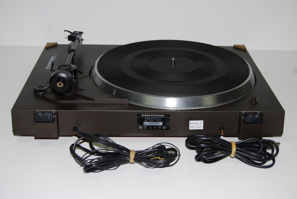

hello colleagues. A few days ago I bought my first turntable. Grundig PS 2500. Everything was fine until I saw that the needle was covered in dust. I touched my finger and the needle was gone. The AT71 cartridge is there. the question whether to buy an AT71 cartridge and that's it. will it be possible to change to another no. orthophone? worth investing what is the best way to clean the needle?

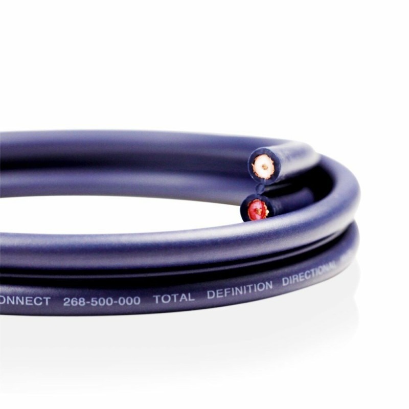

Any decent twin shielded/screened cable will do as a replacement, see attachment.
I'm not sure what you mean by "Can I cancel the channel leading to the preamplifier?" - please explain your problem in more detail.

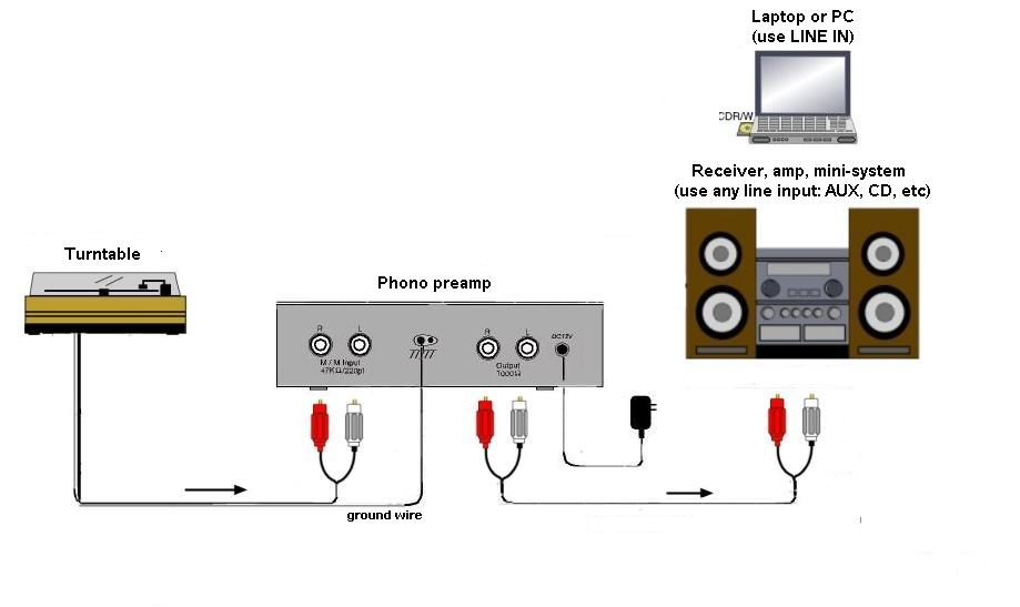

Your turntable comes fitted with a twin RCA cable and a separate ground wire as shown in the first image.
It should be connected to the phono preamplifier as shown in the second image.
Replacement RCA/ground leads are available to buy, if that is what you are after.
Here's an example: https://saveltd.co.uk/quality-deck-...o-lead--earth-cable-audio-technica-6405-p.asp
If this does not answer your question then please come back - with photos if necessary.
