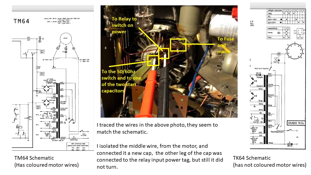

Grundig TK64, PAPST Motor 7882-032 Failure
What a great read ! Hope you all can help me.

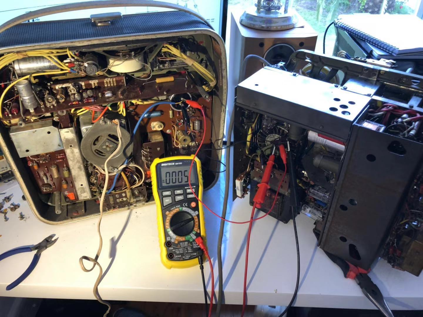

I am restoring a grundig TK64 spent many weekends got it all working, then after 2 hours of running, the motor has ceases to spin any more
I cant find a suitable schematic, as mine has a 50/60 switch, as well as TWO large motor related caps, sandwiched between two chassis plates, almost impossible to get out.
The color coding is very hard to see, one see, if i am guessing it could be red, yellow and green. SEE Photos please.

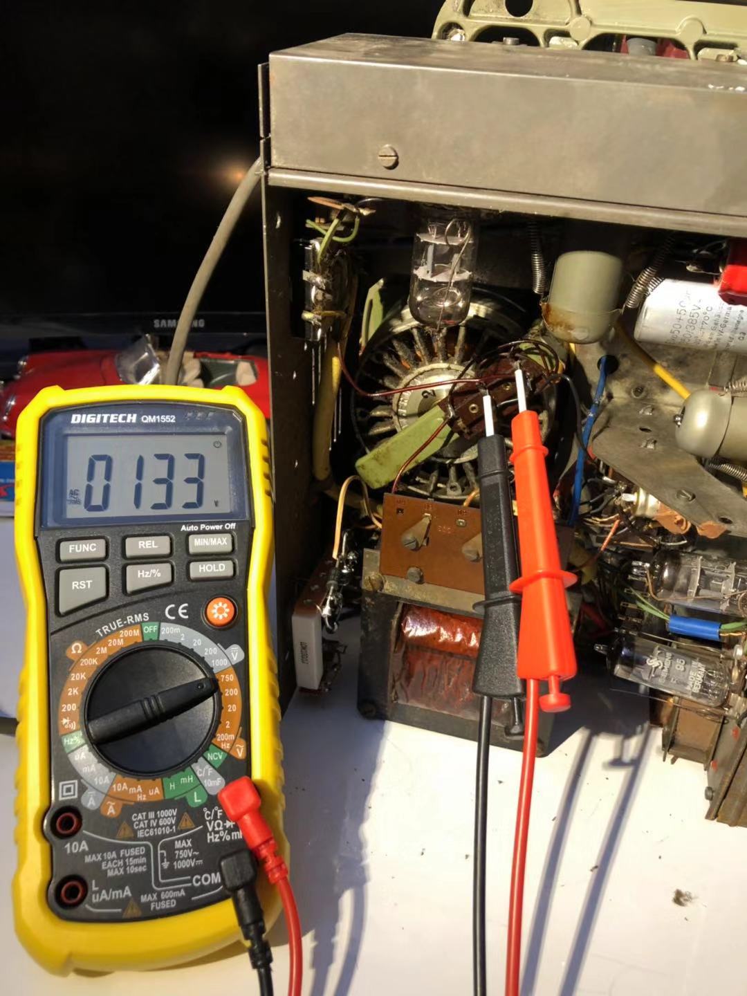

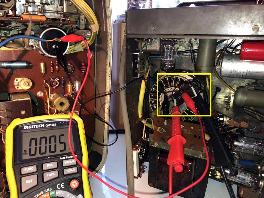

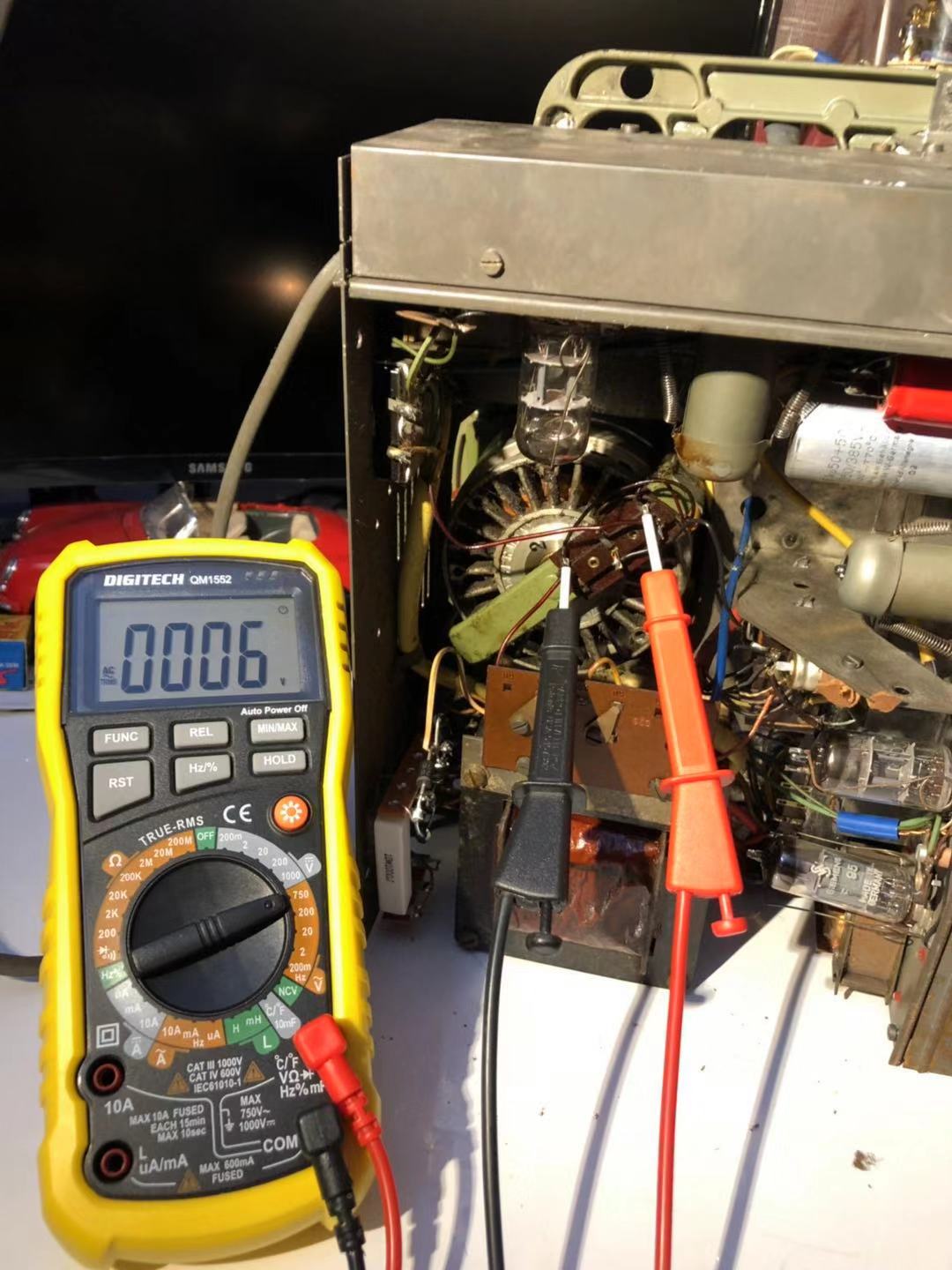

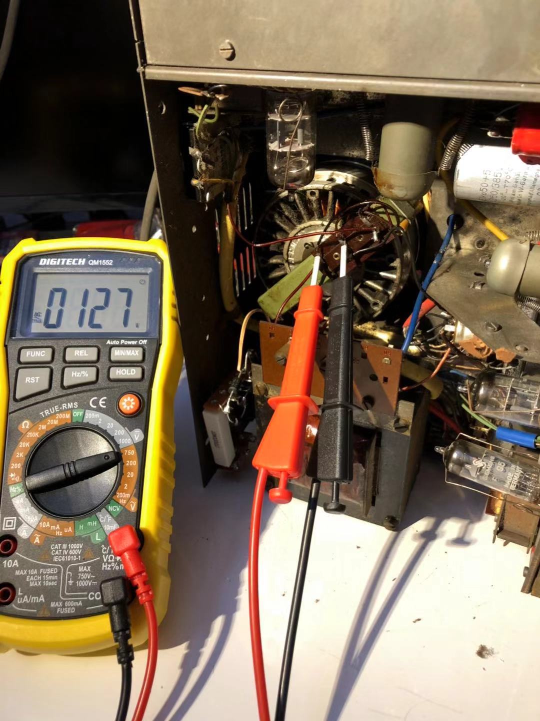

Seems to have 117-120v across two of poles, and nothing on the 3rd pole, which is where the cap joins in.
I just want it to spin, and am happy to hard wire it up, with a cap, but cant tell the wiring colours so how to do it ? Some others have said one is a start cap and the other is a run cap, as in the TK30. My TK64 schematic only has one cap, but there are two there in the sandwich.
