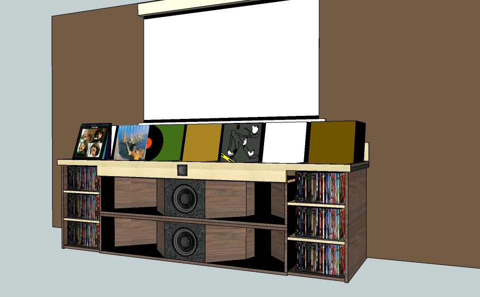

The bruce horn is a very large double horn designed for the FE207e. The printed specs for this driver model quite nicely in it and if the Q proves to be higher than printed then it will most likely produce bass that is a bit boomy and probably flabby, not too big of a deal for a center channel. I'd attach a pic if I could find my camera.
Good looking BVR and agree how it will likely perform, but why do you say it's no big deal for a CC? I mean even with a sub system to roll off much of its LF it still might 'color' the mids too much, so seems to me an OB of the same baffle area [or probably less in this case] would be the best choice overall. Regardless, the BVR's vents are plenty big enough to hold sufficient damping material to make it at least to near aperiodic if need be.
Anyway, hope you try them and report back.
GM
Well, I figure I already have these big beautiflul cabinets, that I don't want to use for mains, I have nowhere else toput them so I might as well put them to use. The chambers behind the drivers have been mostly filled in with MDF to kill resonance and if I set the center to small it should eliminate most negative effects. Here is a sketchup of what it should look like when complete.
