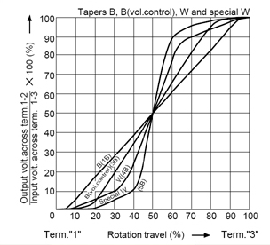

there's another possibility... oh, sorry i'm posting off topic messages.. but this is last one.
Have you seen this alps graph??
http://www3.alps.co.jp/pdf/2004pdf/pdf_e/Potentiometer/Resistance.pdf
maybe the W and W special types are like the model you have.
One more note: I have four or five ALPS motor driven pots... all have the ALPS logo engraved at left side. I think immitation does not have it.
Hope to help.
