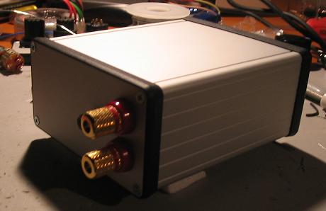

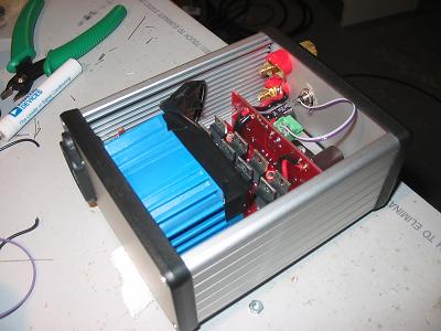

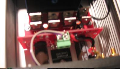

Just to prove it is possible, I built this tiny amp tonight in about 3 hours.
