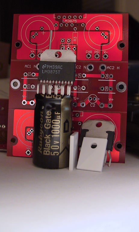

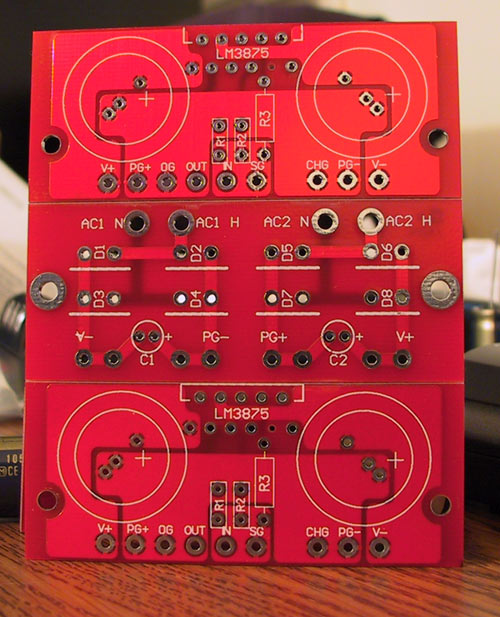

Here is a picture of boards. I will be testing them tommorrow (was feeling a bit ill today, stomach was bothering me, so I didn't have a chance to solder them together today). I will take pictures during the assembly process, and add them to my users manual that I am creating.
Looks like the group order isn't too far from being complete, as I have a large portion of the rest of the kit parts all bundled up.
I will put up more pictures tommorrow (of the power supply pcb also)
Brian

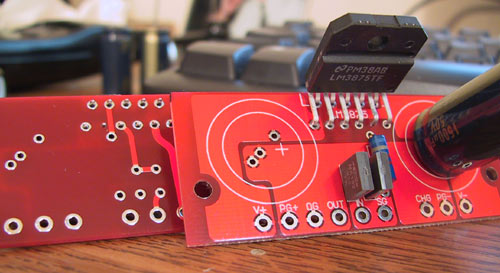

Here is a picture of the different types of caps:
(from left to right)
Panasonic FC 1000uF 50v from Digikey
Panasonic FC 1500uF 50v from Digikey (comes with kits)
Nichicon Muse 1000uF 50v from Percy
Blackgate STD 1000uF 50v from Percy
Brian
