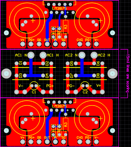

Here is a picture of the pcb. I worked with Peter Daniel, to get the design cleaned up, and added mounting holes that will work perfectly with his chassis that he is getting manufactured to go along with this order:

Very nice boards, Brian (and Peter). They should look great with the red solder mask. I'm still working on trying to get polygon planes to come out the way I want them in Protel.
Wow, that looks great. Hookup diagrams would help too. It looks like a dual secondary transformer should be hooked up 'straight', i.e. hot to hot and neutral to neutral on both secondaries. In other words, if you had a transformer with a single center tapped secondary, the center tap would go to AC1H and AC2N? It would be nice to know this, so I don't blow things up the moment I apply power 🙂 Diode orientation, that's another area where beginners could easily make a mistake (heck, I can see myself getting confused, and I'm not *that* much of a beginner) Or, if you're supplying a printed schematic with the kit, then mark the points on the schematic with their PCB names.
Also, on the audio boards, it looks like PG+ is the ground for V+. But on the PS board, it looks like PG- is the ground for V+. Is that a typo, or am I just missing something here? Wouldn't the grounds of the channels cross over if they're connected 'straight' from the PS board to the audio board?

The diodes are actually TO-220 packages, and they are all oriented the same way, so I think confusion should be minimal there. The grounds are fine. The negative half-cycle from the V+ rectifier goes to the V- ground, and vice-versa, I believe.

I will be supplying a printed manual, and a frequently asked questions document about the gainclone. I will make it as through as possible. I also have a gainclone builder's contest which I have planned, and will announce the details of it, once the first batch of kits are shipped out. I am thinking about giving out some sort of prize for the first 20-25 people to finish a gainclone with my kit, with the goal of this contest to start a building craze.
Sorry about the grounds, as PG+ and PG- are labeled backwards on the power supply board. I realized that just after I submitted the board files. I will have instructions the detail all the wiring and stuffing, so don't worry about it now.
Brian
Perfect. Thanks a lot. I hate to ask for hand-holding instructions, but I've learnt (the hard way) to be very careful around power supplies 🙂

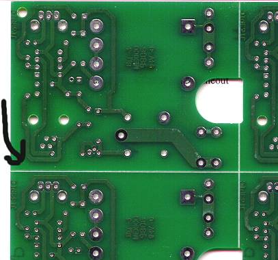

The boards will have scoring, which is a groove cut into each side of the lines between the boards, allowing them to easily be broken apart. Here is an example of a pcb using scoring:
It is the easiest solution to having a set of boards, as it makes shipping easier, and also packaging easier on my end.
Brian

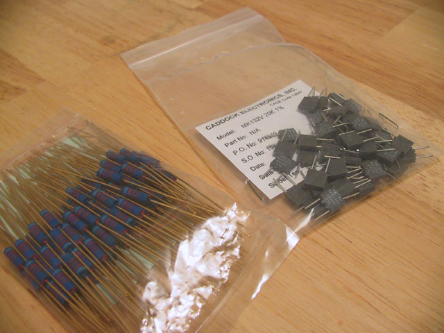

By the way, I got the first batch of components today, some Riken resistors and some Caddock resistors. I had to source the Caddocks from 5 different vendors to avoid the 5 week lead time on them directly from Caddock. At the rate going now, I will have to find more vendors.
Brian
