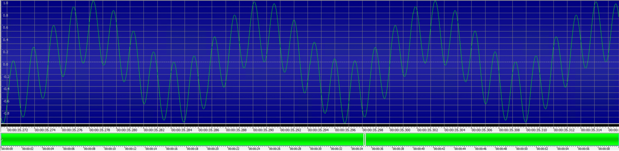

50hz + 51hz will have beating but it's a different problem, because they are very close in frequency and is not a frequency of Nx multiply of each other.
I use 80+680hz because they are 8.5x frequency of each other. Same as 30+255hz. They are not integer multiply, because we avoid bass tone's harmonics overlapped with voice tone.
In case you are still curious, here's the electrical input for 80+680hz 1:1. Do you observe any beating pattern?

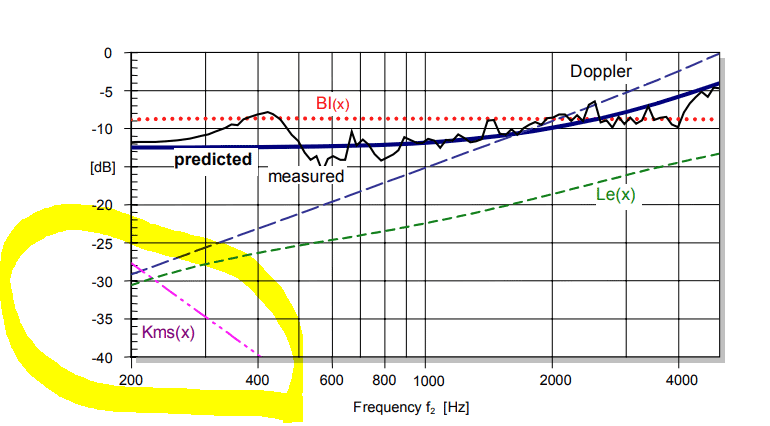

I'm not entirely sure of that. Yes, suspension causes bass HD (which is already show at spikes of 60hz and 90hz as HD2 and HD3 in the case of 30hz+255hz), but the idea behind IMD test is to isolate distortion caused by CMS(x) and BL(x) (also probably LE(x)). Because suspension nonlinearities only affect low frequencies.
https://www.klippel.de/fileadmin/_migrated/content_uploads/Loudspeaker_Nonlinearities–Causes_Parameters_Symptoms_01.pdf
As a proof, You can see some driver with poor suspension perform well in the IMD test, most notably W4-1720 with very bad suspension (I suspect ~2mm of linear range) but very long magnet gap.

Agreed, I picked the worst of the parameters to make a point here. Kms(x) is not the main culprit. Also agree that none of midrange drivers were tested here. The SB15 may be marketed as a midwoofer, and I'm sure it would hold its own against other midwoofers. But given the way it tests I would use it as a midrange only. I think the low FS and longer coil are nice in a bind but not sufficient when Purifi and Scan Speak make proper midwoofers.I'm not entirely sure of that. Yes, suspension causes bass HD (which is already show at spikes of 60hz and 90hz as HD2 and HD3 in the case of 30hz+255hz), but the idea behind IMD test is to isolate distortion caused by CMS(x) and BL(x) (also probably LE(x)). Because suspension nonlinearities only affect low frequencies.

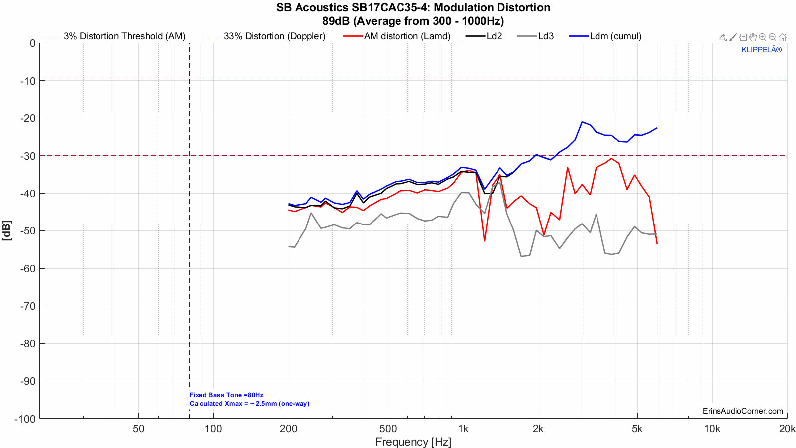

There's such info on Erin's website, for example:@racingpht The tradeoffs we make for higher sensitivity right! Better make sure not to drive pure midranges into high excurion.
A natural progression here is to see how things would look like at less excursion, to find the sweetspot where the SB just matches the Scan in IMD.
https://www.erinsaudiocorner.com/driveunits/sbacoustics_sb17cac35-4/
https://www.erinsaudiocorner.com/im...7CAC35-4/SB Acoustics SB17CAC35-4_IMD_HPF.gif
The SB17 tested very good in IMD tests, almost matching 18WU. If you listen to complex music such as Orchestra, maybe Purifi is better choice consider the price is similar to 18wu.
@abstract
Interesting concept if 1hz tremolo. I'm not sure what signal is best for IMD test.. 1hz could be hard to converge in time domain though.
@racingpht I've looked at those tests in detail. To my eyes every test up to 7.8mm excursion the SB is matching or beating the Scan. I'd say that's in contrast to what we see here at half of that excursion. However, if you look at higher displacement, we can see some tests at 17.3mm one-way, which is impossible. That driver is likely limited to 12mm xmech. So I'm not sure how to interpret the results. Either the calibration is off by a lot and actual excursion is half of what is quoted. In this scenario I'd say the tests are corroborating your findings. Or the calibration is fine, but 17.3m is just a nonsense reading as the coil is bottoming out. In this scenario I'd say the SB looks to be superior unless bottomed out.
@cvjoint I agree. The excursion number is probably an estimation based on SPL or input voltage or something like that.
At 17.3mm one-way, the driver is likely destroyed. The stiff suspension of SBA should compress the excursion as other drivers do.. But we never know.
