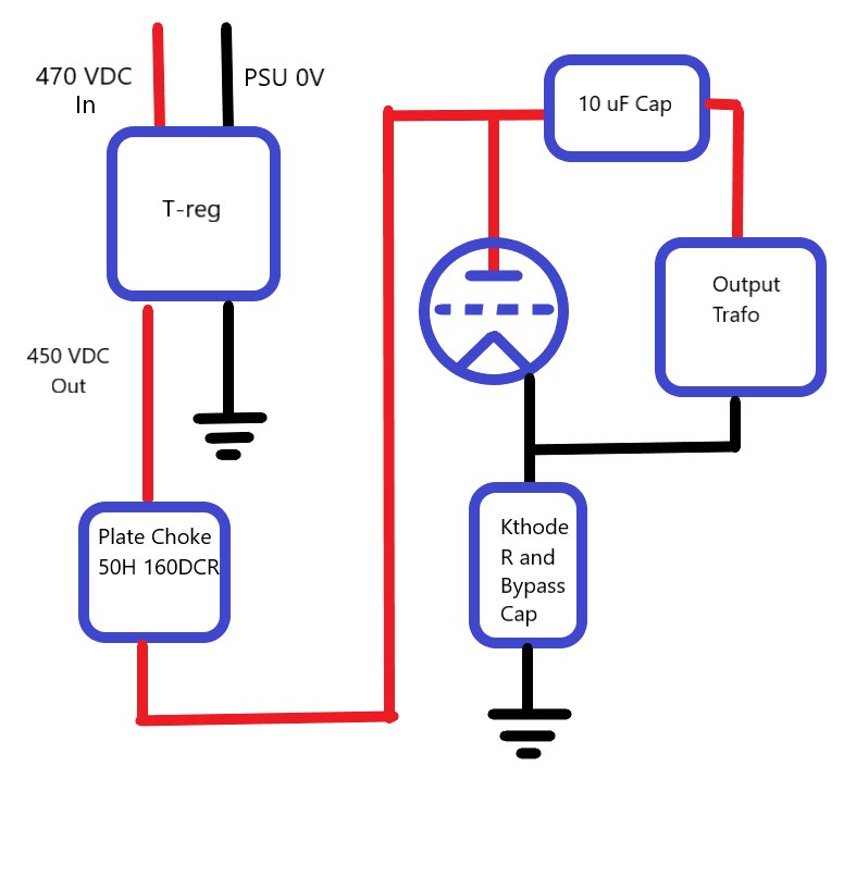

Looking for some help troubleshooting my installation of the T-Reg in a parallel feed 300B SET amp. The driver tubes already have their own plate voltage regulators, so I want to use the T-reg to regulate the B+ feeding the 300B output tubes to eliminate line voltage variation. Block diagram of my installation is attached.
With 470 very well filtered VDC feeding the T-reg, I trimmed the output voltage of the reg to 450 VDC using the on-board trimmer pot. But the 450 VDC wasn't stable. It continuously bounced around +/- 0,5 V (approx. 1V pk-pk) - I assume in keeping with my mains voltage variations.
Maximum current draw of both output stages (left and right channels) is 160 mA, and I have the T-reg max current set to 200 mA using 3R and 1R resistors.
Based on the above and attached info, does anyone see an obvious cause of my problem? Happy to provide any other info required.
Many thanks in advance, Derek

Deke, that output should definitely NOT bounce around, it should be rock stable, whatever the mains voltage (assuming the mains doesn't drop so far that the input to the T-reg gets below the set output value).
I think your current limit is a bit tight, there is some tolerance there depending on the transistors used. Try to set it higher like to 250 or 300mA, it is only meant to get activated in case of a problem, not to exactly limit the circuit.
Don't forget that the 160mA is a DC value (I assume) and in use the anode current will vary and get above (and below) 160mA.
Normally there is a power supply capacitor at the load, which is not in your diagram. Is it there?
I am not familiar with such a circuit, the plate choke is the load I guess, and in that case you definitely should have a largish cap at the T-reg output.

Many thanks Jan for the quick response.
Great. I will increase the current limit as you suggest.
The T-reg is fed by a CLCLC filter, but there is no additional load capacitor after the T-reg. The T-reg directly feeds the plate choke.
So a 600+ VDC rated capacitor across +ve and -ve outputs of the T-reg? Do you have a guesstimate of the range of appropriate capacitance values? I expect I may have to play around with different values, but a ballpark starting point would be most helpful.
Alternatively, do you think I could insert the T-reg between the L and the C of the final LC stage of the CLCLC filter? The last cap of the power supply is pretty big: a 1500 uF film capacitor.

It is just that I don't know how a voltage regulator reacts to a high L load.
Leave all the C-L stuff (except the anode load) at the input side.
Try 10uF at the T-reg output, but first check how it goes with higher current limit please. I am curious ;-)

Thanks Jan. Will do. I will first try current shut off set to 300 mA. If that doesn't do it, I will add a 10 uF film cap across the output. i will try this this evening and report back.
