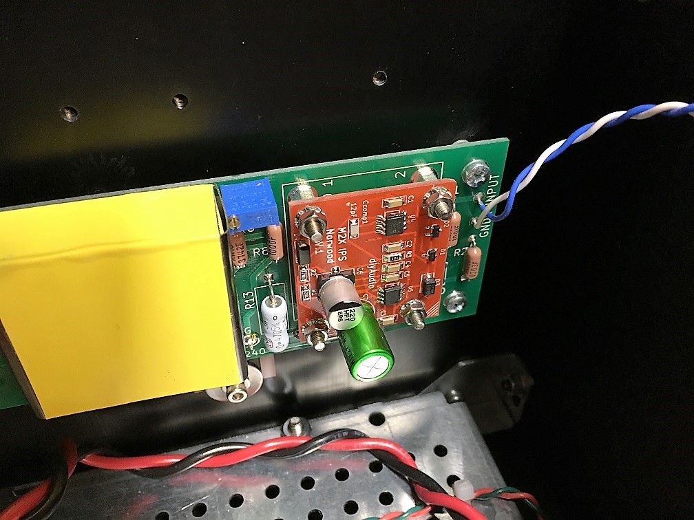

Received my Norwood boards tonight and they're playing beautiful music as I type this. First impression: Fantastic! More later. Thanks Mark!
The "secret" is out, you can see it pretty plainly on the photo.

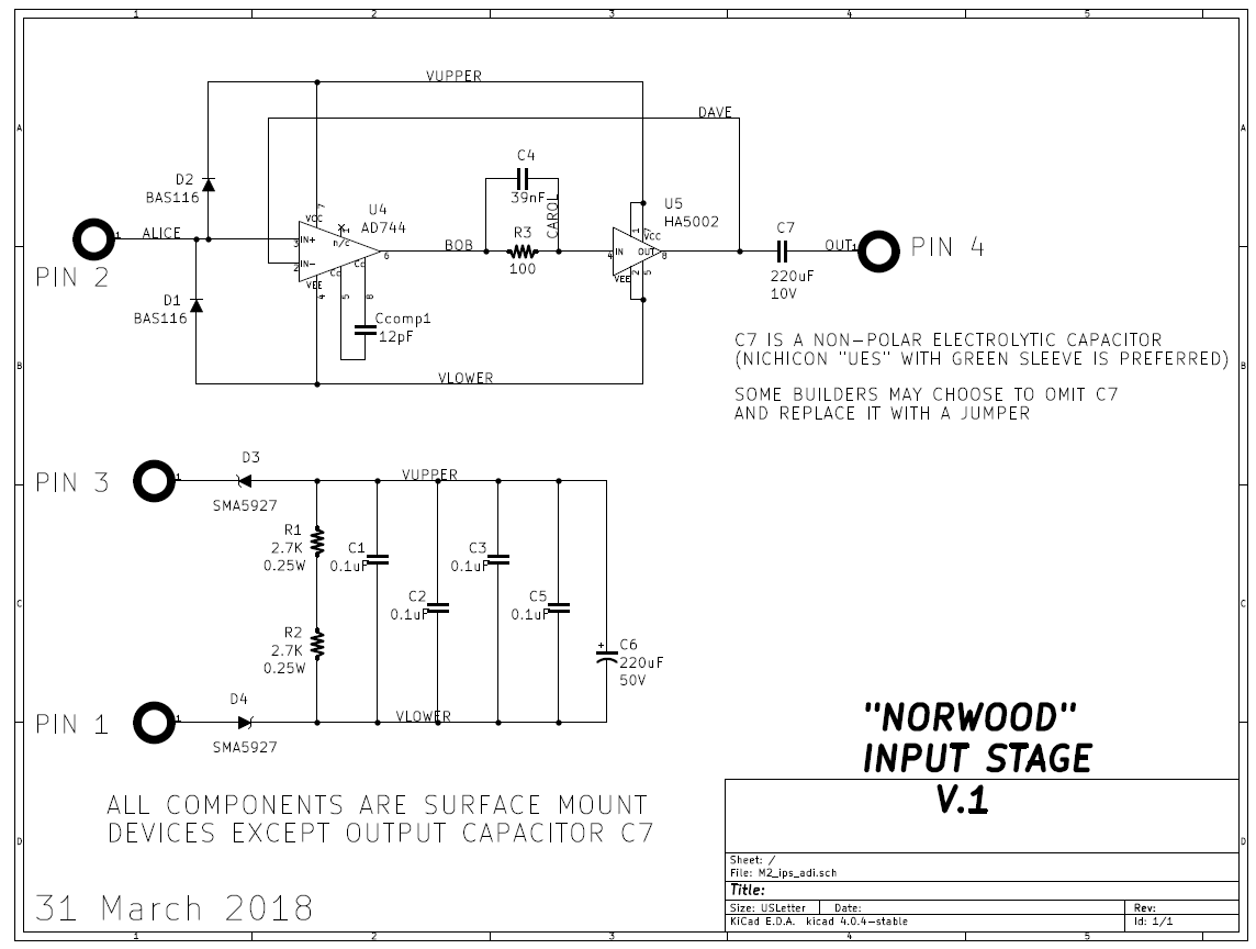

As the parcels continue to arrive at everyone's receiving dock, buyers might begin to notice that some Norwood boards have resistors R1,R2 which are marked "272", while other Norwood boards have R1,R2 marked "2701".
If you study the pixels really closely, you'll see that the photo in #68 shows "2701" markings on R1 and R2, to name an example.
This is nothing to worry about; it's just two different resistor vendors who are each trying to convey the same message: the resistance of this part is 2700 ohms.
Whether you call it poe-TAY-toe or puh-TAAH-toe it's still the same thing.
Norwood schematic attached, making it easier for circuit theorists to pontificate about the invisible subtleties and exquisite complexities of R1 and R2.
_
- Vendor A's mark says "272", meaning "2 followed by 7 followed by 2 zeroes, thus: 2700"
- Vendor B's mark says "2701", meaning "2 followed by 7 followed by 0 followed by 1 zero, thus: 2700"

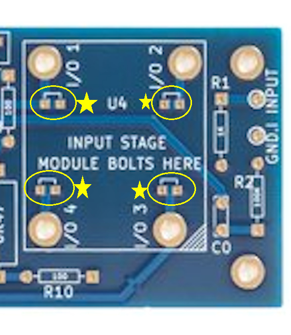

Use the U-shaped jumpers' plated thru holes on the main amp board (yellow), to solder an insulated flexible wire for each of the four daughter card I/O signals (bolts).
On the other end of the wire, solder a ring terminal as illustrated in the attachment.
When mounting the daughter card, slide the four ring terminals over the four bolts. (You can make your own decision whether to slide them before, or after, the PCB. Me? after!). Add whichever combination of star washers, lock washers, bolts, and Loctite adhesive that your theology requires. Done.
Now you've got a second, independent current path to get signals and power supplies solidly connected between mother board and daughter board. No longer are you dependent upon the bolts for connectivity. Feel free to use oxygen free copper wires if that's your thing.
Those jumpers would work very nicely indeed.
Even using oxygen free Cu wire lacks the wow factor of rhodium plated hardware, though.
I was just goofing, but wound up hearing a legit suggestion.
