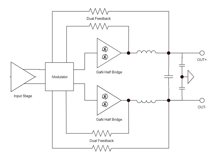

The modules use my proprietary dual feedback modulator. The modules are fully balanced from input to output using bridged GaN power stages.

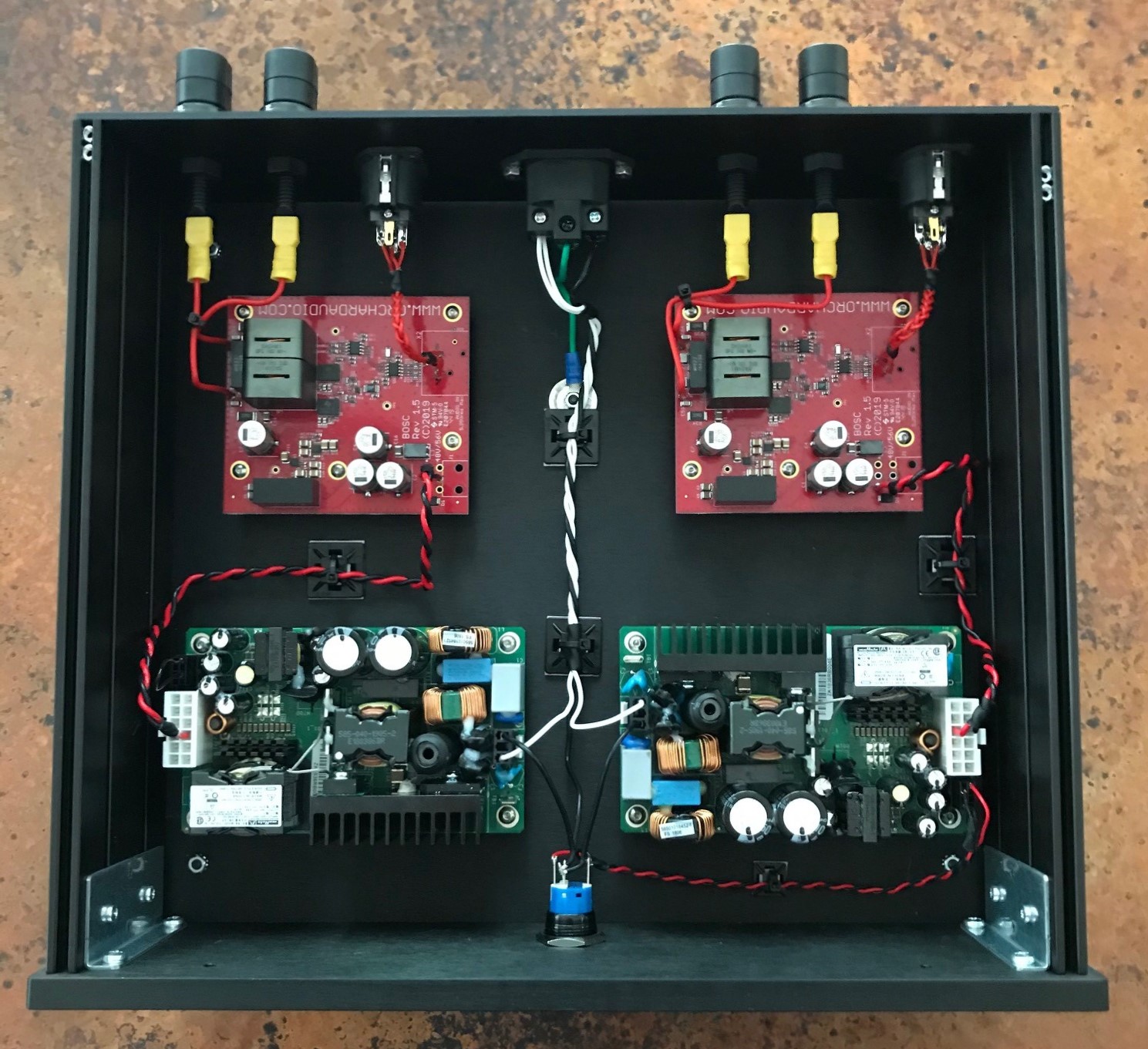

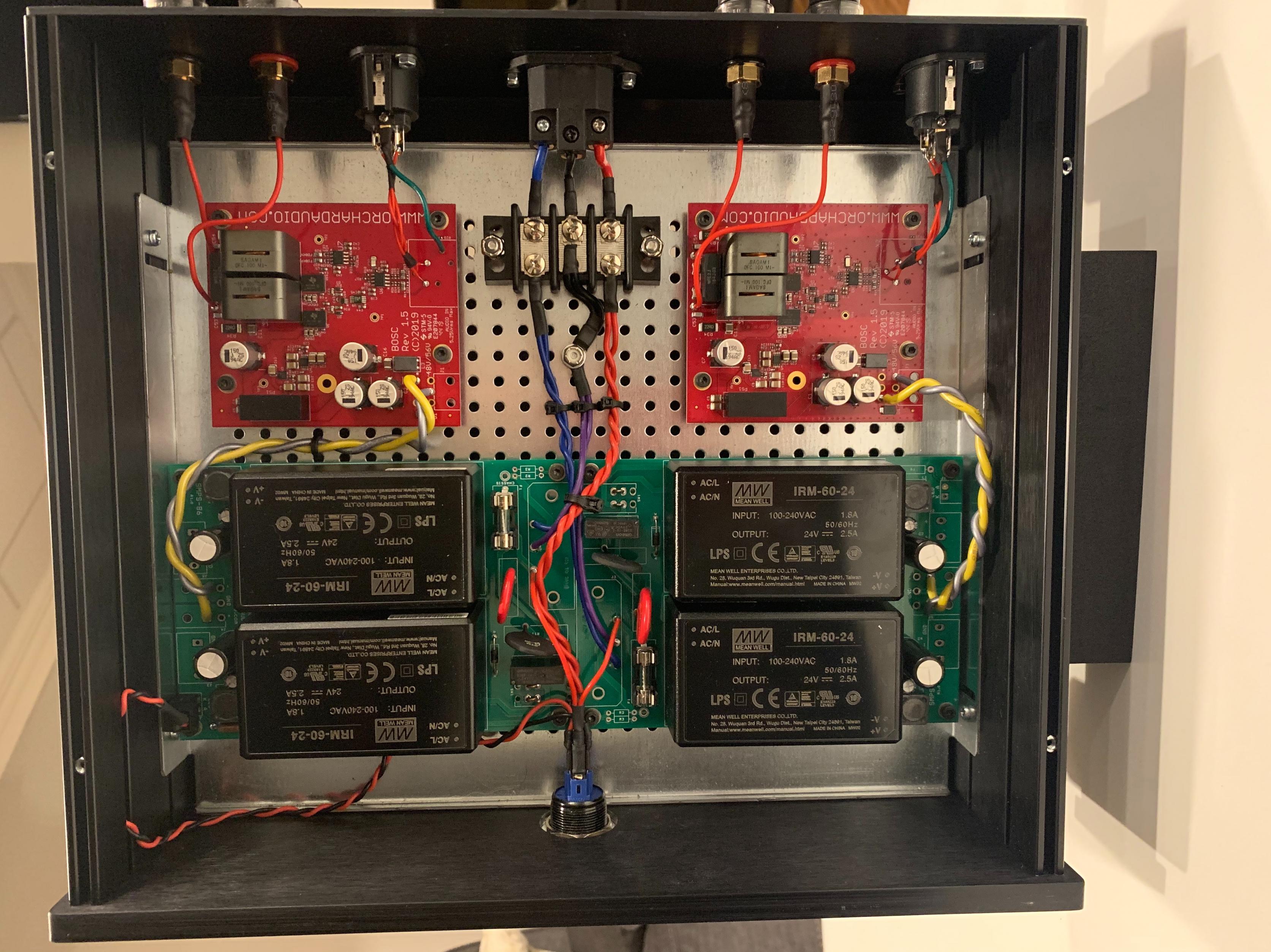

The first two images show customer builds.
