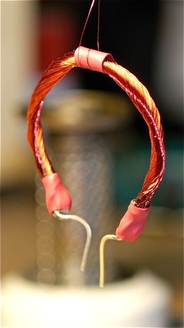

Hi Phil.
Would you also attach a lead to the other end, so you can make a loop out of your length please? Then try it with both ends stuck into the ground lug and then with only one end jammed in there. Just to see if it makes an audible difference.

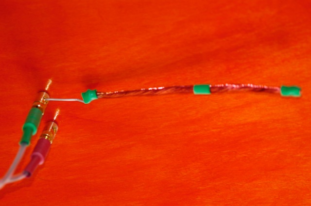

Like that. Shrinking the middle piece of tubing won't hurt either. I use an Olfa circular razor knife to cut the slits after I shrink the tubing FWIW.
For my units I actually have three pieces of shrink tubing for a 6 inch length of Litz. The end pieces are fully slit down their length with the Olfa knife and the center piece slit on the ends to about 1/3 the overall length. The little contiuous piece left in the middle actually controls events above 4 kHz or so.

I use the standard polyethylene type. I also use the sort with glue in it, I think it is still polyethylene, but not certain. The real key here appears to be relatively low dielectric constant, when used with a Litz wire loop. With less surface area cables, the importance of the dielectric constant becomes less, but I have no objective measurements to point to.
Basically, add material length until the sound gets smeared and then back off from that point to taste. Same sort of tactic will get you a listenable high frequency effect by altering how much center section is left, in the center piece. For the 140 strands of #40 Litz I use, most speakers need no more than 0.6" long pieces of shrink tubing, with cuts according to the above posting.

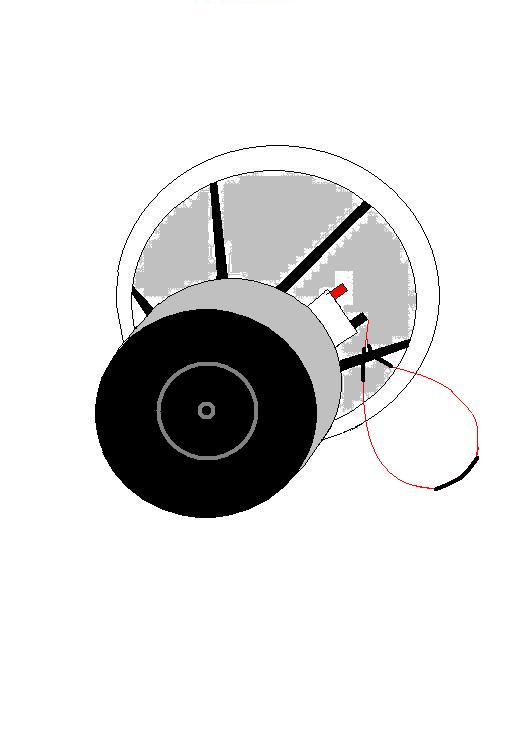

My thinking was a shorted wire, just not the way you suggested to Phil. That is, Phil had a coil of wire around two screws. Snip one end of this coil, tin the cut ends, add shrink wrap, then add pigtail for the connection.
In Phil's case, sounds like he stripped the insulation so I guess what I'm suggesting doesn't create a loop. But if you're using individual strands that are insulated/coated (like Litz?), this would seem to create a loop as you suggest. It's just that it would be in a linear form. Maybe I can draw this. And maybe I should just try it...

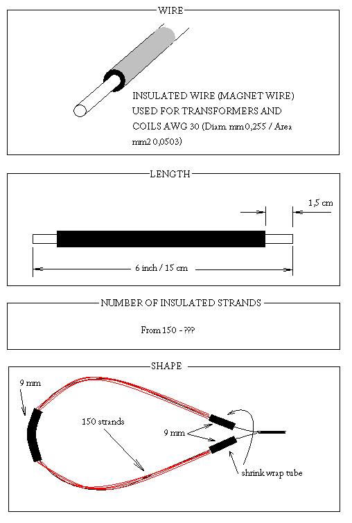

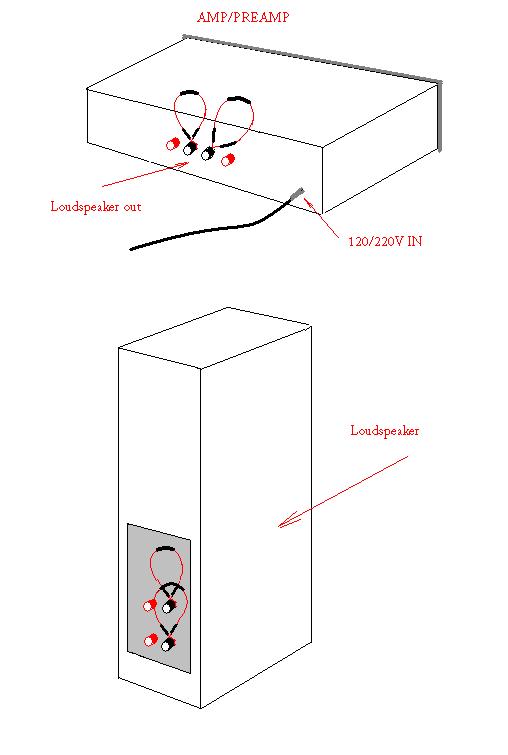

If you can post a picture of your setup it will be of great help for us who don't completely understand this concept.

Excellent depiction, that looks very correct from my understanding of the idea. It certainly resembles the loops I'm using.
