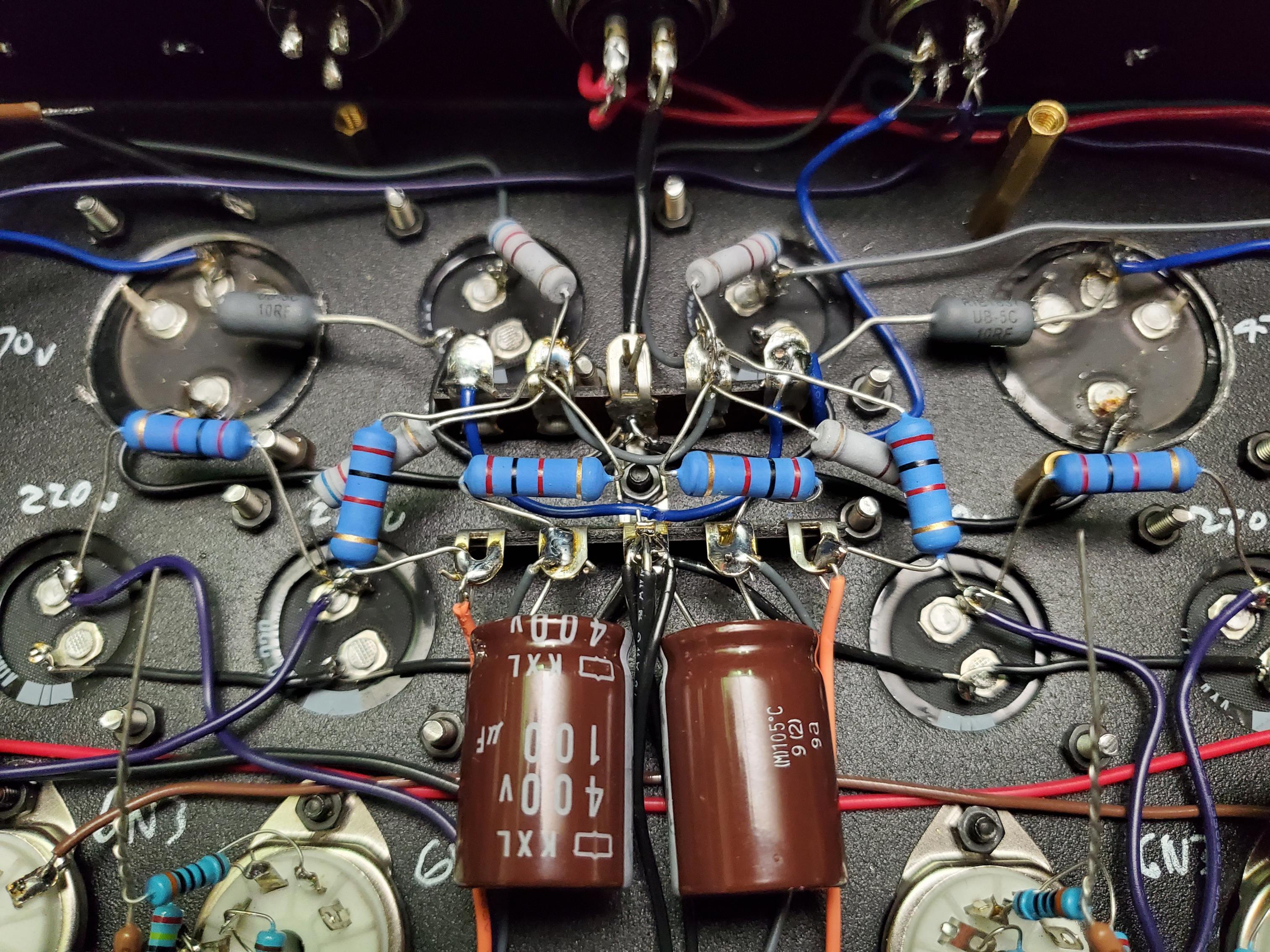

For those 3 and 5 lug terminal strips, you can use the #4-40 insulating shoulder washer that you would get with a TO-220 heatsink mounting kit plus a plastic acorn nut to isolate these terminals from the chassis. With those terminals isolated from the chassis, you can then use wire to create a ground buss to your liking.
I'd use a larger strip that is securely bolted to the chassis (with no insulator), and cannot move around.
There are terminal strips with no solder lug on the mounting terminal, or else on a regular one you can
bend it down or cut it off.

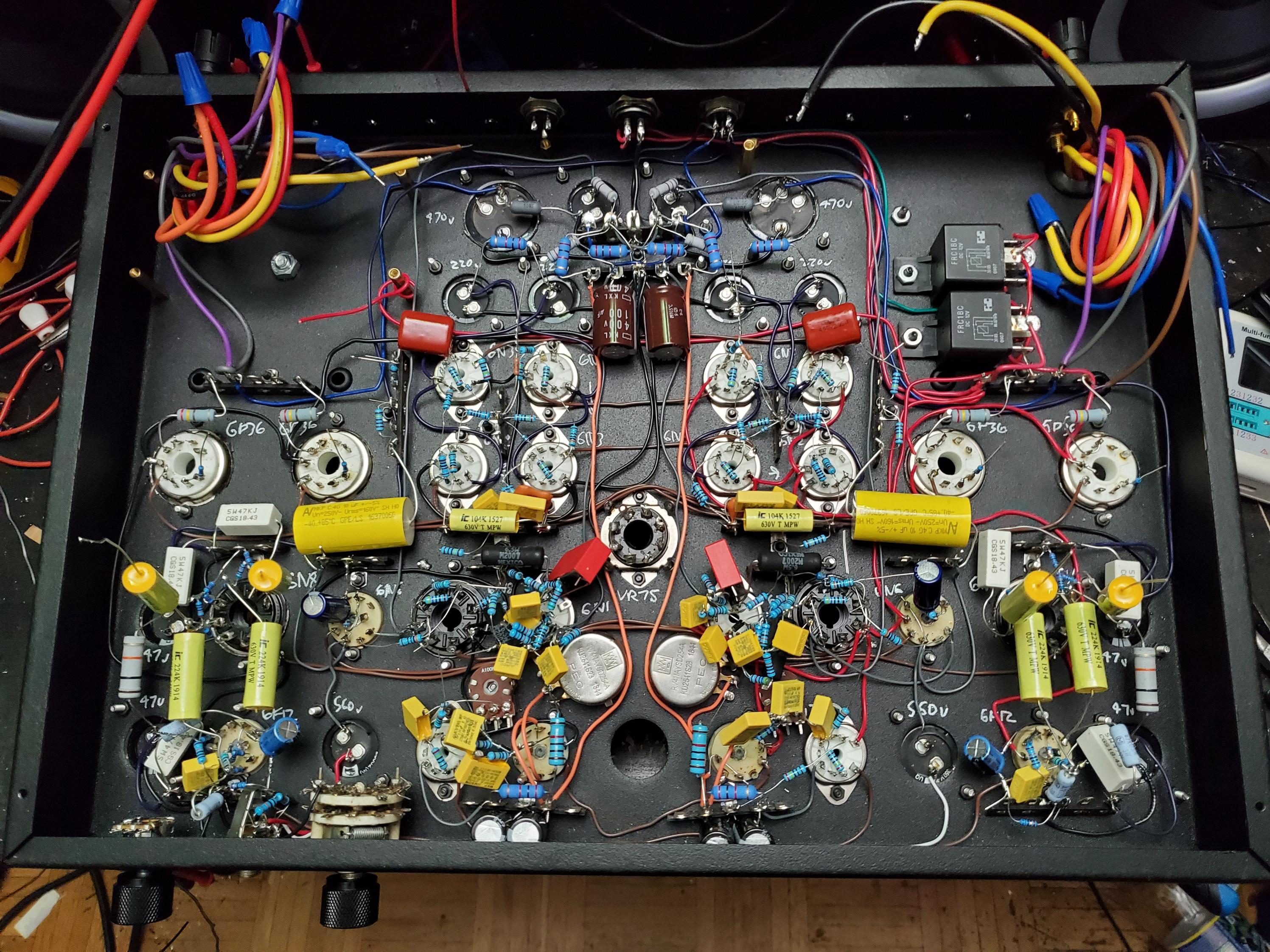

Here's one I was building today...
If you use the chassis for AC heater return you WILL get hum in the audio though. Any high current loads like power tube heaters should be returned with the power using twisted leads, but you probably knew that. In the case of this one, the chassis is grounded, the tubes on the left side are connected with the ones on the right side in series using 12V DC. All of the heaters together add up to almost a 10A load!

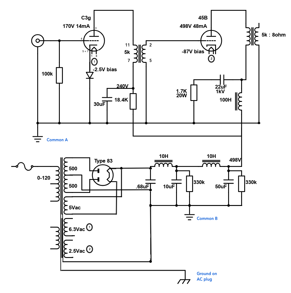

Please see attached schematic and let me know if I have my grounding correct.
My plan is as follows:
1. "Common A" for the signal related parts
2. "Common B" for the power supply parts
3. "Common A", "Common B" and power transformer center tap will tie together at the ground on the IEC inlet.
Comments?
Thanks,
Pat

The IEC ground should be attached to the chassis close to the connector by itself , bonded mechanically, not soldered. Since you're not trying to get safety certified to resale, you can do as you please though.
