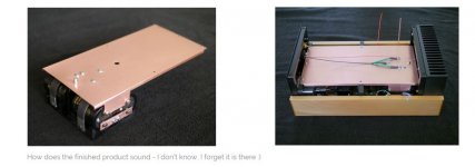

hmm here is an example of single point ground BUT spread over a wide area. uggh
the power caps terminals are mounted far from each other no apparent reason,. All 4 bulk caps are orientated so the common connection was farthest apart.
This is problematical b/c you cannot control the high 120Hz charging currents. E.g hum inducing signals.
IMO rampaging 'mechanical' artistic engineer was left in complete charge of design.
I reckon the OP has altered his test subject in some way from the photos he points to. He should show a snap shot image of the amp open up on the testing area.

I am here you know 🙂. I had assumed that a thick copper plate would be at the same potential everywhere, rendering component placement less critical. We are all here to learn, rampaging or otherwise. What do you mean 'altered'?
Using a ground plane for reservoir caps is a very good way to lose control of where the currents go, as well as being totally unnecessary. Perhaps a sign that the designer was more interested in visual appeal than electronic performance? A little hum is not surprising.[/QUOTE]
So is the ground plane the reason for the hum? That's all I want to know!
BTW - the reason for using the ground plane was not aesthetic - it was to provide shielding for the amp pcb.
The blog implies no hum was detected if so something has changed from then to now?What do you mean 'altered'?
I would suggest putting cuts or slices the copper plate but that weakens mechanical structure. got plexiglass?
perhaps disconnecting the bulk caps from the ground plane and use wiring, perhaps rotating the caps so they all face each other would be ideal & quickest for testing I reckon.
Use a central ground scheme like AJT suggested on his posted drawing.
I suspect Andrew new guidelines are for chip amps with PCB ground planes which shifts the central ground heaven to the PCB bypass caps. This is a very rare case.

Hi number7, I would start by moving the input GND lead to where R4 or R10 is located and twist together with the input lead (or use coax). This will reduce hum caused by the large loop area at the input.
Connect PSU GND and Speaker GND lead to T or 0V. This is probably not the best place to connect them but will work for now.
Let us be clear. The correct way to obtain a ground reference point is to choose a point which is not on the cap junction conductor - and then connect this point using one and only one wire to the cap junction conductor. The aim is to have one and only one connection to the cap junction. You don't reference the circuit to the caps; you reference the caps to the circuit.infinia said:nope this is completely wrong! the central point between the bulk caps is ground heaven (single point) for audio PAs. If you take it from anywhere else you run the very good risk to have a potential difference or hum signal.

I think I must agree. There is a ground connection from the input RCA to the board. There is also a ground connection at the output side. I don't know this particular board but I assume that on the bard the input- and output grounds are interconnected as a signal ground, and that this is returned to the star with the wire shown on the output side.
By additionally connecting the input ground to the star you create a ground loop.
What you really want is on the board a signal reference ground that starts with the input RCA ground all the way to the output, and that does not carry any power return currents.

Many thanks Mark - you get first prize for actually answering the initial question!!!
