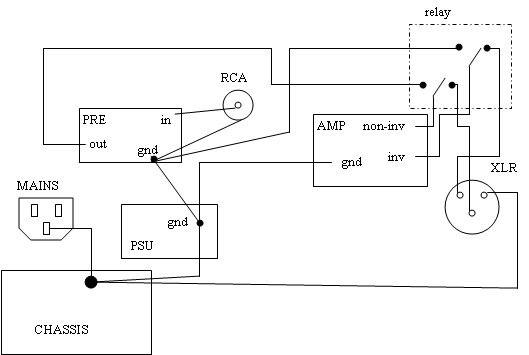

Ok, am I getting this right? I hope the diagram is not too confusing, just hacked that together in a few minutes.
The relay is really just a bypass. The goal is for the amp to be usable for home use without an external pre/processor , but to also be usable for PA use or in the future or with a more sophisticated source unit. Also to be able to compare SQ with and without the TDA chip.
That's basically right. You have two 'stars' (the XLR ground is going to the preamp not the star ground, so you could end up coupling the return path from the XLR into the ground reference) but there are no loops. That won't hum and the THD increase, if any, would almost certainly not be noticable. I've certainly done it that way myself.
Oh, and chassis grounds are usually not starred. They're removed from the signal path and do whatever. It's usually best to tie chassis grounds close to where they're 'coming from'.
The XLR return path never goes to the pre-amp, it either goes to the inverting input of the UCD module, or nothing at all.
Basically, the relay completely bypasses the pre-amp/processor circuit and couples the UCD modules directly to the balanced XLR inputs.
That's actually what I was going to do at first, for the IEC power connector and XLR connectors I was gonna use a very short length of wire with a lug and tie it to one of the nuts holding the connector in place on the chassis. For the PS, same idea, connected to one of the screws holding the PCB in place.
The RCA connectors I have purchased are insulated from the chassis, so that turns out perfect.
Thanks for the replies.🙂
