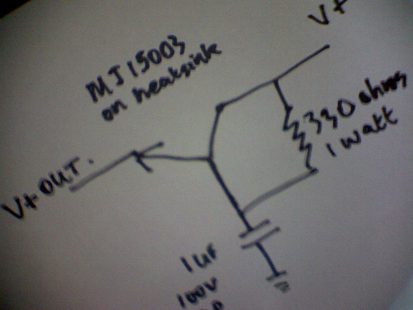

If you are concerned about noise a massive subject of its own, an emitter follower transistor power supply will greatly assist. On a heatsink arrange the collector of a MJ15003 as V+ input place a resistor of 330 ohms from the collector to the base a capacitor of 1 uf to ground and supply your amp from the emitter. This should make your amp silent in terms of noise. Diagram to follow
emitter follower transistor assisting noise reduction

any technical what they are named ? The amp V+ just need to pass through the emitter follower transistor circuit ? and other as original ? can briefly explain how it reduce the noise and how it works ? (interested) What noise does it cancel off ?
You said need to have heatsink, how big the heat sink should be, or how hot will it be ? Does it necessary to be same heatsink as output device ? (some same temperature)
About the bridge grounding seems can return the noise too (possible return on another point), will try out all grounding after i done layout my board.
An emitter follower, also known as a common collector is an amplifier of current. It typically will drop 1 volt. It involves negative feedback between its collector and emitter terminals. It will reduce ripple, and extend the bandwidth of the supply.
The amount of heat is determined by the current that is applied to the base, in this example 10.9ma as you specify a 36 volt supply is fairly light. At this current it will be mildly warm. If you have room you can put it on the same heat sink as other transistors, remembering to isolate using TO3 mounting hardware. .
Why it will extend the bandwidth ? doesn't direct connect makes maximum bandwidth ?
I just notice that the picture you attached doesn't specified the terminal of transistor, could you tell me which is connected to V+, and which to capacitor. I assume the V+ out is emitter ?
Just to ask, should this be part of amplifier, or PSU ? (power Section)

Bandwidth improves because of the negative feedback, this implementation is very simple
but quite effective.
I am out with my calculations, too many things on today, the resistor value should be 2K2
which provides 16ma which is about right for a MJ15003. collector is the input which with a TO3 is its case, connect the 2K2 between there and the base and emitter is the output. For further help look up a TO3 case pin out.
Cheers / Chris
hm... So emitter is the V+ output, collector is the V+ input, then base it connected to ground through 1uF capacitor.
In the diagram, the resistor use is 330ohm, but you say 2k2 ?

Yes error in calculation of resistance 2K2 is 16ma on a 36 volt supply - use 2K2 which is good for an emitter follower using a mJ15003

When batteries are charging, they draw more current from the AC supply, which can produce noise. The emitter follower transistor should make your amp silent. 2K2 is Red Red Red for a carbon 3 band 1w resistor.Remember to insulate base emitter and collector away from the metal of the heat sink. The 1uf can be a film type cap like a MKT, or if funds are tight use an electrolytic observing polarity + to the base, negative to ground and use a cap with sufficient voltage. 100v is recommended as its ESR surge rating is an important parameter, but if 100v isn't available use 63v.

i have alot of spare 2k2 resistor of 0.5W (about 7), can we use it ? (4, 2 parallel, 2 series)
Also have 2.7k 0.5W(40+) too, but mostly not used here.
Will try to get the best material available, since its not much thing and do best job.
Does this setting (2k2 ohm,etc) and component are available for any voltage item ?
Safety ground is needed, power across the 2K2 is Volts x Amps ie 36x.016 = .576 just above half a watt, so with the values you have use 4x 2k2 and make a circuit like this. Note we are adding another capacitor, as it will really reduce noise, we will locate it midway across the resistors. diagram to follow
