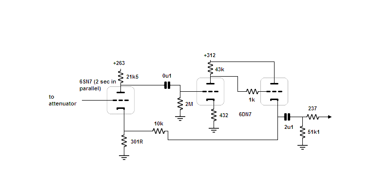

I just discoverd a near DC wobble that is obviously signal dependant, in the line section in one channel. This is on the output, obviously. Level sensitive in intensity. More output, more wobble.
Any quick guesses? PS or shorted cap?
This kind of problem in a tube circuit is awful, it's like chasing ghosts.
Sure, here it is. Now you owe ME one.;)
The article was a clone version, so here are some details that may or may not have been original:
The plate resistor of the first stage is made up of four 21k5 1W in series-parallel. The cathode follower/feedback resistor is made up of three 30k1 1W in parallel. The plate resistor for the second stage is made up of two 21k5 in series. And the output cap comprises two 1u0 in parallel, with a 0u1 paralleling them.

The Near DC is woofer pumping in bass transients, all level dependant. Higher level, more wobble. One channel only, The right. Yes the right is wobbling. Deservedly so. :p
Well, I've taken the unit out and subbed my moded counterpoint 3.0. THe counterpoint is now slaying the Magus C I have, which is virtually stock; not an unexpected outcome.
I will be tracing out the line stage circuit, to potentially find the source of the issue.
The most interesting thing to note, is the osc I had when the tip of the RCA on my cotter phono transformer touched the inner of the phono stage RCA, while the phono section was powered up. I think it was right channel only there, as well. What I heard, was the power supply box wobble, in terms of hum and rectification. It corresponed to the exact same osc frequency characteristics of the woofer wobble. ie, sub hz, 0.xHz range.

Ok. So far, the circuit is almost identical:
First Moore trick (or whomever) uncovered: The heater circuit.
My trick has always been to be absolutely sure that one of, if not the lowest potential ground is right at the heaters, and then utilize extremely low Z caps - right at the pin. Oscons, about 500uf's worth. (I've got a few hunnert spares) Whatever. Problem: If the grounding elsewhere is at fault, then you run into a hum issue.
The solution in this unit: the heater circuit DC supply cap ground point..is elevated above ground, by a 1k resistor. A damped elastic buffer. Float the entire noise, thus eliminating it. That's my off the cuff analysis, when I saw it. You guys will know better, or at least be able to contemplate such with more background in tube circuits than I have.
Just remember, when you go by electron flow ( ye olde: the ground is actually the source..that's why shielding works--otherwise it simply wouldn't do squat) it makes radical and obvious sense.
The ground in this unit travels through about 10 feet-15 feet of cable..yet..it is more (AC hum or otherwise) quiet than -anything- I have ever owned.
Full volume, on phono, with all other possible AC field devices removed from the immediate area, results in simple tube noise, with zero AC hum.
I forgot: Most importantly, the 2 meg resistor in the circuit supplied by Sy, does NOT go to ground. It goes on one end of that 1k resistor. It is that junction between the 2 meg and the 1k, that is the 'ground' point for the heater buffers. The noise, if any, is floated? sneaky sneaky. Oh yes, only the one single 1k resistor for the heater buffer circuit, for both channels and all four tubes.

IIRC the 2M resistor goes to a voltage divider across one of the 6.3V filament supplies to provide negative bias to the second voltage amplifier stage. No cathode bias. I think this was about -2V..
Check with Trombone and see whether or not he would be willing to share some of my Lumi mods with you. My docs are long gone..
