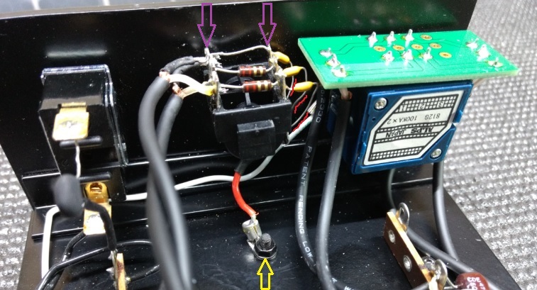

I would suggest adding at the headphone jack, an internal series resistor of 1R to 10R in each hot lead,
and a 0.01uF ceramic COG capacitor (with short leads) from each hot phone jack terminal to chassis ground
(not to the phone jack common). Also add a similar capacitor from the jack common to chassis ground.
If the strongest pickup is from the headphone cable, as seems to be the case from your earlier description,
this could help.

Are you aware the phone jack you used is "switching", the two sides are NOT the same? Turn it over and look what touches what. Or at least jumper the two "Common" lugs together. (Since you apparently do have working hot terminals.)

Thanks for all the helpful suggestions. I ordered some parts to give @rayma 's suggested fix a try. Now I wait.
@PRR I impressed with your noticing that I had the headphone jack wired incorrectly. I have since fixed that issue, but the error still shows in some of the photos.

I made some modifications to the circuit this weekend.
Thanks to those of you that suggested these fixes for my RFI problem.
I won't know if the changes will be effective until I get back to the office tomorrow, but I am hopeful, and the circuit still sounds great.
I added the 10ohm resistors and .01uF caps at the output. As far as I gather, this is a low pass filter to keep the RFI from entering the circuit via output.
I also took the time to Dremel off the powder coating below the input jacks. I tested the amp after reinstalling without the isolation washers. It had a hum. I think, probably, because the back plate and top plate(chassis ground) are not electricaly connected.
So, I put the isolation washers back on the inputs, and ran another ground to the common chassis ground.
I also changed the output caps, mostly because I prefer the Elna audio caps to the common Nichicon ones. I also swapped the input film caps for C0G/NP0 types.

I don't think the heatsinks are connected to the chassis electrically either. Since they are just super glued in, I bet I can heat up the connection for removal, add connect them to chassis too.
Definitely.
I do think the ferrite beads would be effective. But let's sort out a couple things first.
I don't remember the pinout of that brand of headphone jack. Is the right row (under the purple arrow to the right) just being used as a tie-point? And is that red wire going to the eye terminal (yellow arrow) the one providing the ground for the 0,01 uF?
It looks like the resistor and capacitor might be connected in series. Better effect would result wiring the capacitor in shunt (parallel with the capacitance of the shielded cable) and the resistor in series. I know one of the wise contributors earlier advised shunting the capacitors to the chassis nearby, but I'd like to suggest one additional step. Put a larger value, maybe 0,1 uF (ceramic or other high-frequency type) from the jack ground to the chassis (assuming the jack ground is NOT connected to the chassis). Then place the two 0,01's directly across the cable to its ground. The resistor (with the ferrite bead on it, if placed) then connects that node to the headphone signal.
Then a couple general things:
- Solder is for the electrical connection; the mechanical should be made first. Your soldering looks first-rate but it would go faster and easier with little hooks in the wire ends. See Construction Tips, or Best Practices in one of the ARRL Handbooks or some such.
- Always leave what the books call a 'service loop'. The way you have the 2,2 ohm resistors across the jack may seem reasonable and an efficient use of space, but it greatly aggravates any changes that might need to be made. Bend the resistor leads in a short horseshoe shape (you'll usually need to cut off almost half of the lead), then form the hook in the end to secure it mechanically to the terminal.
- High frequencies require shorter leads (than the red wire and long capacitor leads to chassis ground). When you have a 100 MHz, multi-kilowatt source a block away, it sees any 5 to 8 cm wire length as a coil! It may only be a few tens of nano-Henry but that's enough to allow a few microvolts of signal, which will be audible in a headphone amp.
Now for your points (post #38).
To the second -- please don't do that. It won't help.
Grounding the heat sinks won't help the incoming RFI problem, but it is a good idea. Then the top plate can help with the heat dissipation, too. Also, as you consider using glue in the future, keep two things in mind -- the thermal cycling will tend to loosen glue (especially a 'rigid' formulation like super glue), and what might get shorted when that bit of gear breaks loose.

Oh, and an inside star lockwasher, and some ThreadLocker, would be great under that grounding screw terminal.
And, oh - oh, almost forgot -- similar treatment may be applied to the power inlet jack, too.
