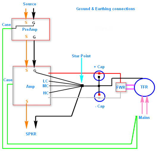

As requested, see my screenie
True ground Only exists @ the Source ! This is where the signal/s originate.
My observations based on Actual sound system installations, & with regard to grounding each & every piece of equipments metal case Directly to earth via the Mains plug. Plus ONLY grounding @ the source, or the first available point nearest to it/them, ie the PreAmp/Mixer. And engaging All ground lift/s provided, except the source.
If the shield is connected to the chassis at both ends, it WILL create an earth loop = Not good !
Some equipment with a metal case has NO mains Earth connection, & is supplied with a 2 wire mains lead. If possible, it's beneficial to change it to 3 wire lead & earth the case, & then ALSO remove Any/All internal ground connection/s to the case.
In metal rack mounted Pro equipment, unless isolating grommets are used under the screws, an earth loop WILL be created = Not good ! Most "Pro" installs i've seen over the years, are incorrectly grounded, in more ways than one !

Zero, please post a pic of how you would earth your own amp.
I found an article on here which people might like to peruse etc. It incorporates some of my thoughts & findings.

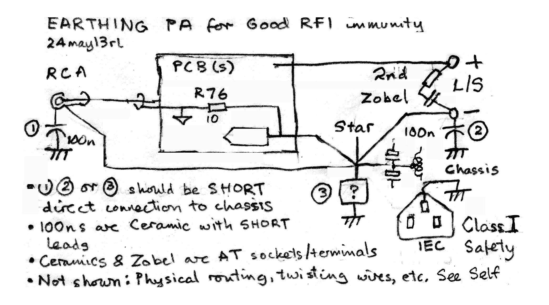

This appears to be a response to my recommended earthing scheme for Toni's excellent amp in #297 of 2stageef-high-performance-class-ab-power-amp-200w8r-400w4r I enclose the pic for convenience.
I would be pleased to hear of possible problems if the amp is earthed via (3) in the pic. ie [?] is a direct short to Chassis. This is how I have earthed Power Amps or other physically big items with many In/Outs like a mixer.
It was really about RFI design. The main point is that ALL leads that pierce the Chassis MUST either be connected to it directly or via 100n Ceramic caps with the SHORTEST POSSIBLE LEADS right AT the connector/terminal.
It is what I remember of an Engineering Memo I wrote about designing stuff to meet 'both' Class I & Class II safety standards Internationally and the implications re Hum Loops etc. Even today, there are some markets which don't have a 3rd earthing pin on mains and for these, Class II 'Double Insulated' is appropriate.
With care, electronic stuff can be designed to be easily converted for each of these markets To do so as other than the original manufacturer is illegal in many countries.
From a Hum Loop perspective, Class II 'Double Insulation' is the easiest. This seems to be Zero's favoured solution. But I would be very wary of any big Class II electrical device eg Power Amps.
For these, Class I 'Earthed Chassis' is appropriate. If you don't do this, you sometimes get little shocks from the chassis and this was common with evil Yankee gear of the 70's & 80's used in da old country.
If you don't mind this, Zero's method will 'work' but you'd better have those 100n ceramics at ALL input sockets.
I'll take a stand on having 'one and only one' point of the circuit in ANY box connected to Chassis. At Calrec, this was religiously done. Part of Final Test on a big mixing desk was to remove this Chassis connection (a big Cu strap like a car battery lead) and check that no other connection to Chassis existed.
I invite you to dream up evil cases where the scheme I show in the pic will give problems with a Power Amp. (3) the Star Point direct to Chassis.
_______________
There are actually 2 cases. One is Pro audio where connections are balanced. This is well studied. Self, Jensen, Whitlock, Rod Elliot, Muncy and the zillion papers in JAES etc are appropriate. Sadly there are still 'pro' makers who don't understand this properly which is why we still have the 'pin 1 problem'.
For this 'pro' case, Direct connection to Chassis of the Shield at the SEND end and connection of the shield to to Chassis via 100n Ceramics with SHORT LEADS at the receive end is agreed by the above authorities and works well in 'real life' too.
I don't mean the shield is not connected to the circuit at the receiver. It MUST do this for loadsa reasons including P48V power. I mean you can connect the shield to Chassis via the cap bla bla if you don't connect it directly to Chassis. But you MUST make one or the other connection to Chassis at both ends of the cable.
_______________
For evil, domestic RCA connections, things are less clear. Self, Rod Elliot etc pontificate slightly on this but the permutations are far greater.
If you have Balanced Inputs, you can avoid may problems with evil unbalanced RCA sources.
Only certain Balanced Outputs give good results with evil RCA inputs. Some give VERY poor results indeed.
For stuff like a domestic Power Amp with RCA inputs, again I invite you to dream up evil situations where my scheme will give problems.

The issue is leakage currents including those from caps connected to transformers in bits that are stuck into people.
_______________
_______________

Leach discusses this and suggests the input socket Earthing as an alternative that may be better. He also suggests, no insists, that there must be a low inductance connection between Signal ground and Power Ground in the amplifier circuit and suggests a 10r for this.
That same 10r appears in Kgr's version.
Hi Andrew,Leach discusses this and suggests the input socket Earthing as an alternative that may be better. He also suggests, no insists, that there must be a low inductance connection between Signal ground and Power Ground in the amplifier circuit and suggests a 10r for this.
earthing RCA input socket (via C or R||C) might be the best compromise also in my experience.
Still, I'm wondering whether there are some (tricky?) measurement techniques one can apply in order to not only depend on listening tests when high-frequency equipment is not available.

I use the low value resistor like Leach does and am getting outstanding results for RFI noise and hum/harmonics.
My pre (X-Altra Mini) and power amp (nx-Amp) chassis are solidly earthed via the 3 wire mains cable. On the pre, the star ground connects directly to the chassis at one point only. In the power amp, the PSU star connection goes to a ground lifter (20A bridge rectifier with 22 Ohm 5W in parallel) - so the star ground in the power amp is floating +-1.4V wrt the chassis with is earthed. The power amp electronics only make the connection to the chassis through the ground lifter and nothing else.
The idea of the 10 Ohm resistor (I am using 15 Ohms) between the front end power amp circuitry and the rest of the circuit is to ensure that the earthing path is forced through the mains earth, and does not take the ground sheath in the audio cable. Works very well indeed.

Your RFI screenie might be good for RFI immunity, but i'm wondering if it's also best for hum/GL immunity ?
