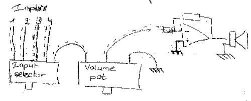

My Gainclone is 90% finished now 🙂
I build this amp as an "integrated" amp and not a power amp: there are multiple inputs (4), an input selector and a volume pot
The only thing I still don't know how to do, is the grounding of the inputs.
All the inputs use a shielded cable, and that causes me some trouble...
The inputs go to the rotatory selector switch, then, the output of this one goes to the volume pot, and the output of the pot goes to the input resistance of the chip.
Now: where do I connect the shields? 😕
Edit: the dotted lines on the (poor) drawing represents the shield

Hi Bricolo,
If you are not switching the grounds as well (which I presume you are not) then just join all the input grounds with one wire and run that to the signal star ground point.

That was one solution I was thinking about.
But when you look at the return paths, it doesn't look good 🙁

Hi Bricolo,
do you use a true dual-mono configuration or both channels share a single power supply?

There's 1 transformer, 1 dual diode bridge, and 1 case for both channels
but there's a "local" star ground for each channel (the star poind is where the pos and neg caps join)

Hi Bricolo,
From the bottom of my inexperience I'll try to share my doubts with you... 😕 😕
I think there are two possible situations. Keep in mind that the cables coming from the sources to your amp have almost certainly the grounds connected together at the origin.
1. If the amp is truly dual-mono (two separate PS, two separate ground stars), I second Nuuk's opinion that the best way would be to keep the grounds separate and to use a 2Pole-4Toggle switch in order to switching both signal and grounds.
This should be beneficial for avoid large-scale ground loops among different source components. Otherwise, one could connect the input grounds with the shortest possible wire and use a 1Pole-4Toggle switch. Again, no ground loops inside the amp.
2. If the amp is not dual mono (your configuration), I suspect you can only choose how big to make the ground loop: if you keep the input grounds separate, the loop will start at the source and end at the center of the (global) ground star. If you instead connect the grounds of the input jacks you'll make a smaller loop, from the jacks to the (global) ground star. Maybe this solution is less bad. Another thing you could do is to switch both signal and ground, but connecting the left and right input grounds right after switch. Once connected the grounds, you could use a single wire to bring the input ground to the amp; so no loop, but a weird return path for one channel.

Hi Tom,
Ehm... I really didn't think about balanced connections... 🙂 or, at least, this wasn't my intention... 😱
What I tried to describe (to "explain" seems a bit too strong to me) was my idea about potential ground loops involving a non-dual-mono amp. Apparently, very few people are afraid of that, so maybe the problem is not so terrible.
