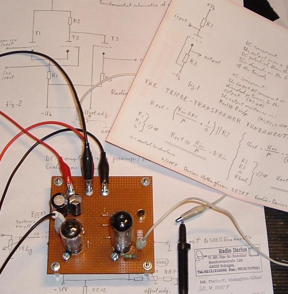

7/10 The circuit you attached is a very standard Long tail Pair, with feedback. What is your question?

Maybe it is Broskies answer in my circuit ?! 😀 😉
