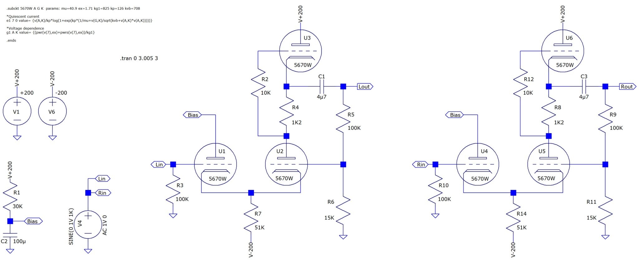

So I have done the LTspice simulation and understand much better as follows:
Describing the Left channel, U1 and U2 are a "Long Tailed Pair" the input signal at the Grid of U1 is balanced with the feedback signal at the Grid of U2. The classic Opamp differential input. This works well if the current passing from U1 Anode to Cathode is reasonably equal to the current passing from U2 Anode to Cathode. The only way input signal gets from U1 to U2 and therefore U3 is by the current balancing in R7. Can also think of U1 and U2 as "Cathode Followers" U1 follows the input and U2 follows the feedback.
I don't see a "Grounded Base" configuration anywhere here.
Also being honest I'm not sure what U3 is doing but I think its another "Cathode Follower" and you can see it providing more output current.
The Analog Metric circuit seemed to be unbalanced when simulated, I had to reduce the value of R4 from 3K to 1K2 and I reduced the value of R6 from 20K to 15K. After doing this the "Long Tailed Pair" balanced with about 2mA passing through U1 and about 2mA passing through U2. So the current through R7 is about 4mA and the voltage across R7 is about 200 volts so it will dissipate nearly 1 Watt and get warm.
The voltage at the Plate of U1 should be roughly equal to the voltage at the Plate of U2 and should be somewhere not much lower than 90 Volts. The Left and Right channels share the same bias resistor, the 30K R1, this is a bit of a pain because balance in one channel affects balance in the other, it made the simulation more difficult (have to show both Left and Right channels).
The voltage gain from input to output is about x5 to x6. Total Harmonic Distortion for the values shown is better than -60dB but if current is drawn from the output (more than micro Amps) the THD will get worse.
As a general comment the voltage across any of the tubes U1 U2 U3 U4 U5 U6 is never more than 100 volts and the current through any of them is never much more than 2mA so they are not working at the most linear part of their characteristic curves, more voltage more current would be better. I was surprised when you consider that the total HT voltage is about 400 Volts from the positive rail to the negative rail!
@nilsW For your Analog Metric circuit you could consider reducing R7 and R8 to 1K2 and reducing R11 and R12 to 15K.
Do I have to change R4, R6, R7, R8,R11 and R12, or should I leave R4 and R6 unchanged?
I will also check the capacitors
@nilsW
We have two schematics the LTspice simulation and the Analog Metric - Grounded Grid Pre-Amplifier Circuit that you posted. LTspice is difficult about changing part numbers so the part numbers are not the same.
Trying to explain:
For the LTspice circuit I reduced R4 and R8 from 3K to 1K2. I also reduced R6 and R11 from 20K to 15K
For your Analog Metric - Grounded Grid Pre-Amplifier Circuit (the real hardware) - you could consider reducing R7 and R8 to 1K2 and reducing R11 and R12 to 15K.
Study both circuits (your circuit and my simulation circuit) making sure you know which resistors, its up to you, there might be a small improvement ??
But be careful any smoke from the PCB is usually followed by tears and regrets !!
So on your actual hardware PCB you would be changing: R7 to 1K2 and R11 to 15K, (left channel) also R8 to 1K2 and R12 to 15K (right channel).
You must change both Left and Right channels at the same time because the two channels share the 30K 2W bias resistor (R15 on your circuit) changing one channel only will unbalance things. Also for same reason a faulty Left Channel will make the Right Channel faulty and vice versa.

Wow that's harsh, for my part I can see what @6A3sUMMER is saying, I can see what @rayma is saying and I can see what you are saying.
Isn't it obvious from the circuit that I drew in post #44 that the following are all true:
- U1 U2 and also U4 U5 are classic Long Tail Pairs
- U1 Cathode follows U1 Grid signal
- U2 Cathode follows U2 Grid feedback signal
- If R6 were 0 Ohms or R5 were open circuit then U2 would be Grounded Grid
So we are all right yes, I feel better now lol.
Reactions: 6A3sUMMER
U2 cathode is tied to U1 cathode so it also follows U1 grid. What U2 is really doing is subtracting the NFB from the input.
Yes, to describe more fully, U1 Grid can pull the connected Cathode up OR U2 Grid can pull the connected Cathode up. Neither U1 Grid or U2 Grid can pull the connected Cathode down.
Now the current flowing through the connected Cathodes together and through R7 to the V-200 rail is equal to the current entering U1 Anode PLUS the current entering U2 Anode hence you have a "current balance"
Now if U1 Grid is pulling up harder than U2 Grid more current will come from U1 Anode and less current will come from U2 Anode and vice versa. That's why it is important for low distortion that when there is no input signal (and therefore no feedback voltage) then U1 Anode current should be equal to U2 Anode current.
The two valves/tubes are balancing small currents.
