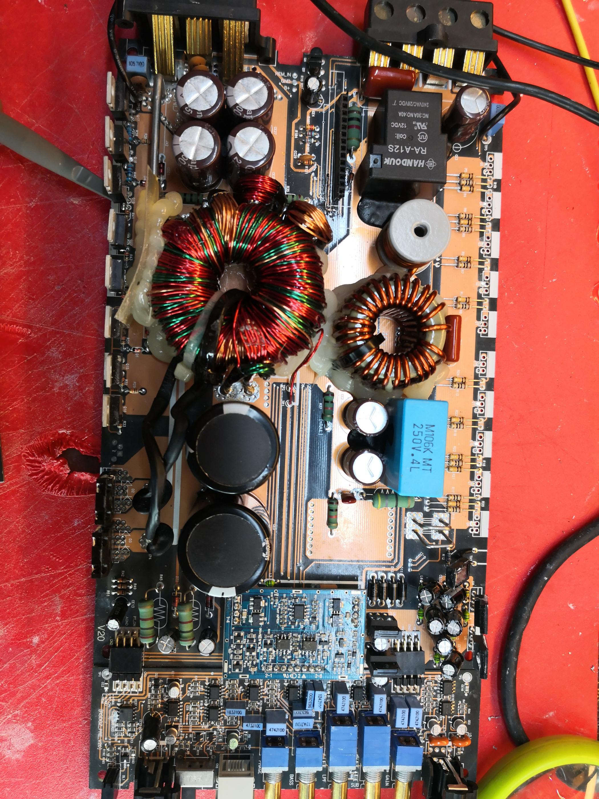

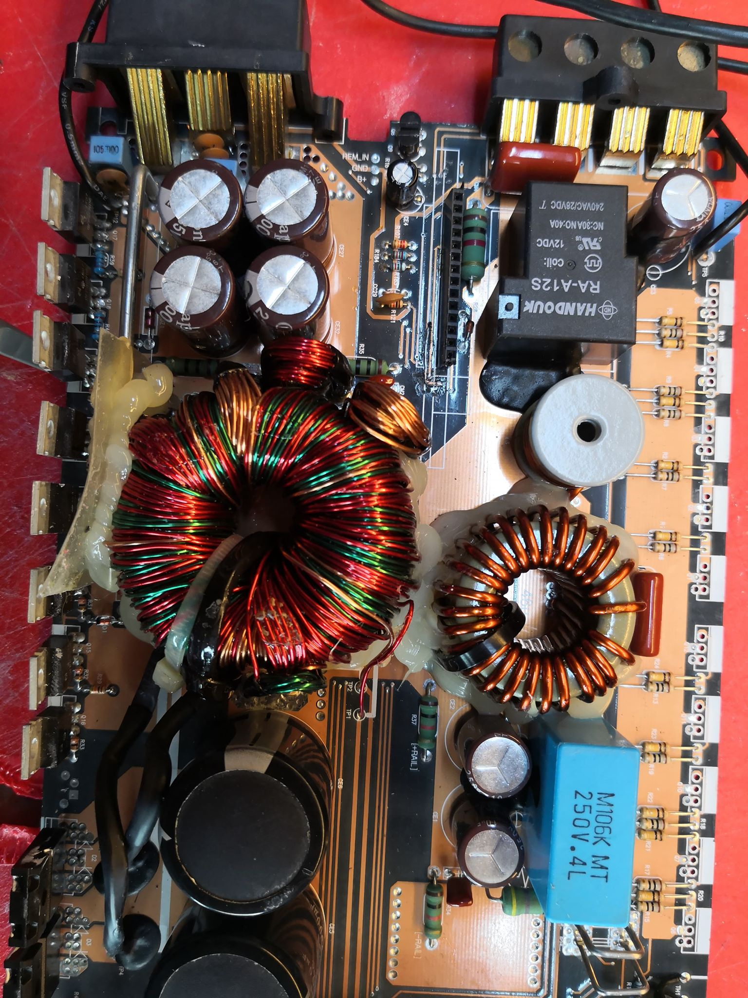

No one knows everything about every amp ever made. There are a lot of clones. Posting good quality photos of the main and any driver boards will significantly increase the chance of getting help.

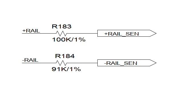

i just have this piece from schematic, which is similar to the one I have. ...
on pin 9 and 10, has a resistor going from each rail to the psu driver board.
i just wonder if i has something with regulation or just checking the rail.
I believe it was some 1.6volt plus minus on pin 9 and 10

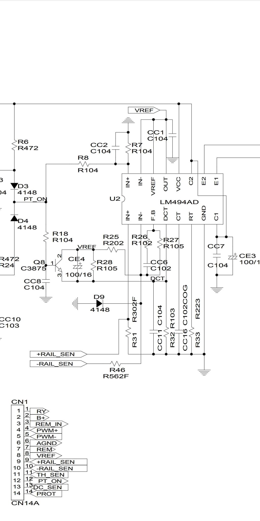

Is that part of the diagram all you have or simply all you're you're willing to post?
The amps using this output type are typically not regulated. Amps with regulated rails typically seen the feedback to one of the error-amps on the driver IC, not to terminals 9 and 10.
Hi Perry, what the owner of the thread meant is that on pins 9 and 10 of the driver board there are 2 resistors (on the side of the amplifier board) that go to the rails, in the schematic, pins 9 and 10, are respectively - / + rail sense and I can guarantee that they are used to make the regulation.Is that part of the diagram all you have or simply all you're you're willing to post?
In the past I have repaired an amplifier that had the same driver board in the power supply and also had the 2 small resistors on the "+/- rail sense" that went respectively to + and - rail of the amplifier and that was regulated.
Also, if you notice well, +/- rail sense, they go to one of the two error amplifiers, so it makes sense.

So what's the regulated voltage?
Where is it supposed to stop as the B+ is increased?
Can you post the rest of the diagram?

Maybe you can but I can't help without knowing more. I can make assumptions but that can provide no definitive answers. If the OP isn't willing to post the diagram and no one else will, I can do no more. The overall amp seems to be common but the regulation in this type of amp is new to me.
