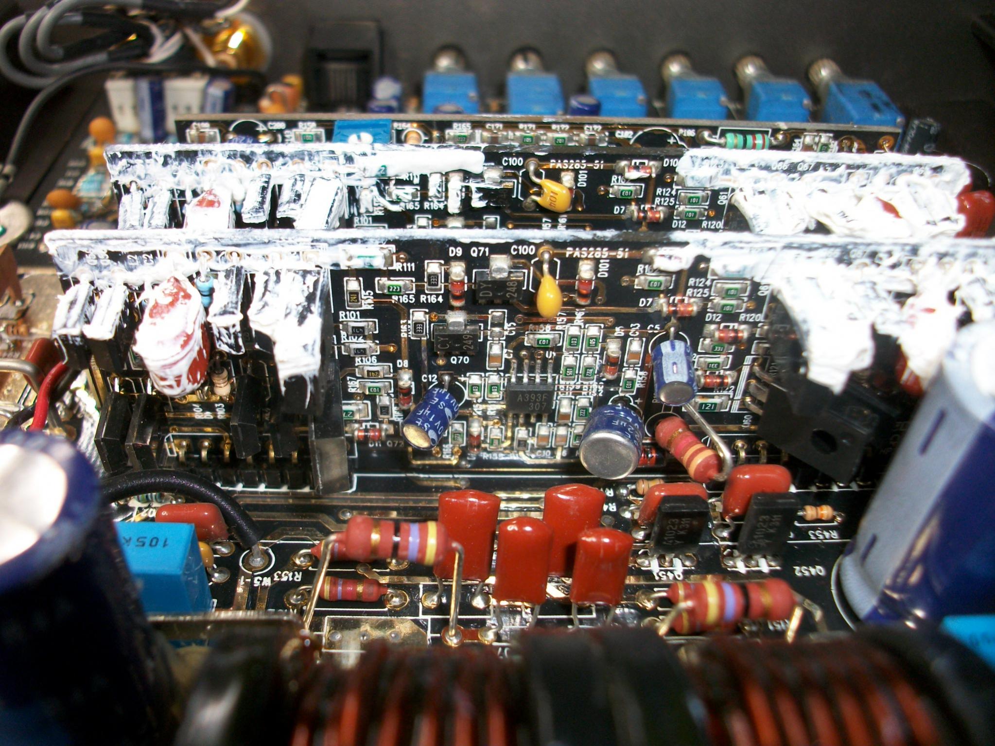

Got this amp with a weird problem.
While testing with a 2 ohm load, everything looks ok until i pass 100A
then, there is an intermittent noise, that i believe comes from the output
chokes.
Sine wave on the scope looks ok and when this noise comes on, i see a kind of
harmonic swinging on top of the 100Hz signal.
This is a generic type 1 class D amp.

i tried to get a photo but now the problem has changed
when it draws a bit over 70-75A, it goes into protect, shutting down my
power supply.
The very first time i tested this amp, it drew about 152A before making that
noise (output was 50VAC in a 2 ohm load)
I could never repeat that.
The noise started earlier, at around 100A,
and now, it does not make this noise and it just simply shut down.
When i cycle the power of my power supply, it starts the same all over again.

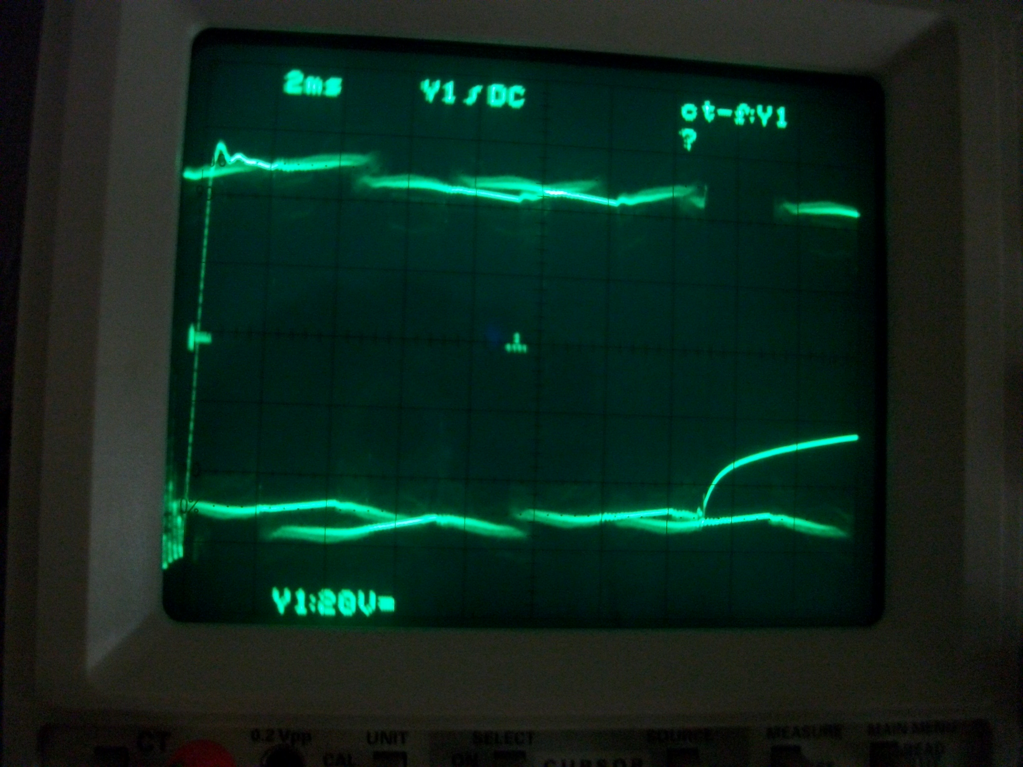

Look at the waveforms on the input side (non-audio side) of the 4 output filter inductors. When it starts to make the noise, do you see something strange on one of the inductors that isn't there on the other 3 inductors?
Set the scope to 2ms and whatever vertical amp setting it takes to make the waveform fill about 3/4 of the display.
i had to load the amp with a 4 ohm load, in order to see things easier.
None of the four inductors at the none audio side shows anything different
from the others.
things happen so fast, i could only get this photo out of many.

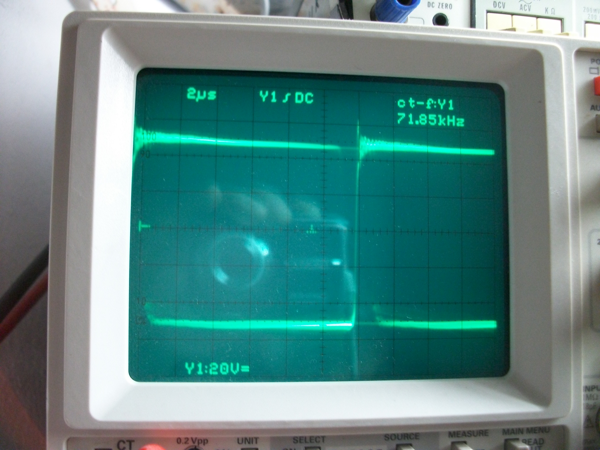

It is strange though, that this noise happens only when i probe one particular choke...
with the rest, everything seems fine. I leave the amp (and my load) to become cold again,
and i test over and over again.
