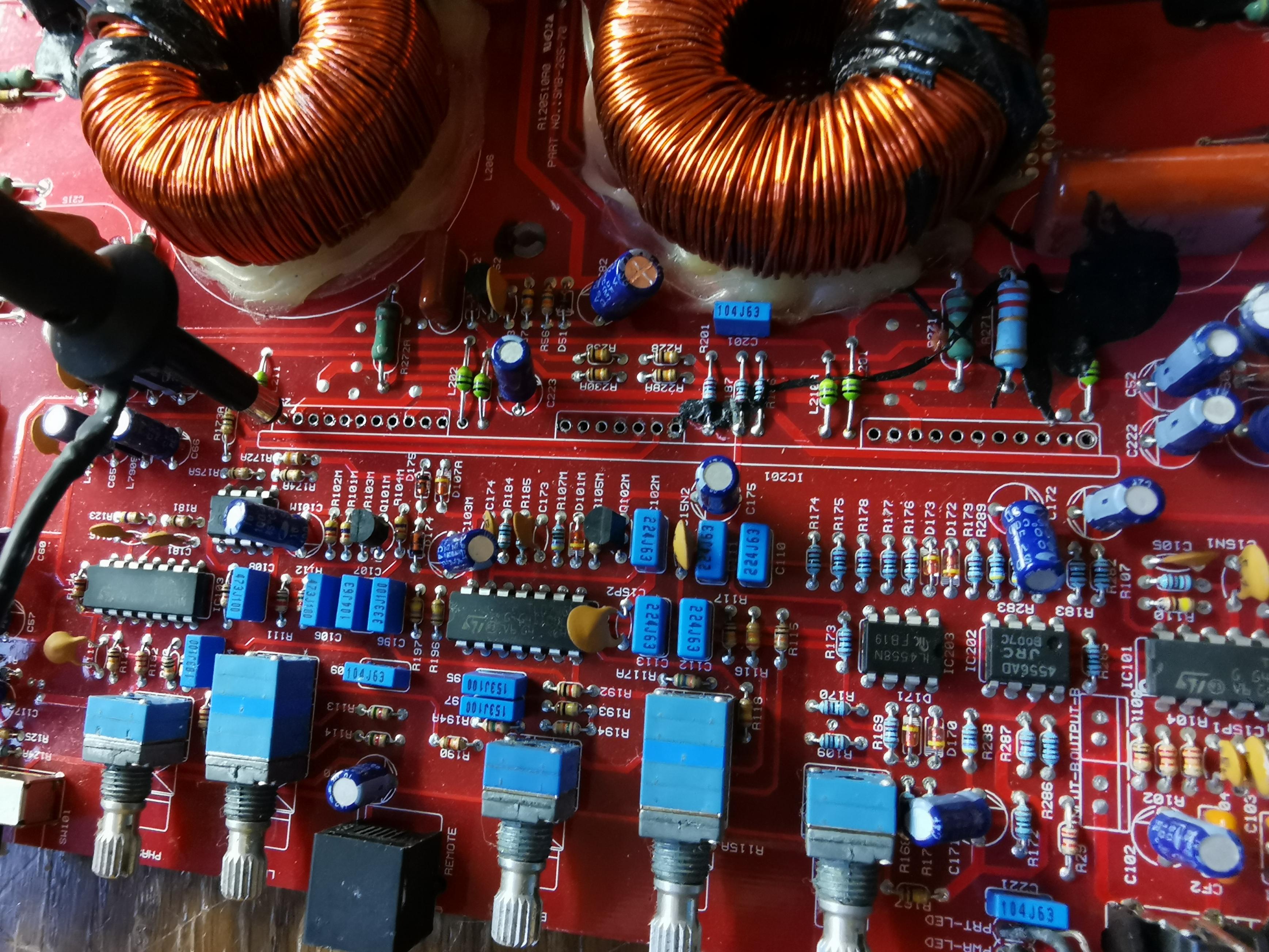

Check very well the VS resistors (4 x 1ohm or 2.2 or 4.7ohm) they can be phiscally ok, but not electrically.
Change them in all cases.
Check also all gate and pulldown resistors. Sometime some resistors can change their value (minimum change can be catastrophic when you apply the power.)

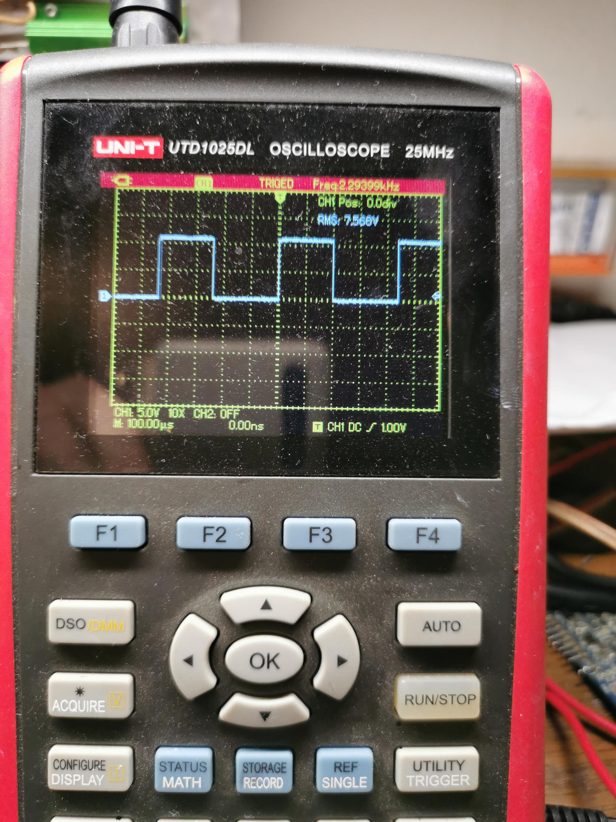

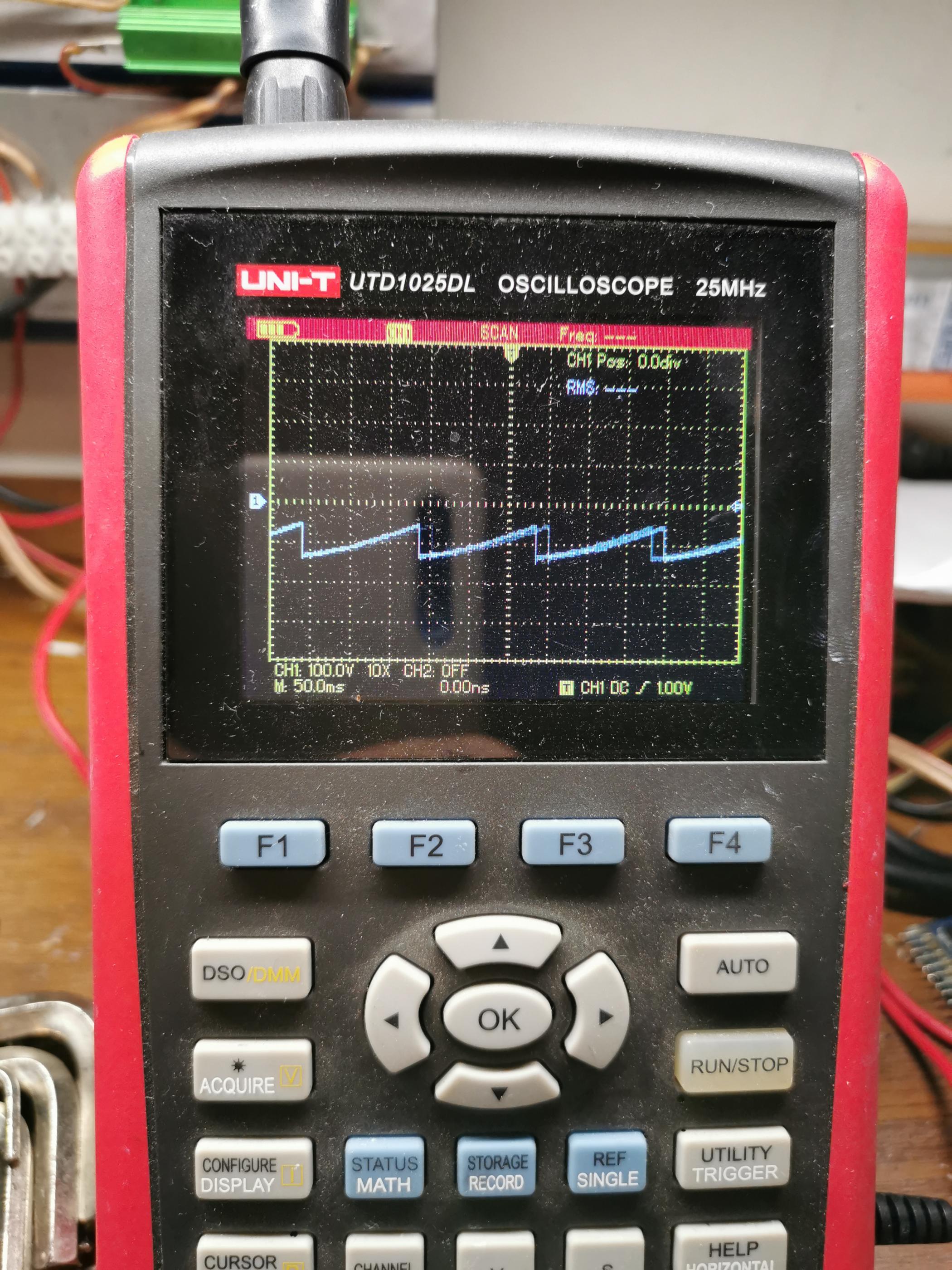

I dont monitored the temperature. I left it out of the heatsink, let it run for half a minute,everything looks fine, Amplitude was also ok. Put it back in the heatsink, checked, that there is no short. Applyed power, after the current draw goes down, when the IRS start swichting, directly the fets exploded.
From measurment, it seems, that the drivers still ok.
Scope is UNI-T UTD1025DL
Outside the heatsink, the fets stay cold. I tested with my finger... Maybe a intermittend problem.
Yes, i know that low voltage supply. I had a full amplitude at the drain. Like it should be.
Ok, i removed the mosfets. One fets per each bank is gone. So 4 pieces. One driver is damaged, the other 3 drivers still working. I have to order new drivers. I think also, that it could be the inductor or something intermittend....I dont know, if its worth to continue...

With low voltage you can use much more robust FETs to see if you can find the problem.
Just because it had rail-rail oscillation, that doesn't mean that the drive signal was good. A weak drive signal can make the FETs run hot, even though it's getting them to switch on and off.

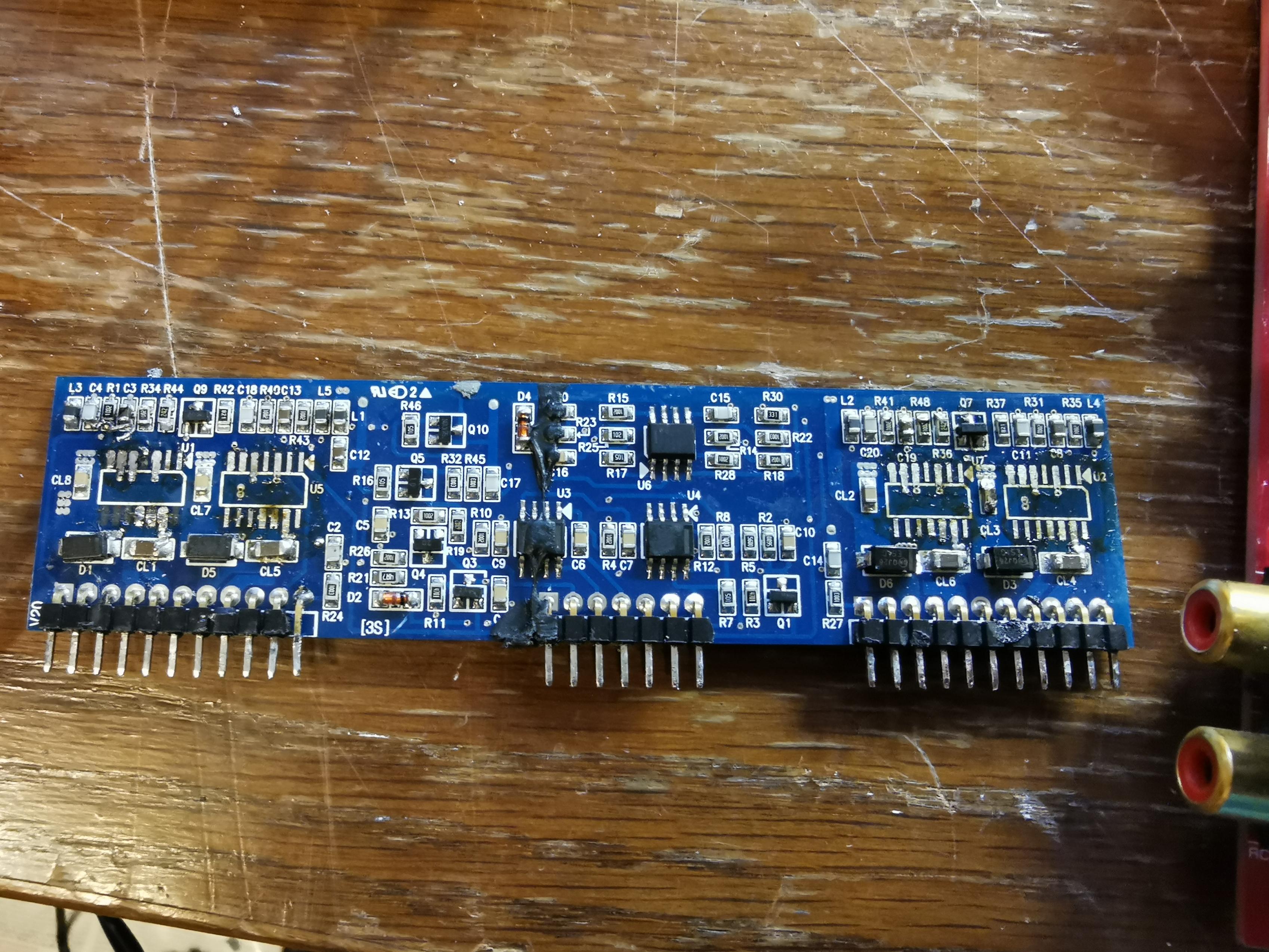

When only one 21844 fails, is it always the same one?
There are two diodes on the drive board, and the caps. Can you give me the correct value or better a link for mouser... I will order some parts.

The capacitors vary from 4.7uF to about 10uF. 5.6uF and 6.8uF are likely the most common.
The diodes have to be fast recovery and capable of easily withstanding the full rail-rail voltage. The ER1G is common.

Ok, and the small signal diodes on the drive board just standard?
