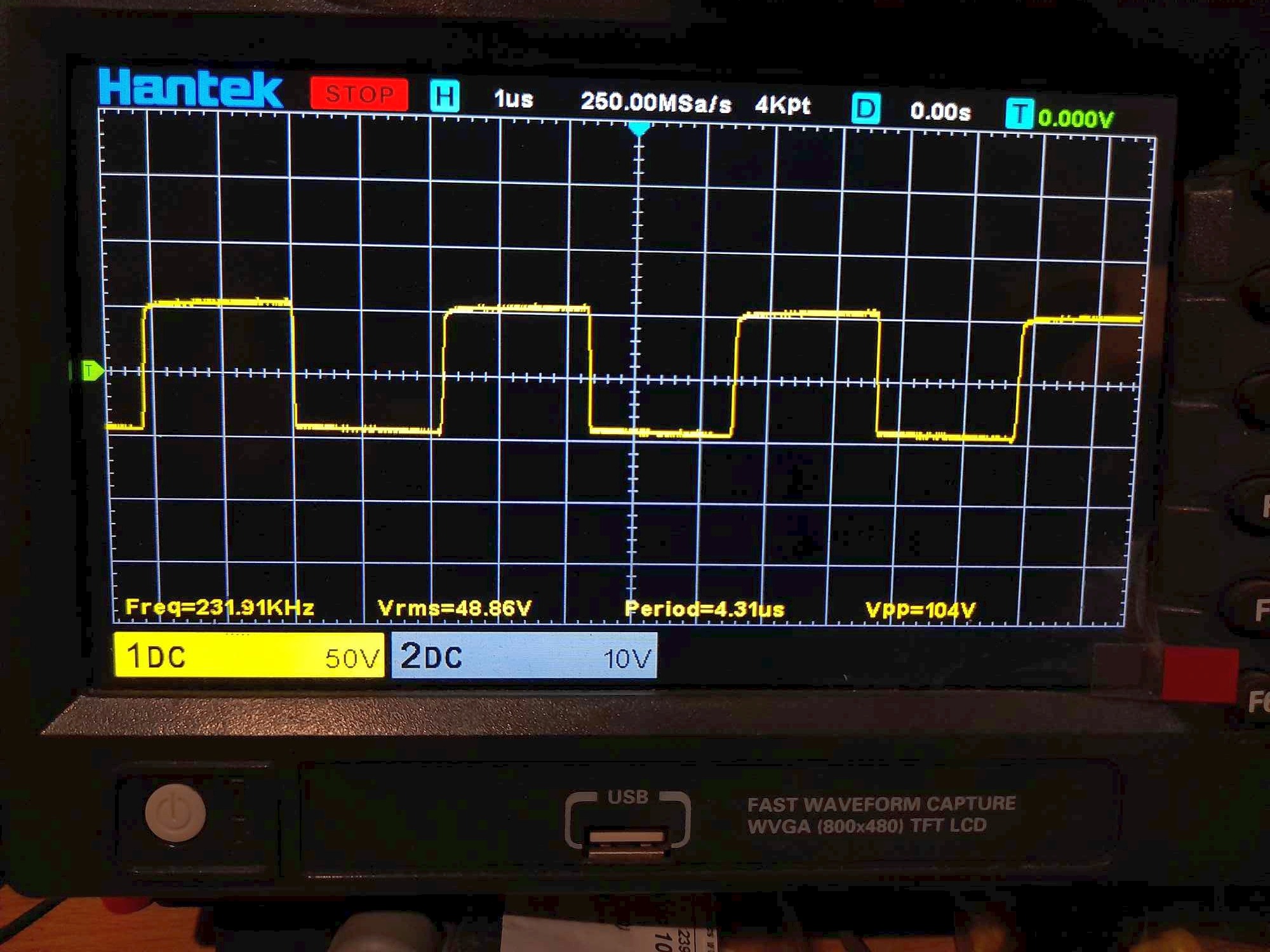

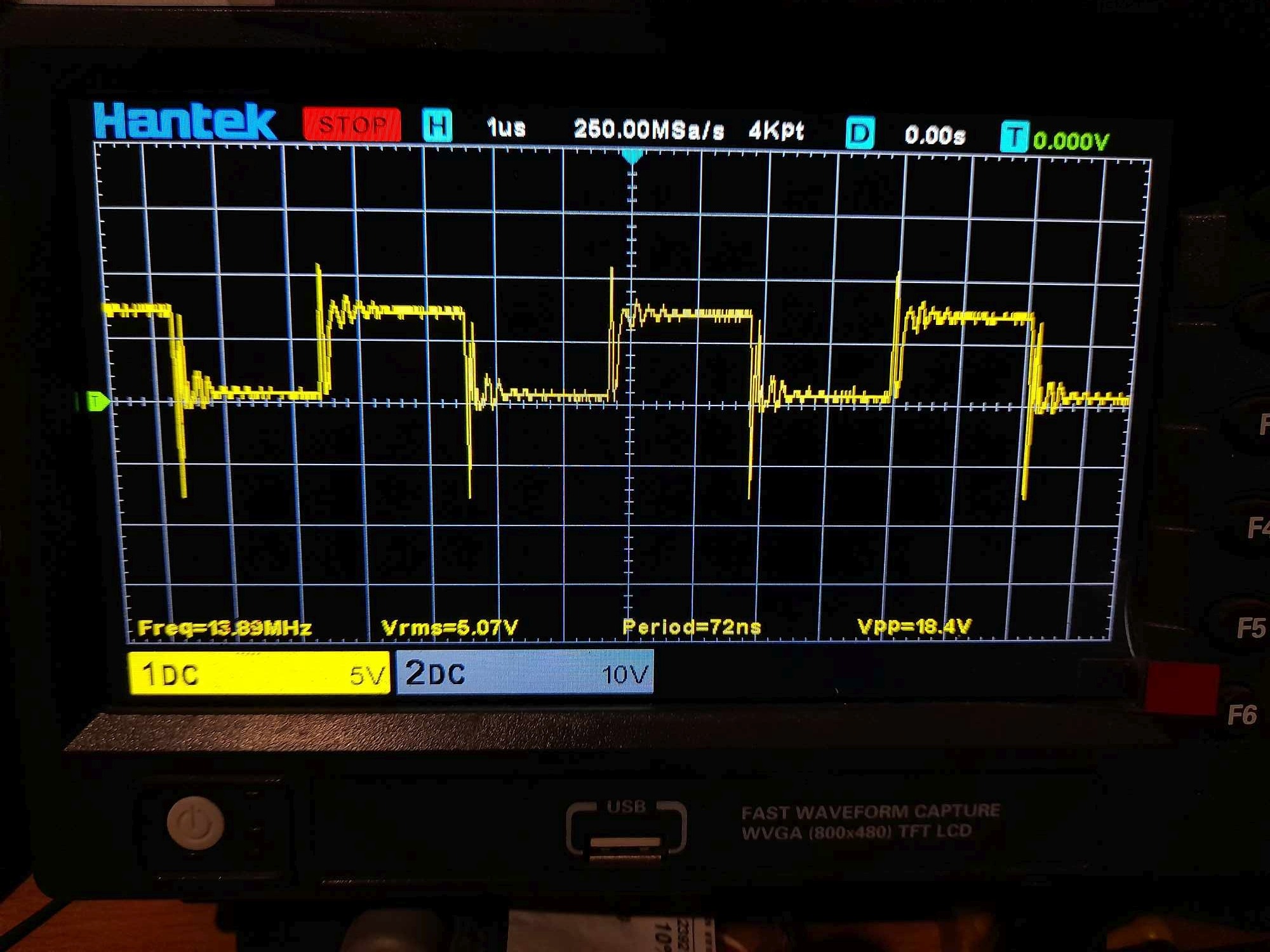

Can you measure the amplitude of the waveform on the high-side FETs (either a mains scope in differential mode or a handheld scope)?
Check all of the components in the 12v regulator. With a 15vZ, I'd expect more than 11v.
I don't know what to make of the waveforms. 8v of drive? I was expecting a waveform that was no more than 12vp-p. USe the scope in differential mode and measure source to gate (do not try this in normal mode).
Changed the D27 zener, the Q1A tip41c, the D40 fr104 diode, R77A and R78...I do have voltage now between 11v and 13v depending on the B+.

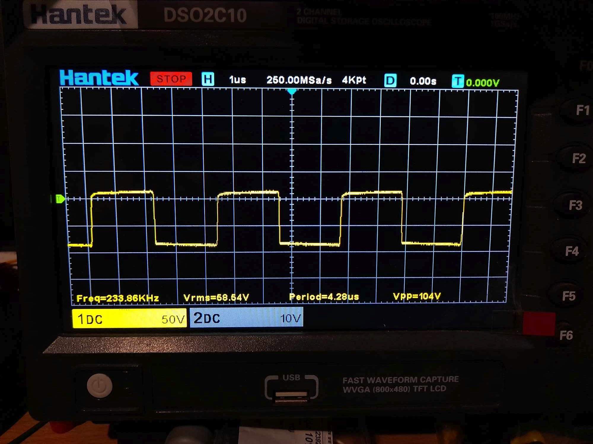

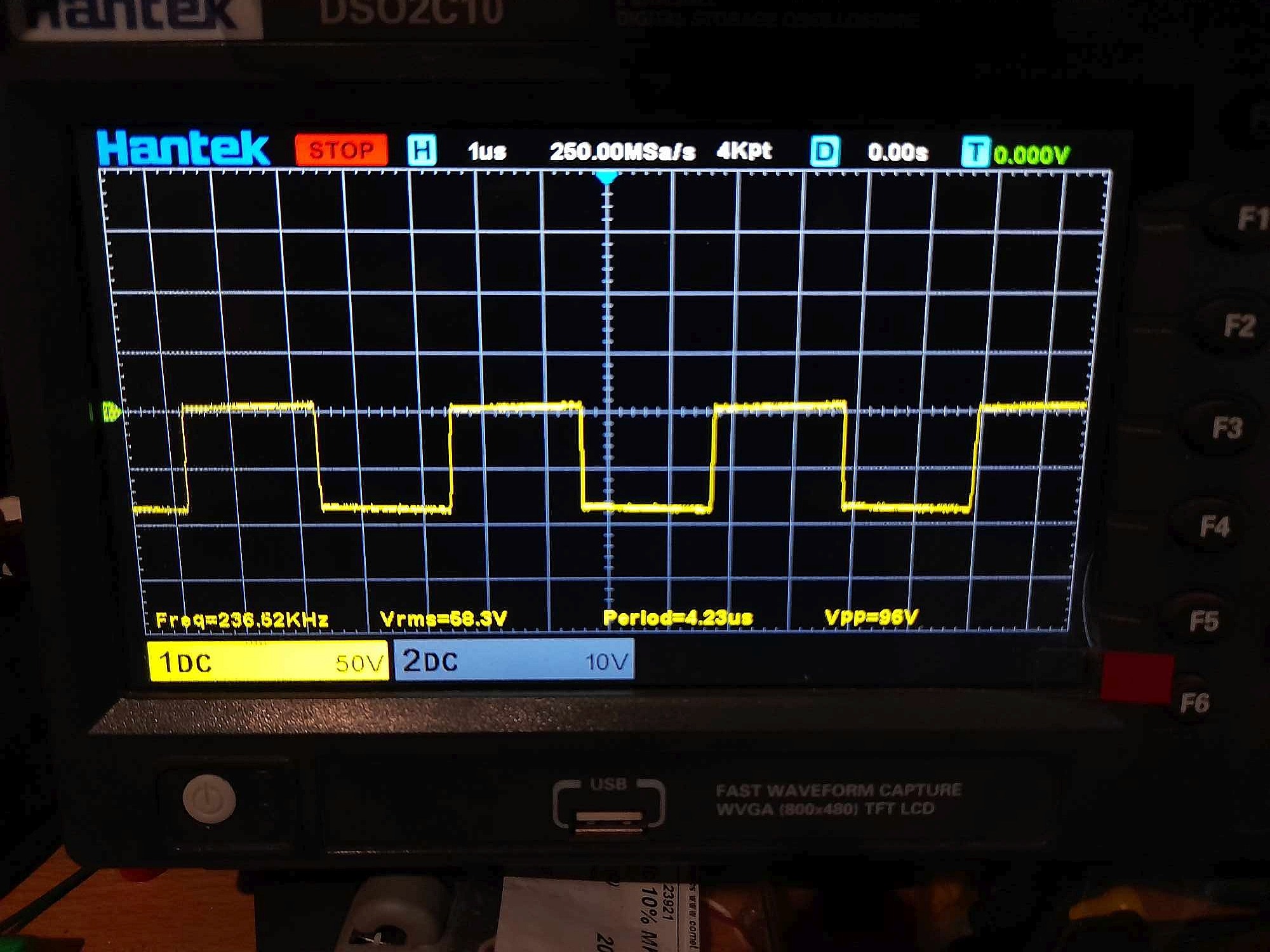

Same.... the top half sinewave gets clipped way to early. What've noticed is the point where it's starts to cutoff is rail voltage dependant . Increasing the b+, increases the rail, as my cut off point of the sinewave too. But even at 15v+ b+ it's still clipped.
Maybe this amp does not like any of these mosfets....i've have had in the past amps that won't work properly with anything except the fb31n20d or at least I could not make them.
