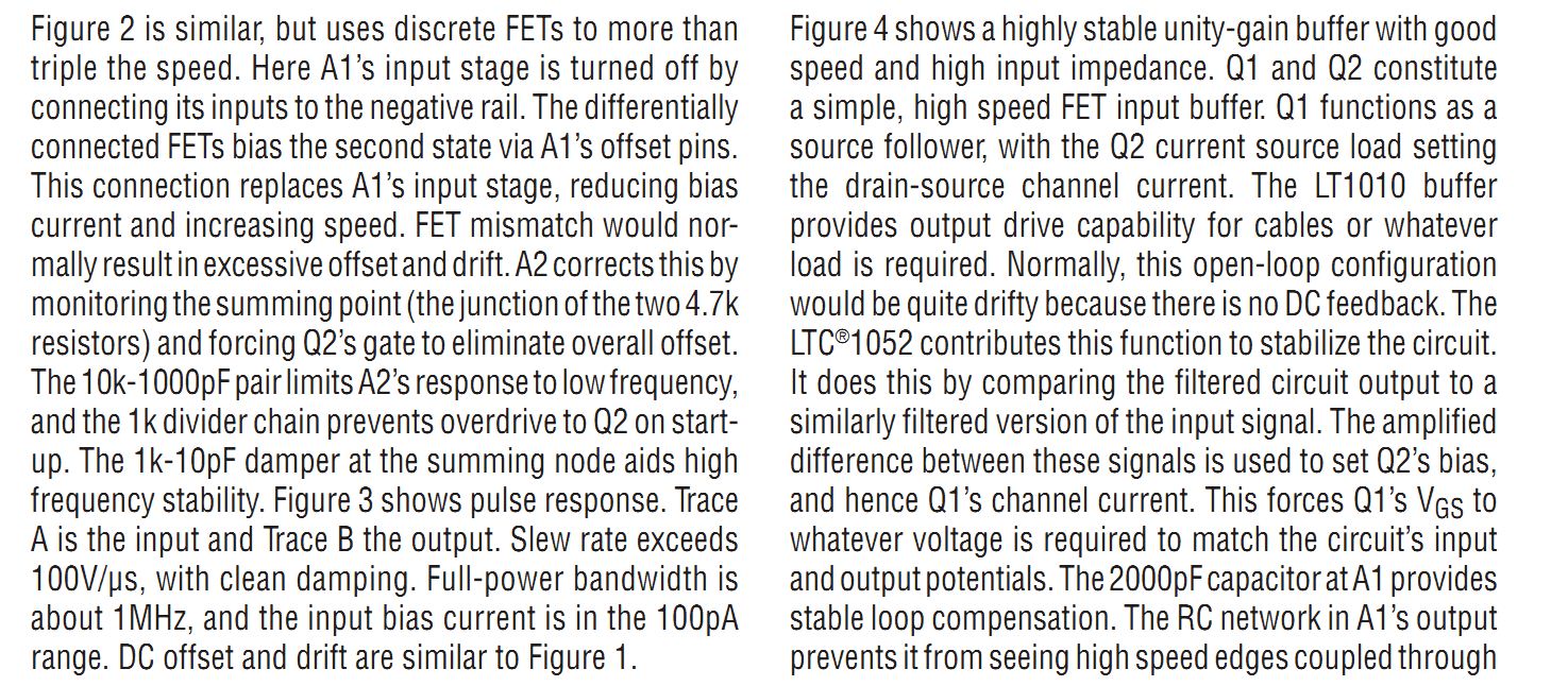

And here is the link for the full data sheet PDF http://cds.linear.com/docs/Application%20Note/an21f.pdf

I stand corrected. Clever way to use the opamps by controlling the offset pins...
Edit: Ah, you posted the appliction note in the mean time...
In simple terms it bypasses the internal bipolar differential stage allowing a precision (?) external input pair to be used, but retaining the gain and drive of the OpAmp.
