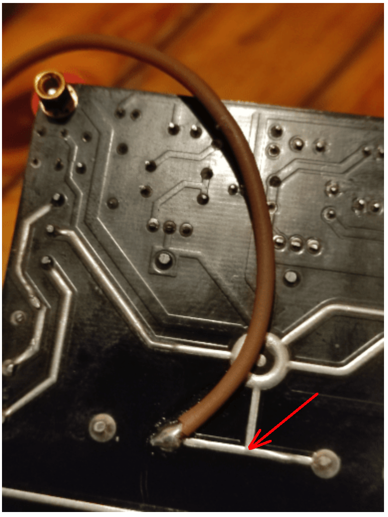

Ground related noise when trying to install LM3886 amp board into a case
