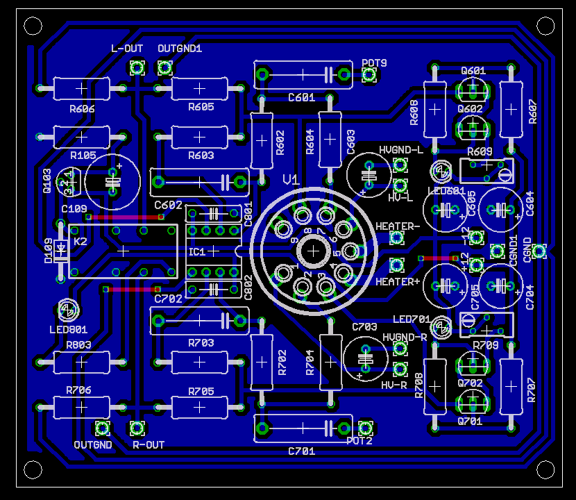

I quite frequently use both, starring for signal critical grounds, and a plane for power decoupling etc, (though I have never built designed anything with digital on it yet). Sometimes my GP has no connections to components on it at all, in which case it just serves to isolate tracks from each other, and save on etching fluid as I make my own boards. As for the added complexity, I don't mind, it forces me to think very closely about layout, which is a good thing.
See pic below for an example:
