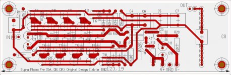

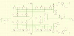

I am about to build up a phono pre based on the Elektor design from '82 (see schematic).

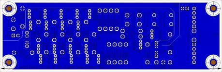

I designed a board and I am a little unsure about the layout of the ground plane. Attached is a ground plane layout that is separated into input and "power" ground. Another optiom would be a closed ground plane without separated areas.
Any recommendations would be appreciated.
Best regards, Daniel
