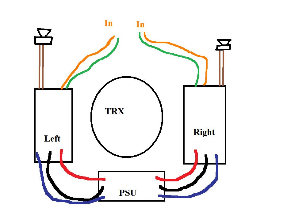

Is it a major job to lift the tranny out ? By just extending the wires it would help prove where the problem lies.
If you look at this drawing, each amp on it's own is fine. The problem comes when the inputs are joined together. Firstly by the grounds, but also by the center signal conductor. This occurs because the volume pot particularly at low levels "shorts" the center signal lead to ground.
Until they are joined the stray field from the transformer is not such a problem. When they are joined the field can then induce a current into the wiring -- it's like a "loop" around the tranny. This induced current causes the hum. Depending also on the resistance of any wires/PCB tracks etc this current also develops a volt drop along those wires. If the signal ground and feedback returns of the amp happen to be separated by some of this "resistance" then the amplifier will amplify that signal ( the volt drop ) as to the amp it appears as a valid input.
If the problem is down to the physical wiring scheme itself, then lifting the tranny away will not reduce the hum.
If the hum goes lifting it away then it is down to induction from the stray field.

Thanks mate.
Removing the transformer is alot of work,though I might try this at some point if I get the time.
What you say seems to makes sense,but what I don't understand is the amp did look all original...........surely it wouldn't of had this problem from new ?
If the other/older amp which is a bit off a mess wiring wise had the problem...............................perhaps I should build a pair of monoblocks out of them 🙂

The fact that it buzzes with a passive preamp, and even more importantly with the inputs (both signals and grounds) all tied means the problem is in the amp.
Rotating the tranny is a possible try out.
Sorry I can't add any more really, your going to have to "get technical" with it now.
The big question ! Is it induced hum ? Is it a wiring problem ? Is it both ?
