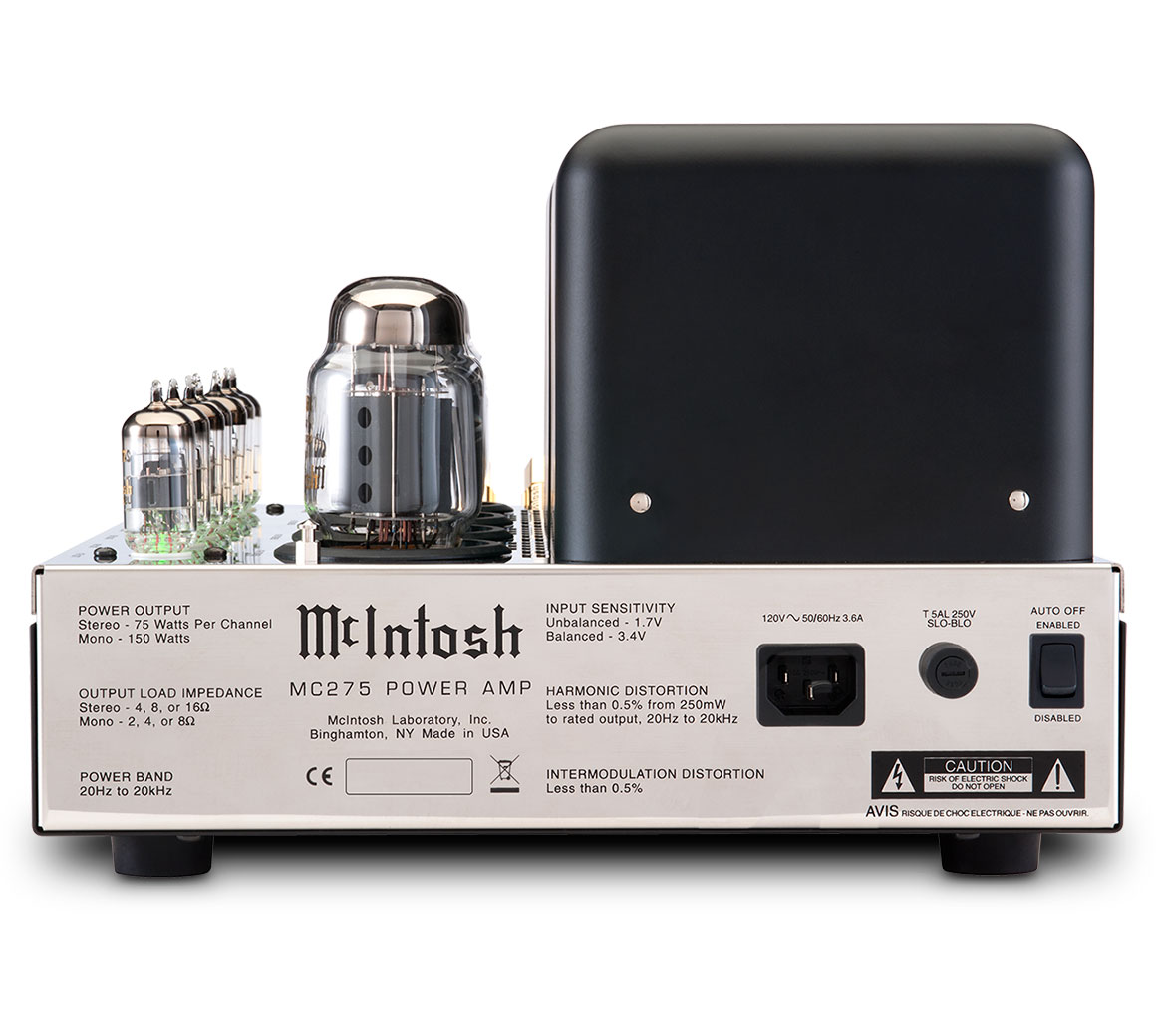

Sure, here is an image (from their site). I cannot comment on what has changed (or not) since the original.
I have a model MA7000 in my workshop. Signal ground is connected to
chassis. It will be the same with your MA7900.
The same connection signal ground to chassis and so safety ground is in
the new MC275, visible on p. 7 of the service manual. This alone is reason
enough for a ground loop between both amps.
It is bad practice to connect SG to chassis directly.
The connection should be replaced by a resistor of 10 .. 30 ohms, 2 ..5 watts.
It is sufficient to do so in one amp, and easier in the 275.
This should be done by a competent electrician or repairman only.
