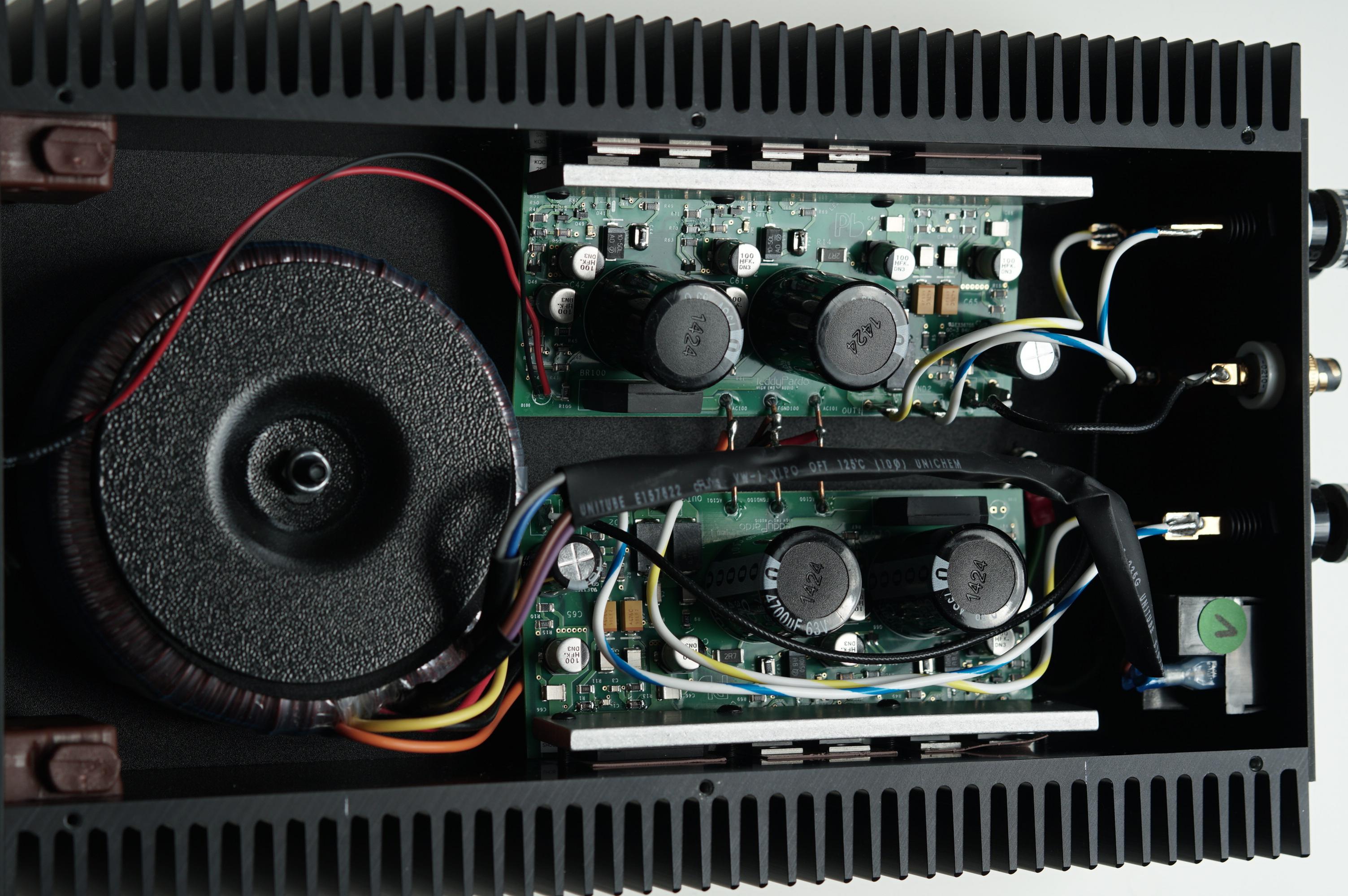

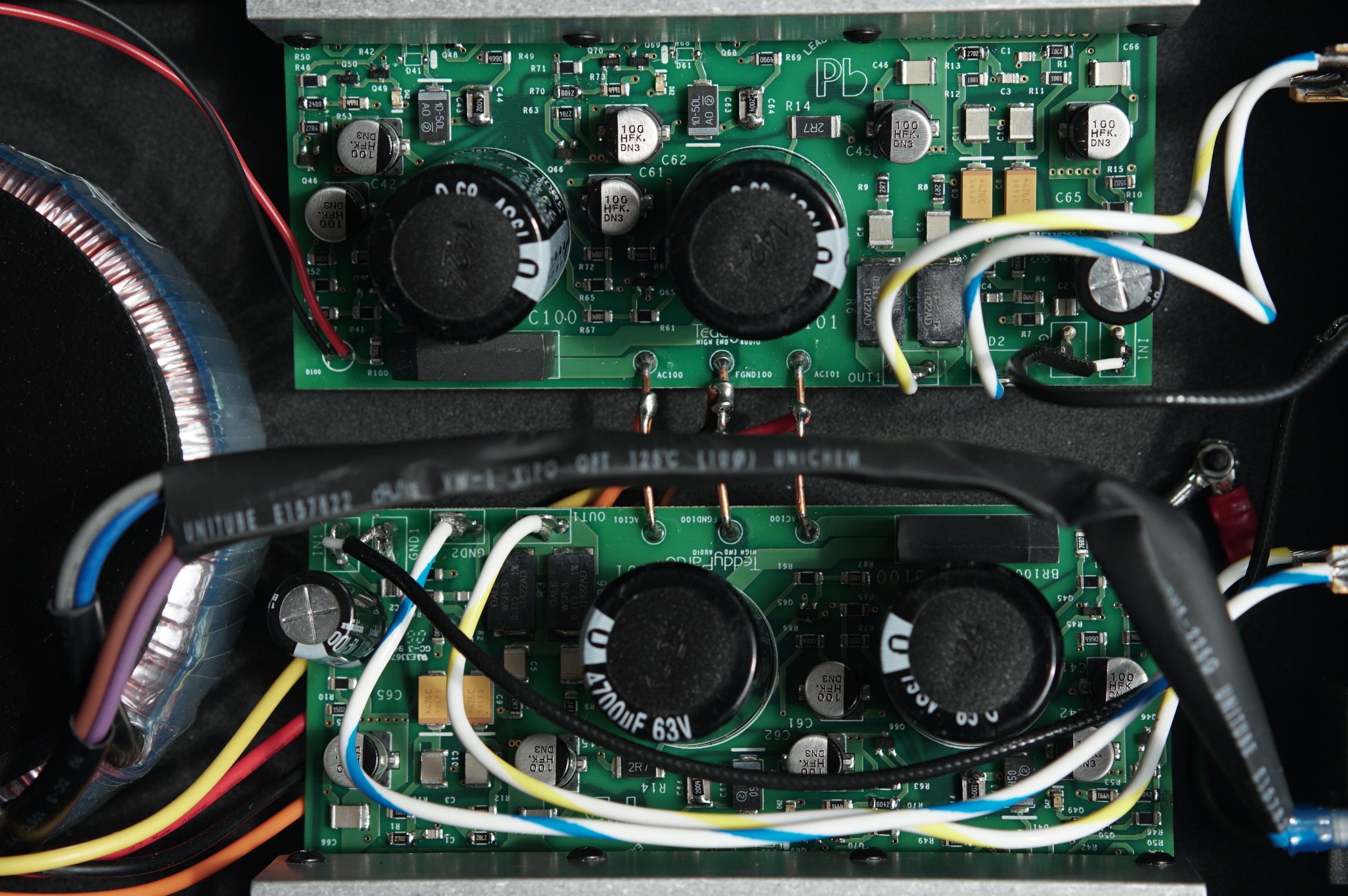

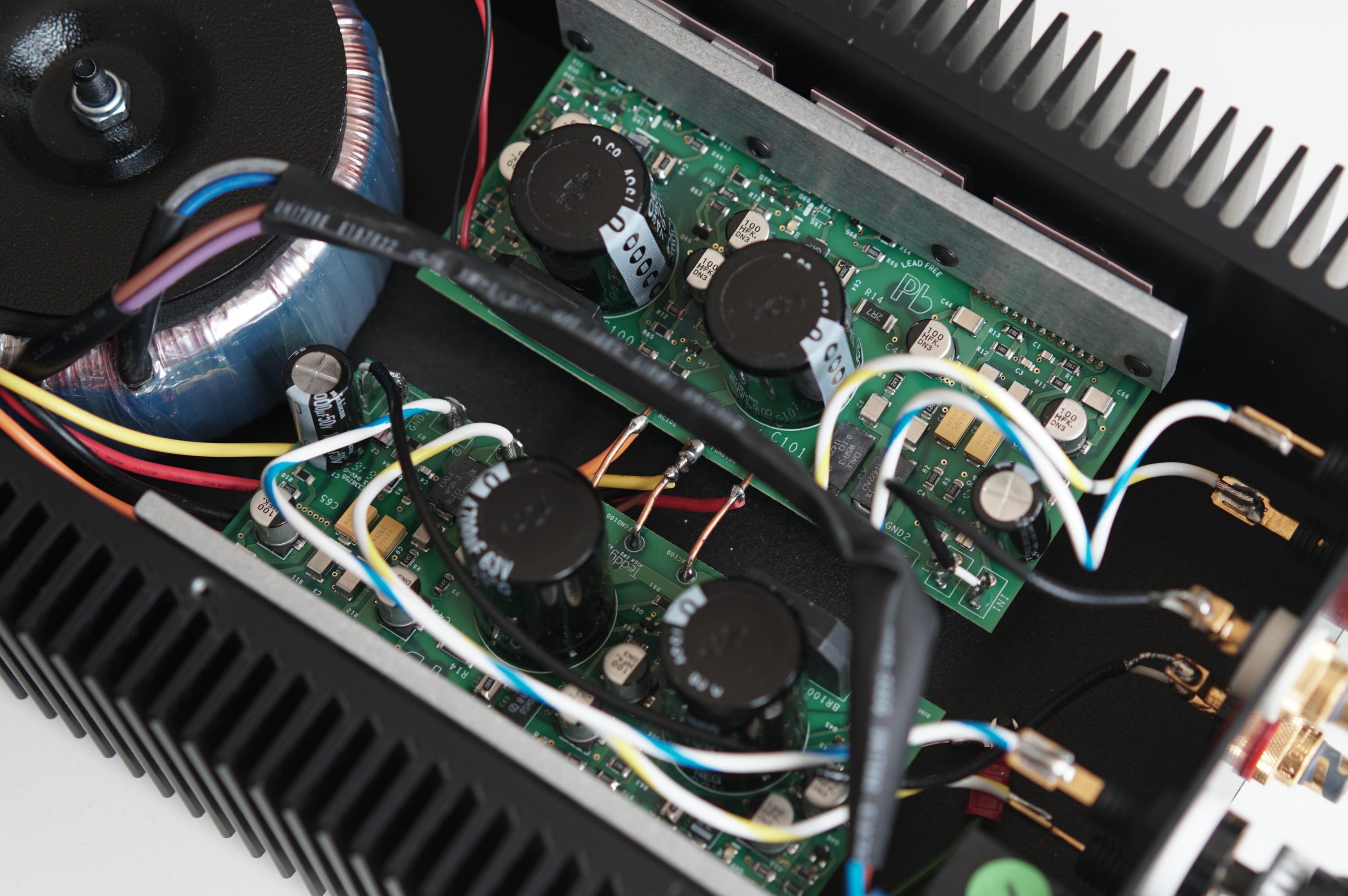

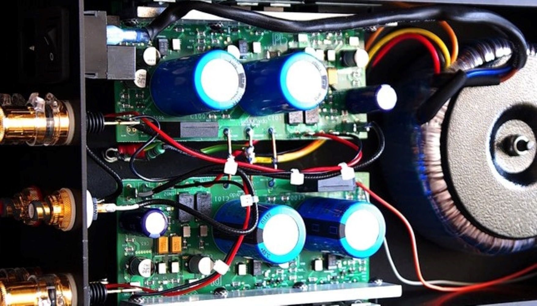

Thanks for pointing this out. I did post "rotating the transformer to move the wires away from the circuit board could help" not realising the significance of field leakage.The point where a winding ends and wires are brought to the outside is a strong source of stray field a
