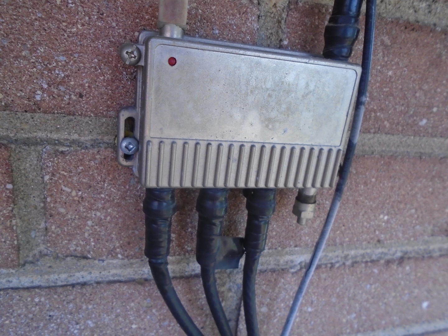

Okay, so the electrician came today. He and I are kind of chummy, so we worked together doing more troubleshooting. We connected the antenna system ground to the sub-breaker box nearby . That is the same breaker box to which the outlet for the stereo system is grounded. It made not much or no difference. Now, both should systems should be at the same ground potential, and electrician said the sub-breaker was properly grounded. That led us to believe that maybe the hum was not because of a grounding issue after all.
At this point, I'm gonna go and get a cable ground hum isolator. But for long-term purposes, the electrician and I were wondering if the antenna amplifer is making the noise. Can those things make noise that sounds similar to ground hum? Perhaps the gain on that thing is higher than it needs to be? Of course, the antenna amp's gain is not adjustable.

...wondering if the antenna amplifer is making the noise. Can those things make noise that sounds similar to ground hum?....
Of course. It connects to 60Hz power, also eats it. Maybe the main filter cap has crapped out.

This is the newer version of my antenna amplifer, an Antennas Direct CDA4.
Amazon.com: 4 Port DTV Distribution Amplifier - CDA4: ANTENNAS DIRECT: Home Audio & Theater
Are these known to be noisy at all?

I don't know anything specific about the antenna amplifier but power supply components like electrolytic capacitors do wear out and this is an inexpensive amplifier so after six years it might be time (or not).
Do you believe the problem has gotten worse over time or is the result of a recent change to components?
One way to isolate this is to disconnect the antenna lines from one component at a time (leave disconnected) and see if this has an effect, if disconnecting one item in particular greatly improves the situation that device is a candidate for an RF isolation device, at these frequencies one that uses capacitors that you can install right at the offending device should help.
