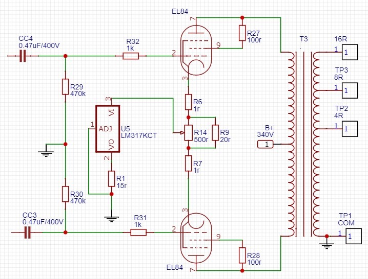

So far I have settled on EL84 PP from TubeCad. With the replacement of 6N1P with E88CC.
One of the few tested circuits + not low voltage.

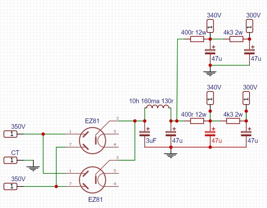

OT - 9000 - Primary (no UL)
PT - 350-0-350 (200mA) + 3.15-0-3.15 (6A)
Rectifier - pair ez81 or CC (octal tube will not fit in the chassis)
Now I'm struggling with the power scheme.
With my beginner knowledge I can't find a neat way to get close to 340V from 700CT.
I have a choke LL1685 10H / 160mA / 130r (saturating current 230mA) But I'm not entirely sure that it will work as a LC filter with reg.capacitor. Without an choke input , i need a lot of dissipation in the resistors 800R 25W .
I would really appreciate any advice on a power supply circuit or an amplifier circuit.

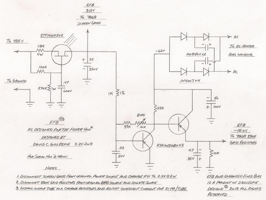

I meant to add that instead of the 6973 tube it would be easy and inexpensive to employ a mostfet to control the voltage. Even better, Dave Gillespie’s mods routinely engages this approach (on pentode outputs) in his EFBII scheme to control the screen voltages in a fixed ratio with B+, rather than a fixed, regulated Vg2. More information is here covering a Fisher AA-100, which is similar to your Grommes with EL84/7189 outputs:
https://www.audiokarma.org/forums/i...-pics-fisher-sa-100-clone-in-progress.466229/
Here is his design for Fisher 400, which uses 7868 outputs, but the voltages are similar to your application with EL84 and could be tweeked. Higher that datasheet voltages for EL84 were originally used by Grommes, but by keeping the plate dissipation below 12watts per EL84 with EFB, they will live happily at these voltages:
I would say that your proposed power supply scheme is excellent. B+ voltage can be easily adjusted with the value of the input capacitor (more or less than 3u3F). When this amp was designed, valves were cheap and available, so were commonly abused to give more saleable WATTS. Today's perspective is different.
Similarly, the output stages' common cathode resistor and tiny bypass capacitor are cost-saving artifacts of their time, and should be corrected. Individual cathode resistors with much, much larger bypass capacitors give superior performance, and are easily affordable today.

Additionally, a short search on the forum led me to a circuit with LM317 (the picture is attached). I'll try to implement this because the reviews are positive.
Thanks everyone.

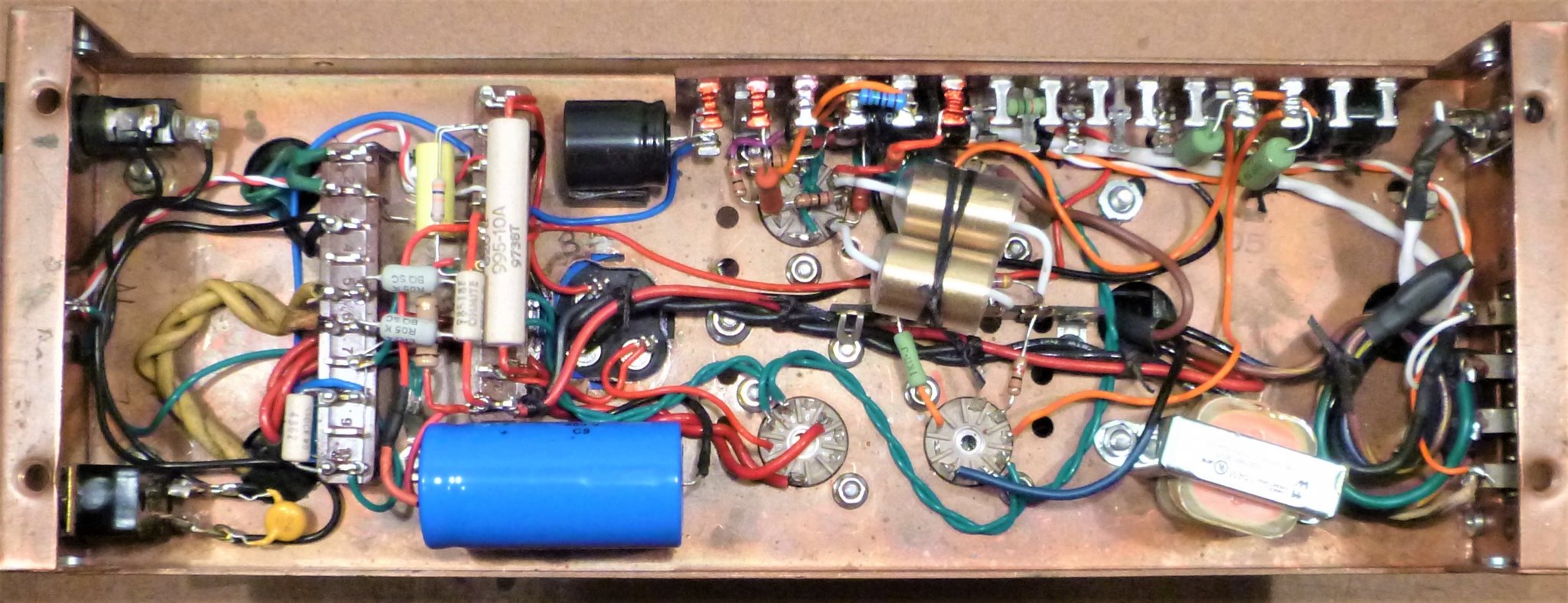

I recently rebuilt two Fisher 20-A mono amps. The original circuit was pretty crap, no grid stoppers, super-high B+, over 100% dissipation on the EL84s. I changed it over to the Tubelab SPP circuit (12AT7 gain/phase splitter) and added a couple of extra nodes in the B+ with a big resistor to drop the voltage down to around about 325. I cleaned up the grounding and floated the filament supply like the SPP does. They work great and don't eat their tubes. If you are going to run triode mode, you might want to really watch your B+.
