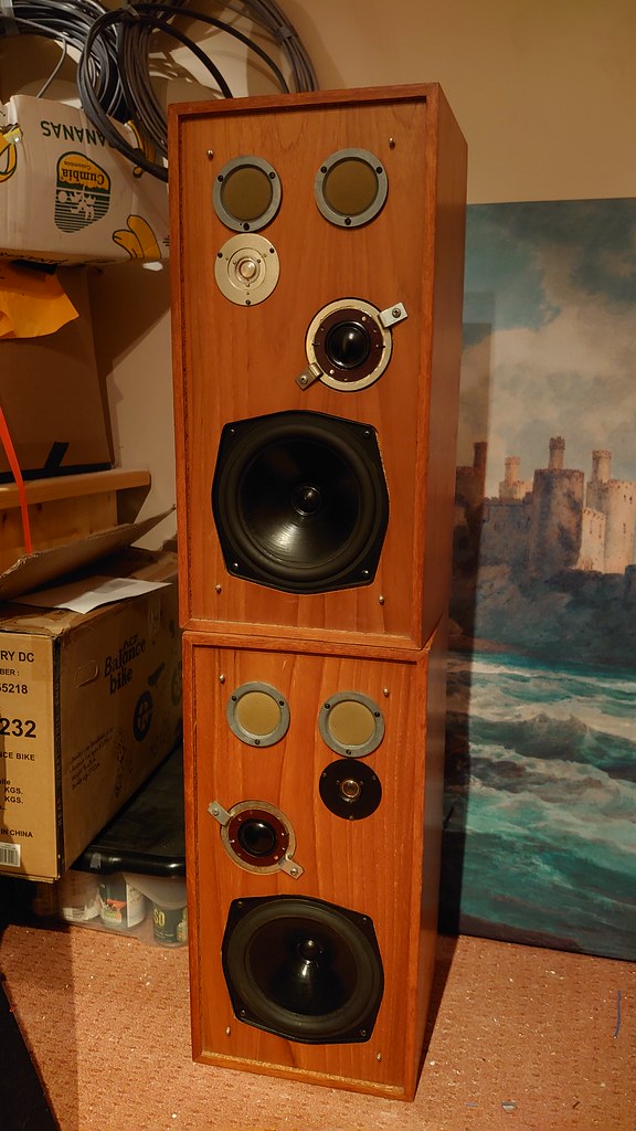

Griffin Aperiodic 27
Griffin Aperiodic 27 (1980's)
Design by Paul Griffin, made by H.K. Griffin & Co (Electronics), West Bromwich, UK
KEF B200 Bass Unit, 25Hz ~ 2.3KHz
KEF T52 Mid/treble unit, 1.6KHz ~ 7KHz
Coles/S.T.C 4001K hand-picked super tweeters, 6.5KHz ~ 25KHz
Power handling > 70 watts continious, 8 ohms
I purchased two sets of these back in the early 80's from a fancy HiFi store in Redcar, Yorkshire, England. One set has been in storage for over 30 years, the other set has been used from time to time. I recently connected to a modern Marantz amp and really enjoyed the sound in a larger room. What I have noticed recently they sound so much better at slightly elevated sound levels in a larger room and good quality amp.
Their agility and accuracy with Jazz, Classical, and Vocal music is astonishing,

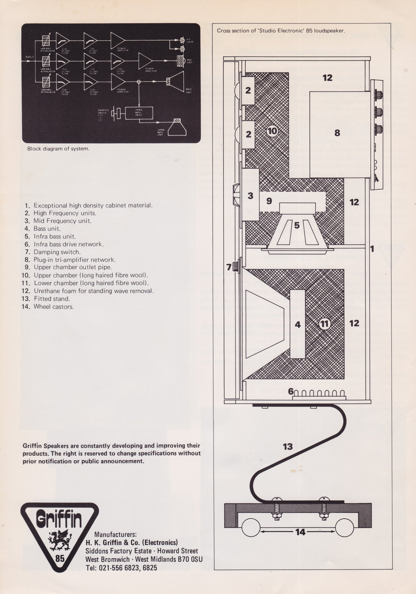

A "unique crossover" makes the impedance of the speaker remain very close to 8 ohm at all frequencies, while the bass unit resonance is acoustically removed by a "twin angled port system".
Not your usual "aperiodic" arrangement of a resistive vent then.
