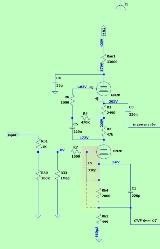

Grid-to-cathode capacitor: is this part of feedback?
Hello, in very few diagrams I have seen this capacitor from the input grid to the cathode (C9 from 22pf to 330pF). Since, to my surprise, in the simulations it widens and flattens the frequency response (if it were grounded it would cut it), I wonder if it is part of the feedback network (negative or positive? maybe part of GNF?) and what the possible benefits and values suggested are. Thank you for your possible clarifications.

Yes it is a form of feedback. Not GNF - where would the global loop be?
Since the grid and cathode move with the same phase, it is positive feedback.
Positive feedback, in itself, will promote instability.
In contrast, the capacitance between anode and grid is negative feedback, because the anode and grid move in opposite phase (one goes up, the other goes down, and vice versa).
It lowers the gain, because decrease in anode voltage works, through Cag, against the increase in grid voltage that caused the anode drop in the first place.

It is local positive feedback ( higher gain ) at high frequency , because the cap is small . The cap should have just the minimum capacitance to compensate for other loses in high frequency response . Probably it is used just because 6n2p is not a good choice in the first place for a SRPP and any load would kill high frequency fast .

I have not LT-Spiced this, but my brain spice tells me that this cap will roll off high frequencies. This cap connects grid to cathode at high frequencies. Therefore, there will be no signal to drive the Gm of the tube at high frequencies. The tube functions as a constant current source at high frequencies.
I believe this cap is used to block out of band signals from being demodulated by the tube. Think RF noise, switching power supplies, cell phones, noisy mains etc.

Good point. It depends on the impedances.
As I see it, it will work as positive feedback if there's some impedance at the cathode where the cap can inject some signal.
In this circuit, the cathode is decoupled to the feedback return (impedance unknown) so any signal coming in through Cgk will still increase Vk. So I still think it is feedback.
If the cathode had been totally decoupled, and acted as a ground for AC, then I would fully agree with you.

Normal RC filter that cut high frequency is connected to ground , to cathode is positive feedback , but is rarely used and could create confusion .

That's quite clever, it will reduce open loop gain and could be used as the dominate pole, but much less effect on frequency response than if placed across the input to ground. It protects both RF on the input and on the speaker cables by preventing rectification of the RF in the first tube. Could also be the beginnings of an oscillator too. One to remember.
You did not give the complete and accurate schematic of the amplifier.
That is important whenever global negative feedback is used.
All the poles in the amplifier need to be considered and analyzed.
Perhaps C9 is a high frequency pole that makes up for the rest of the gain phase of the amplifier, including the output transformer.

I think there a two possible explanations leading to the same result:
a) The cap lowers effective feedback at HF (negative feedback minus positive feedback).
b) The cap lowers open loop gain at HF, also resulting in reduced feedback ratio.
Can anyone falsify one of the theories?
1) This cap effectively shorts out the input to the amplifier at high frequencies, this is true for both the feedback (-input) and the signal input (+input).
2) Roll off at high frequencies does produce phase lag at high frequencies. This can affect the stability of the closed loop stability. Depending on the rest of the amplifier design, this can either enhance or degrade the response. If the pole occurs at a high enough frequency, it will have little affect at all.
3) There is no net positive feedback.
4) This location for the cap is a good one to block HF noise from entering the amp from either the feedback (speaker terminals) or the main input.
