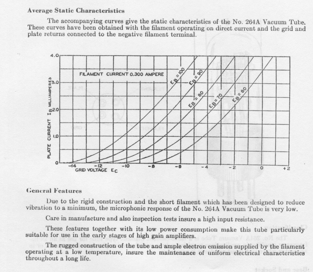

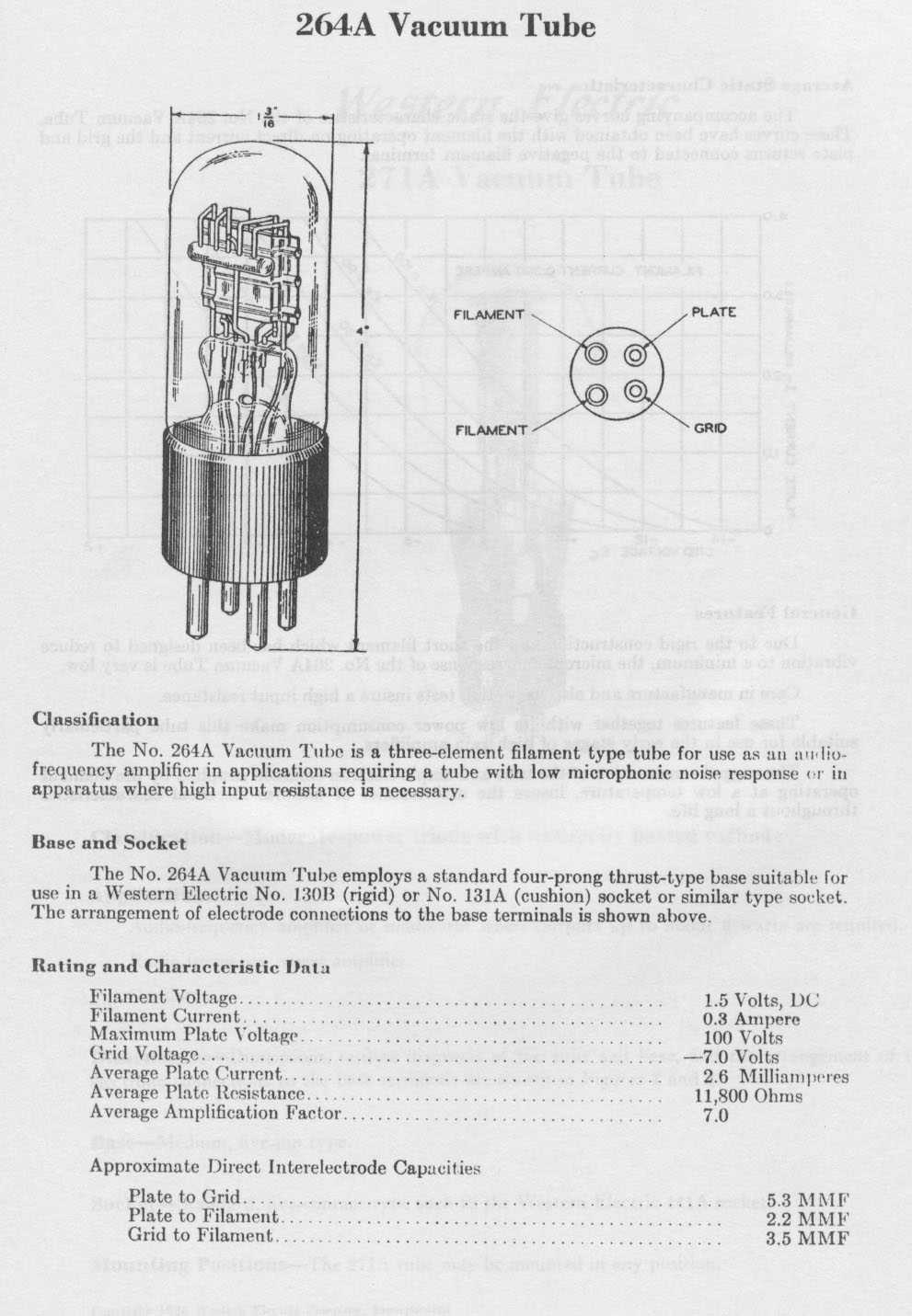

Ancient Low Level Toob for Low Microphonics
For those who still want to use a relic in the amp front end the 264 or 864 will fill the low microphonics requirement. Built from the bottom up to be free of microphonics..🙂
  • 864.pdf
    864.pdf
