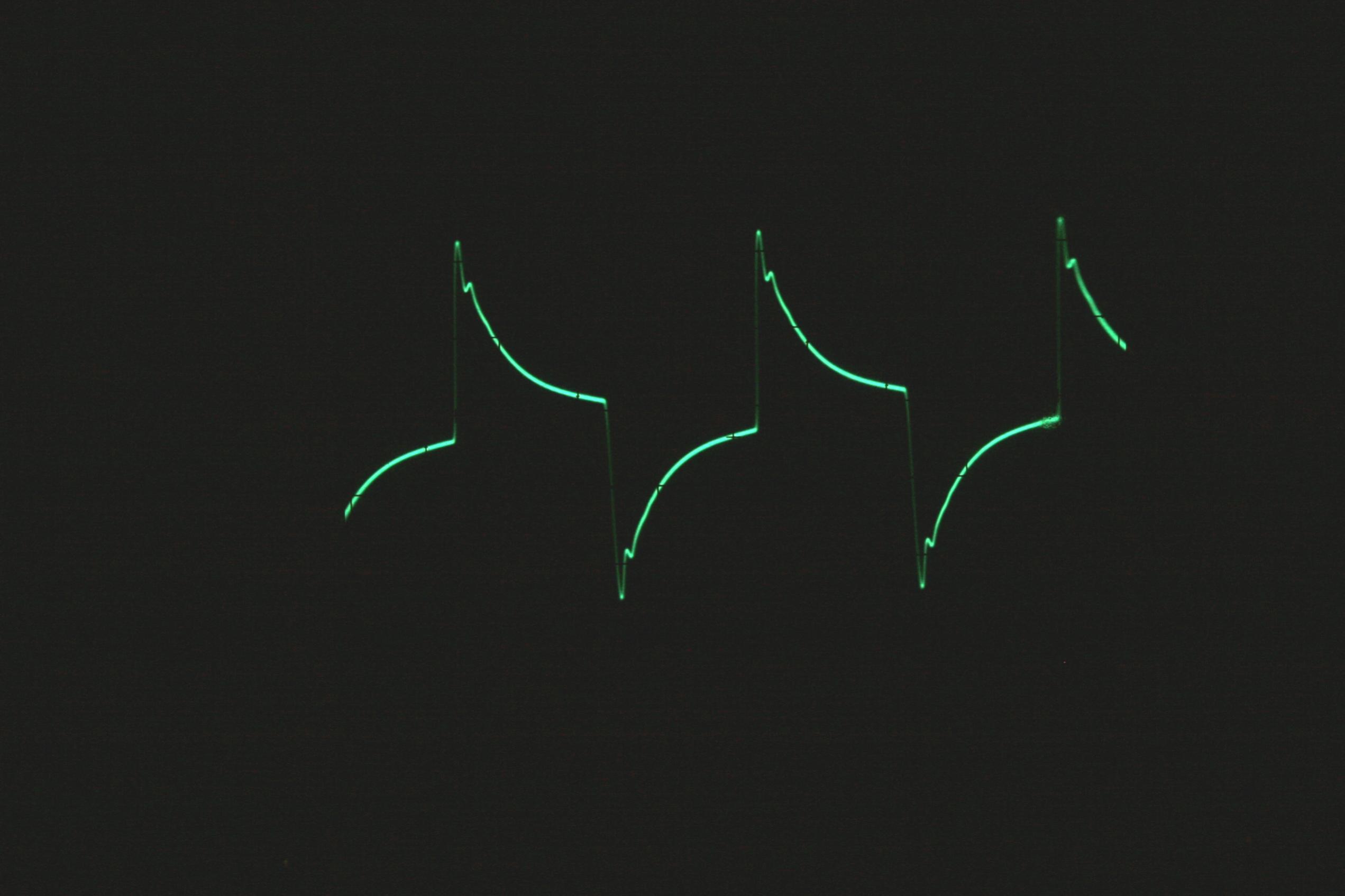

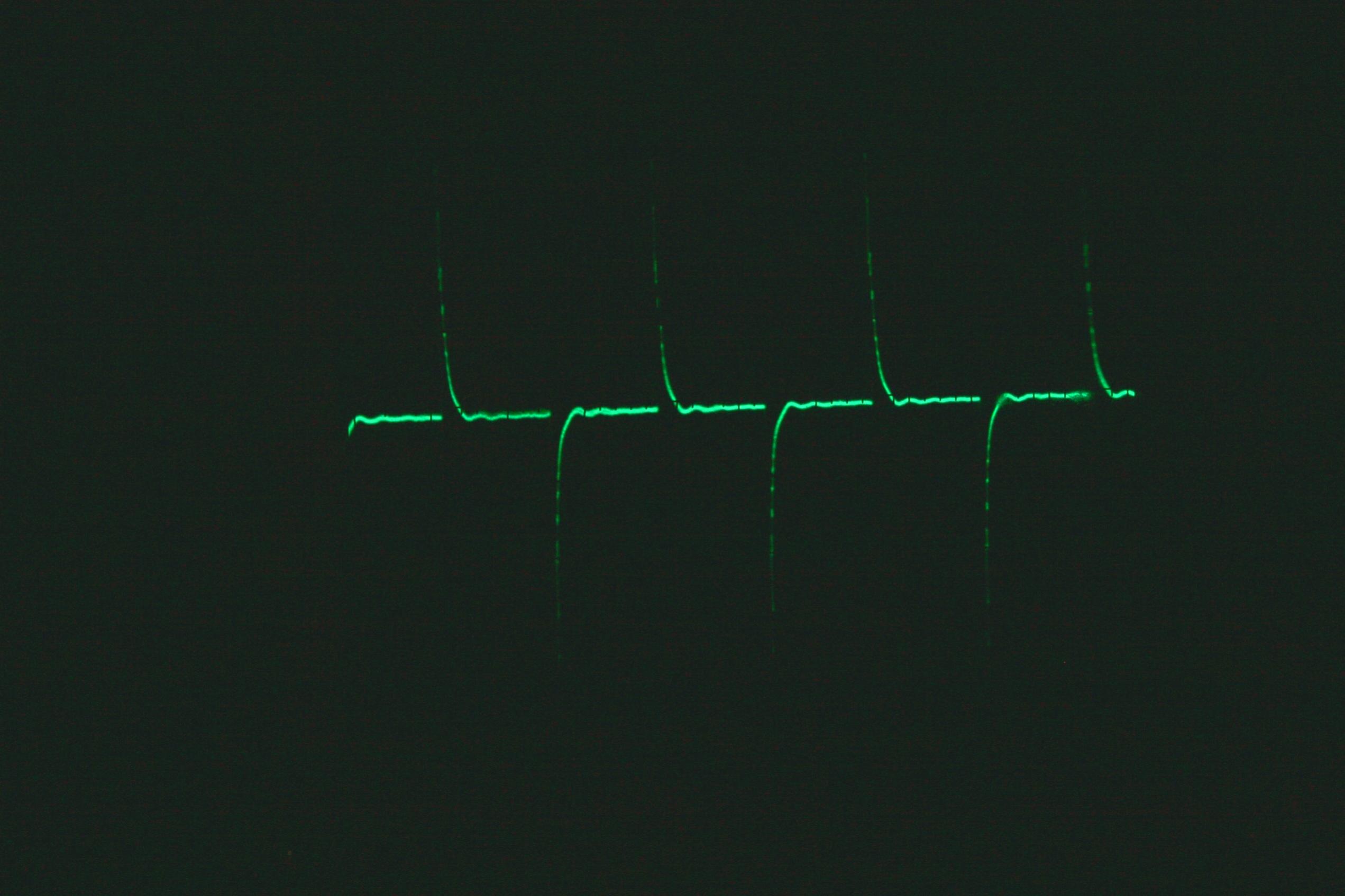

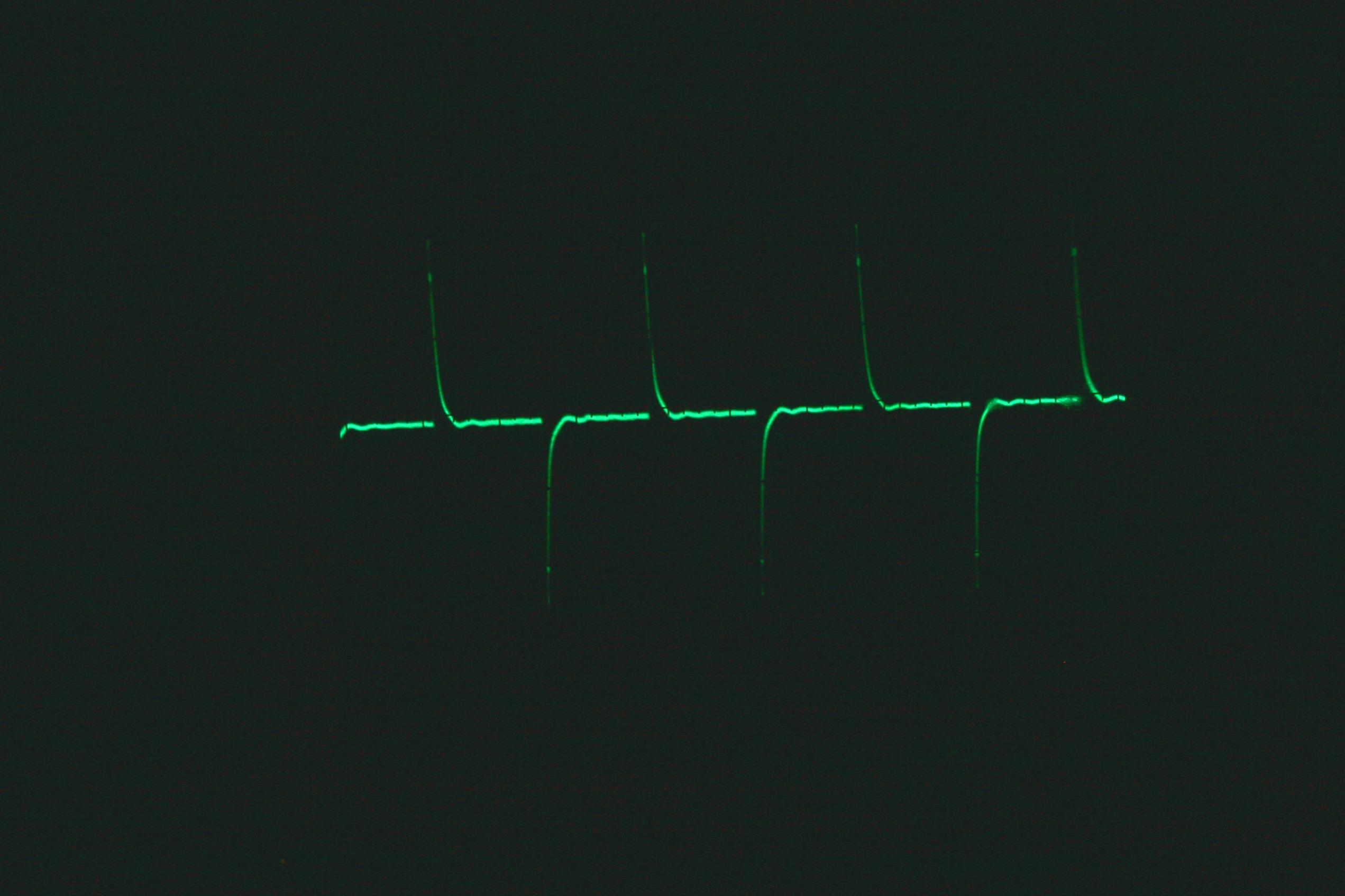

OK, back to the original topic - I picked up a Tektronix 2205 20MHz oscilloscope and a Tektronix AFG310 arbitrary Function Generator from work and hooked it all up last night. I needed to make a couple BNC to RCA cables but other than that it all worked out pretty well.
The pictures below show, in order, a 2Kohm square wave with only the oscilloscope loading (no resistor across transformer +/-) a 10kohm square wave with no loading other than the oscilloscope, and the same 10kohm square wave with 2.2kohm loading across the transformer.
The 10kohm square wave shows ringing without a load resistor; adding the 2.2kohm resistor seems to solve that problem nicely.

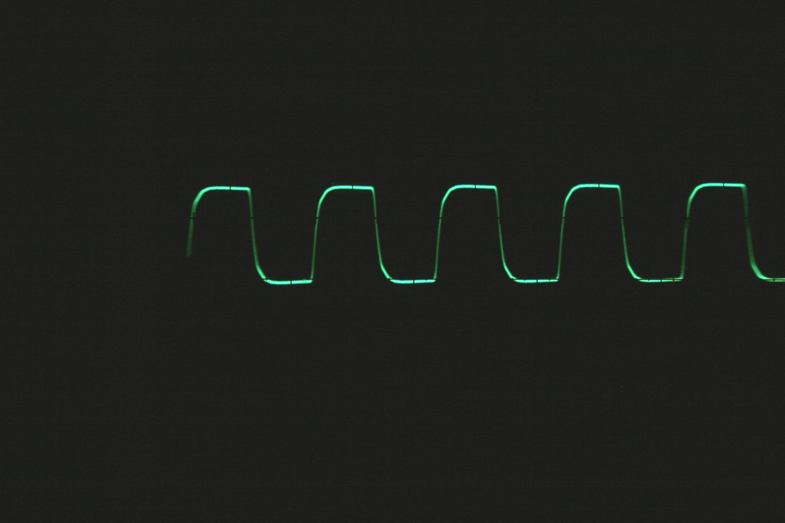

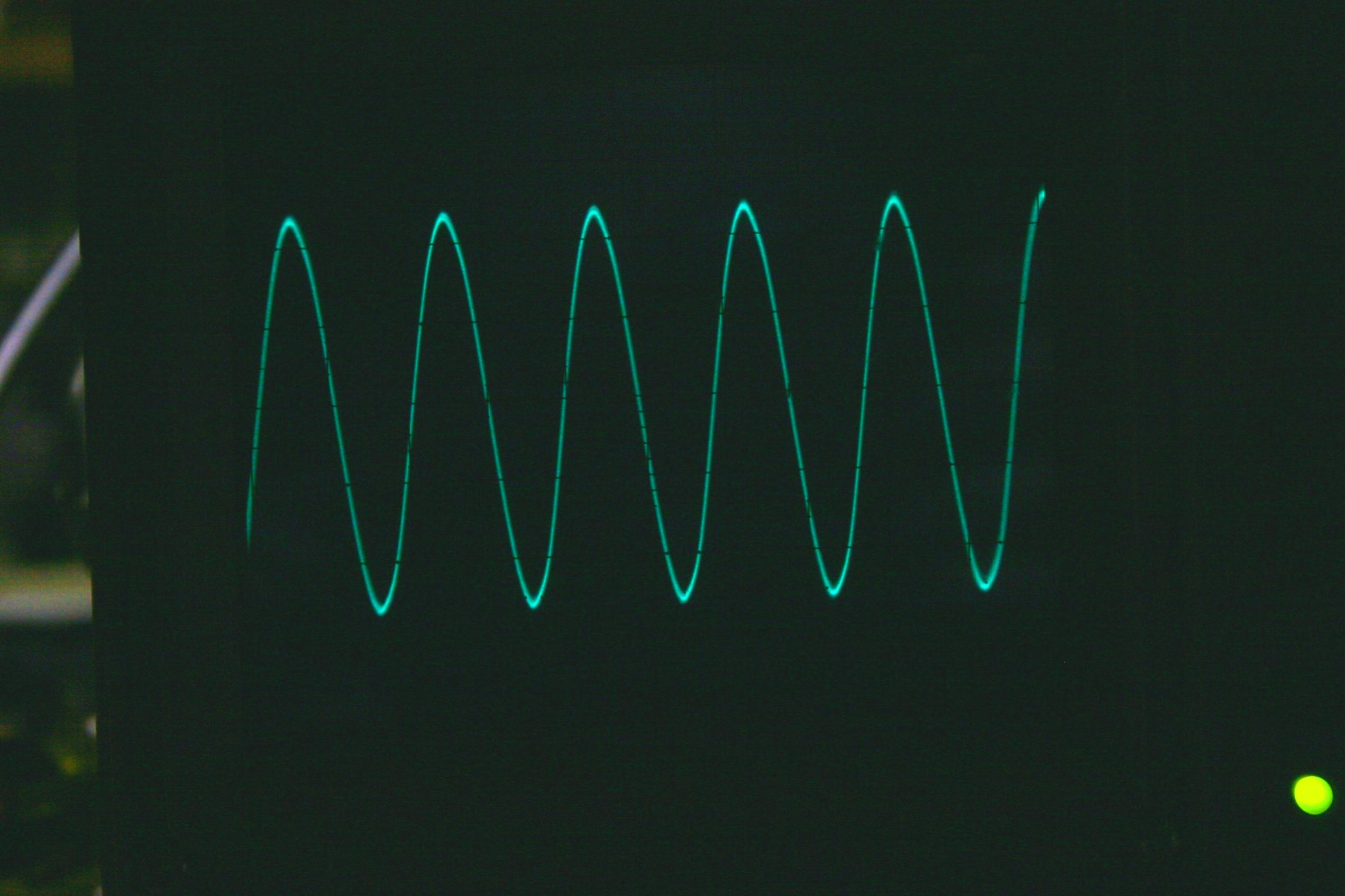

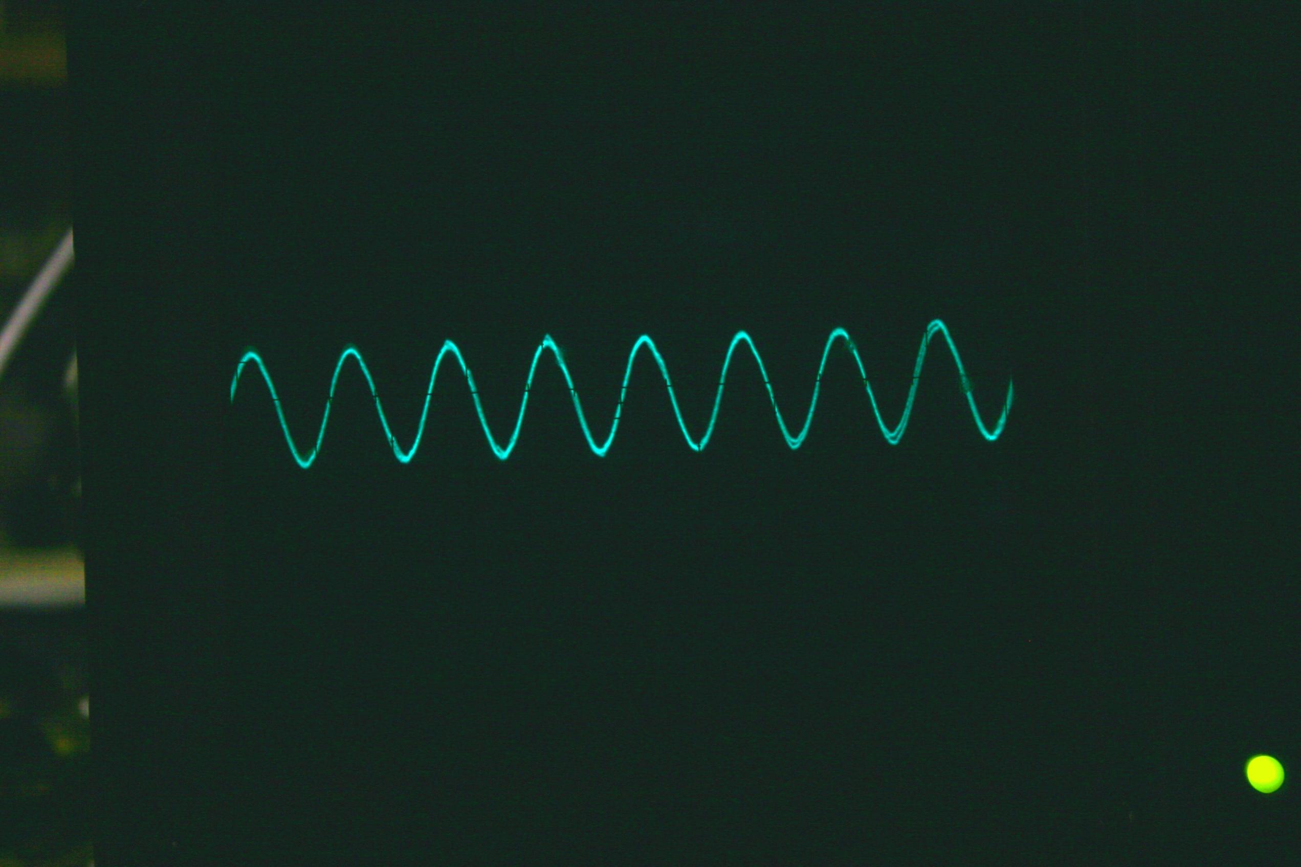

Some additional scope pictures.
The first is a 2kHz square wave with the 2.2kohm load resistor - I think it looks pretty good.
The second is a 2kHz sine wave, and the third is a 20kHz sine wave. Also looking pretty good I think.
Of course the ultimate test is listening. After I took all the scope shots I hooked it all up and listened for ~6 hours. The preamp sounds EXCELLENT with the LL1674 transformers and the 2.2kohm load resistor. The biggest improvement I notice over stock is in the details, especially bass details; it is now very easy to follow the bass player through an entire song.
By the way, while I was in there I did some lead dressing to clean things up a bit. This dropped the hum level down to ~1mV; hum is conmpletely inaudible, even with my ear to the speaker!

I'm curious as to why the waveform reproduced by the O-scope does not look like a square wave, however. It instead appears to be a derivative of a square wave. Do I have a setting on the O-scope or function generator incorrectly set?
The preamp sounds great, but the shape of the plots is bugging me. Any help?

After further thinking, I'll bet the square wave problem has to do with the cables I'm using. Since the scope has a 1Mohm input impedance, the capacitance in the cables will work with that impedance to form an effective high-pass filter.
The scope was in a drawer in the lab for the past 5 years, having been used for some RF sensor work previously, and I just grabbed some of the coaxial cables that had BNC connectors on them and made them work by cutting off one end and soldering on an RCA plug. Coax has a lot of capacitance and is really meant for RF work.
I will make some new cables and I bet that solves the measurement issue.
...It looks like the "ringing" I'm seeing may be purely the result of the crappy sound card!

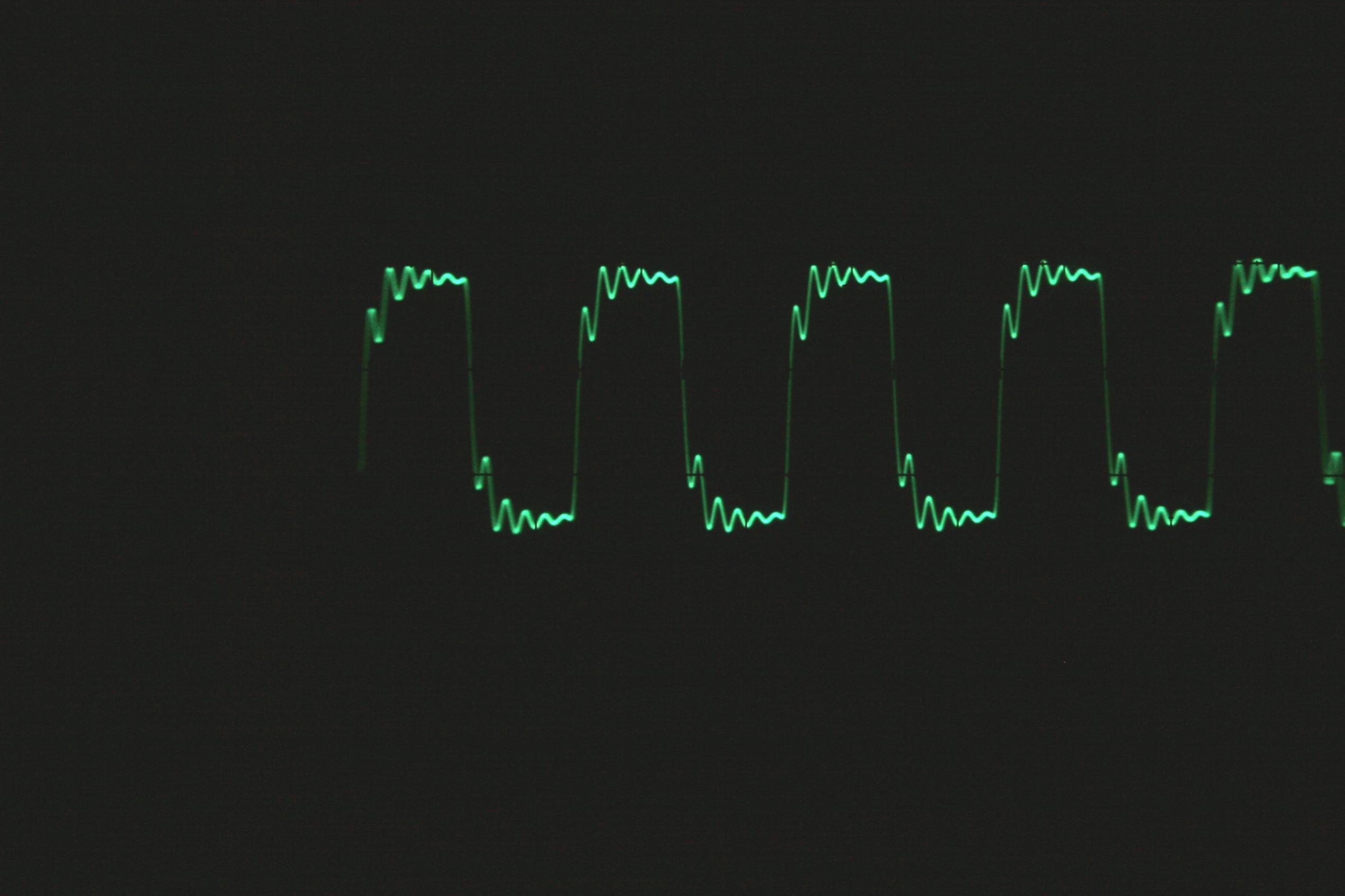

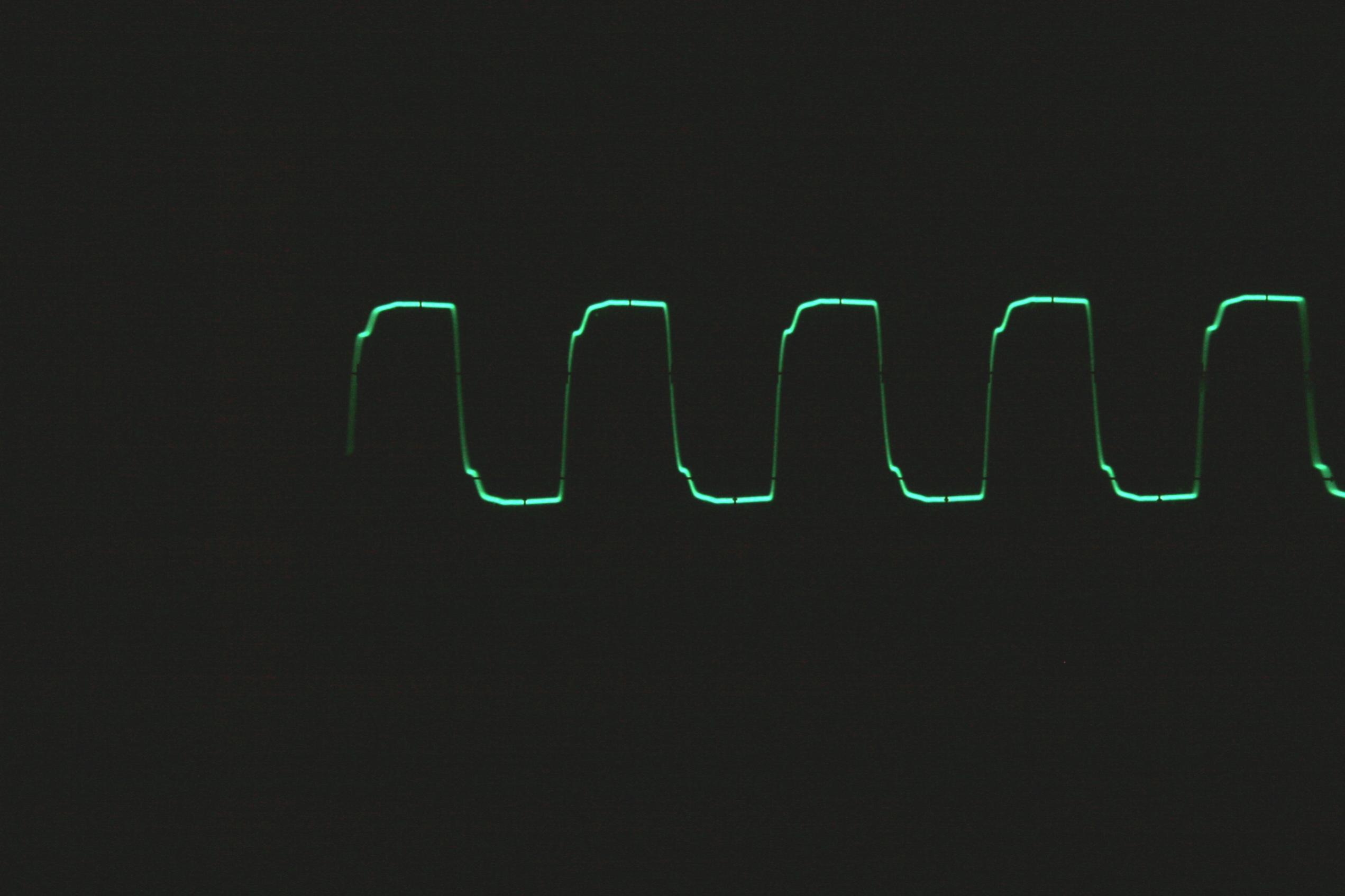

Well, I figured it out! The channel 1 output button on the function generator was a little sticky, and only a very small portion of the signal was getting to the preamp. I worked it a few times and now I'm getting the full signal from it.
Here are the traces for a 20kHz square wave with no transformer resistor loading, 2.2kohms loading and 1.5kohms loading.
What do you think?
