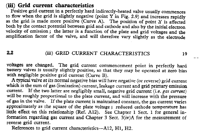

The problem perhaps arises from a little error in those items.
Control grids in a tube, has two current components:
1) a positive one mainly generated from grid emission,
2) a negative one, by catching electrons (Or the lasts impacting in the former).
Both of them varies over time, temperature, ageing, plate/screen currents, voltages in the electrodes, and many other variables. So, excepting tubes in which plate's current is very low and limited by a large plate lead resistor in non linear amplifiers (Class C for example), usualy it is undesirably bias a tube only with grid leakage.
