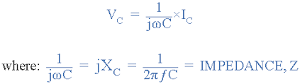

A consideration is also sensitivity to induced noise. Using a small capacitor as a l.f. filter, leaves the grid at a high enough input impedance to pick up induced stray fields. In that sense it makes sense to use a high enough coupling capacitor to keep the input impedance low and go to some other RC coupling to reduce l.f. pickup.
