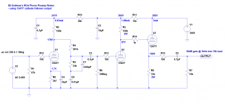

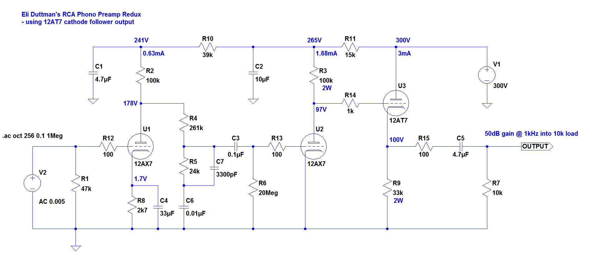

Hey, I have a question for you... How awful would it be to use a 12AT7 cathode follower instead of the source follower on the output?
I was also thinking I can get 300V for B+, easy.
Something along these lines? (attached)
If you want to use a triode as the DC coupled voltage follower, be my guest. IMO, the enhancement mode MOSFET is superior. The FET requires no heater power, occupies little space, does not have a heater to cathode potential limit, and is very easy to set up.
Well executed voltage followers, regardless of active device technology, are highly transparent. Sloppy execution yields BAD sound.
100% agreed on the superiority of the MOSFET in this application. I'm just looking to put glowing tubes on view.
Thanks Eli! That prompted me to go back and make sure the 12AT7 follower was in a good spot. It wasn't. A 12AU7 is more appropriate there, no other values need to change. Distortion should be reduced by 3X.
Changing the cathode load resistor to 60k would put the 12AT7 in a better place, but then the plate current is only 1.6mA or so. The 12AU7 drawing about 3mA is a better choice for this particular application.
I'll try the Zetex MOSFET follower too. I wonder if I'll hear a difference... I expect the MOSFET follower would work noticeably better into a solid state amp or receiver.
