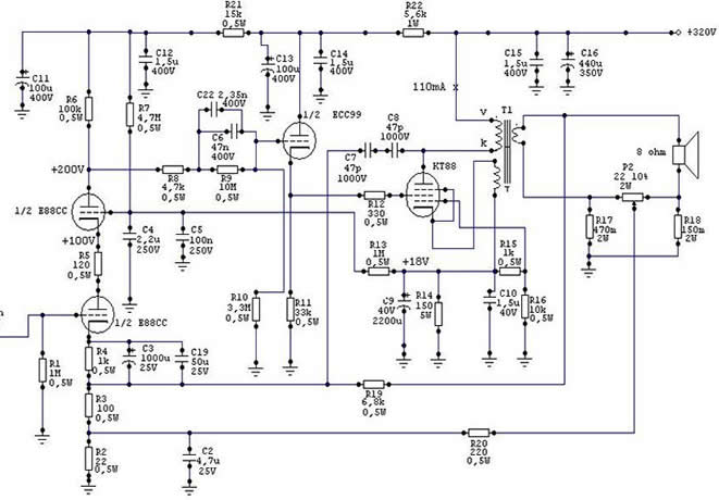

Yeah, actually the design is there, still uncorrected 🙂
If someone knows which unnecessary caps to remove - go on, do it and try it if you want to 🙂
Note, that it will work in this stage, too, so it's already able to do something else than just smoke 😀

hi again vortex...
i'm still here... well atleast i'm back again... haven't read that article yet.. will do soon.
i did a quick job on your schematic, and hopefully removed all the caps you didn't need to double without removing any that i shouldnt... get someone else to have a look as i'm bound to have made a mistake seeing as i did it quickly.
just for you information about doubling caps in the two un necessary ways you did.
fistly, you dounled all of the filter caps on your B+. this can actually be a good thing for the amp as well, as it will reduce ripple on your DC, but it's just a waste of time to go putting values on there in the nF range.. and this does nothing for your HF response (well actually it does as it effects the impedance of your DC, but thats another sotry, and it's not enough to worry about in this case)
seccondly, you doubled caps in the signal chain to ground... as they ae in //, capacitance sums together, and you get more capacitance to ground, which means you will bleed more HF to earth. this is bad as it actually decreases HF, which is the oposite of what you wanted to achieve.
hope this helps for now.
cheers
Final schematics
Hi
Thanks...
The original one - corrected by my father - can be seen here.
Enjoy 😉
This one will be built.

PS:
P1 won't be used - no volume control at the input, so if you have a preamp (as I'm going to have), just simply let it off.
Same for C1 in case the preamp is capcoupled at the output.
