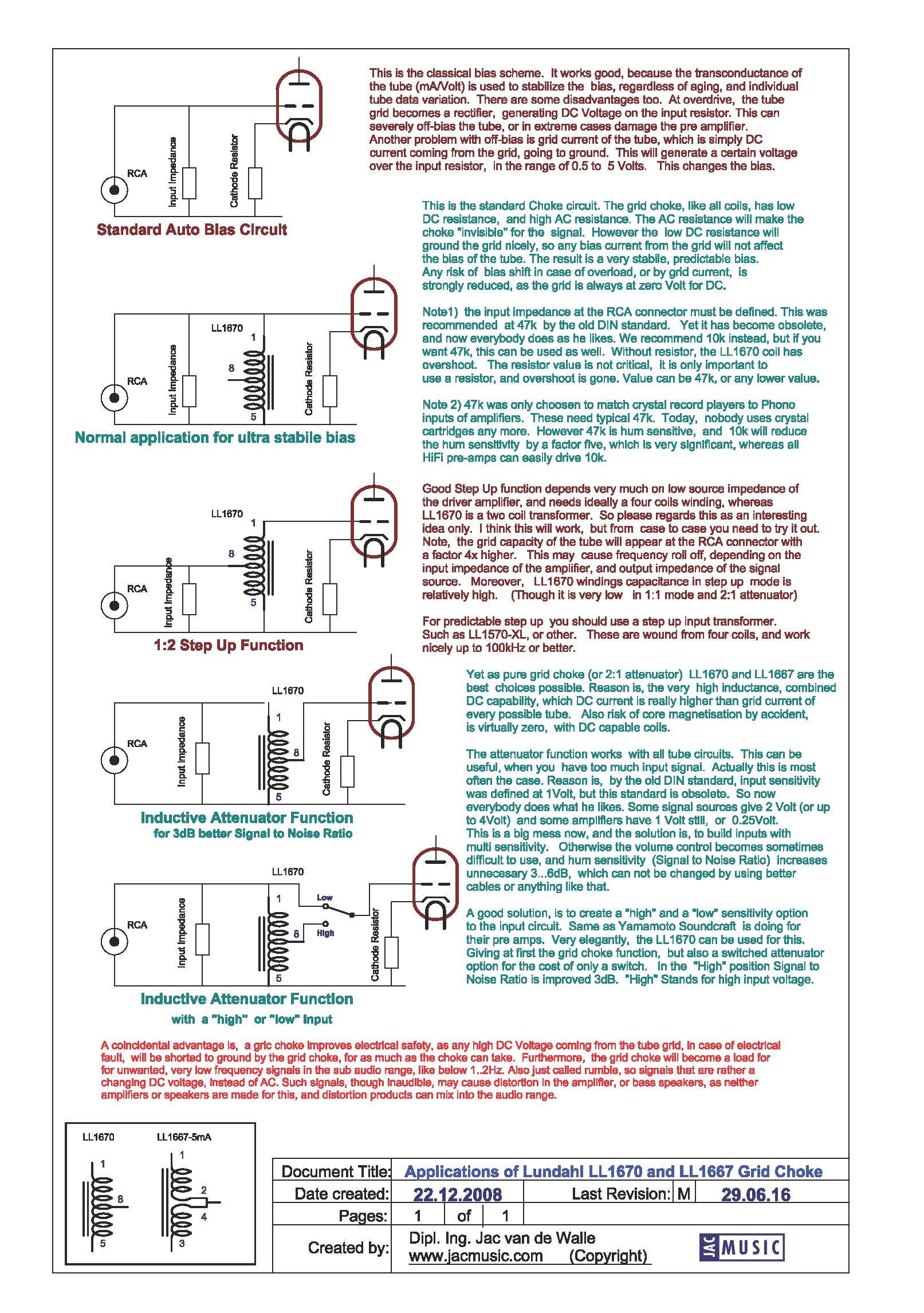

Not being familiar with the concept I found this, interesting:
