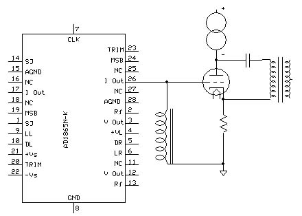

I have a DAC that uses a resistor (~200R) as the I/V. This resistor doubles as a grid leak and the signal is fed to the grid of a tube. Overall, this works surprisingly well.
But, it occurs to me that it might work better with a grid choke instead -- high Z, low DCR. Anyone have any thoughts? All of the grid chokes I have seen have much too high DCR, so I think it would need to be a custom part of some sort, or maybe just a low H hammond. Also, the particular DAC chip (AD1865N-K) has no DC on the Iout if that changes what will work well.
Attached is what I am thinking. If you replace the choke with a resistor, it is what I am currently using.
For a current output Dac, the load must have a much lower Z than the source.
An inductor has a very high Z, and would create extra distortion.
What I have seen people do is use a step up transformer to lower the effective load resistance while maintaining output.
