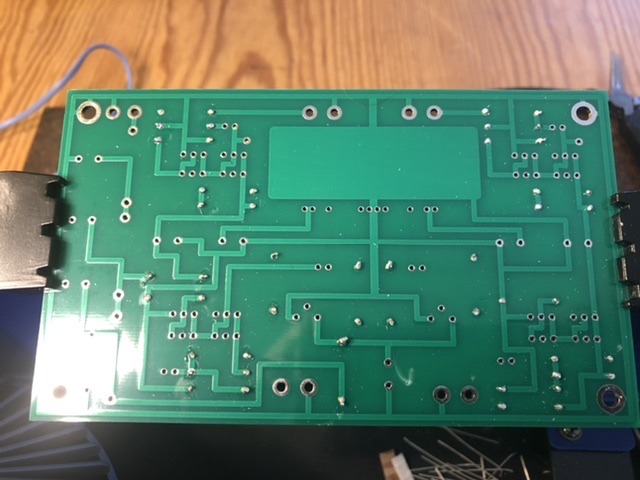

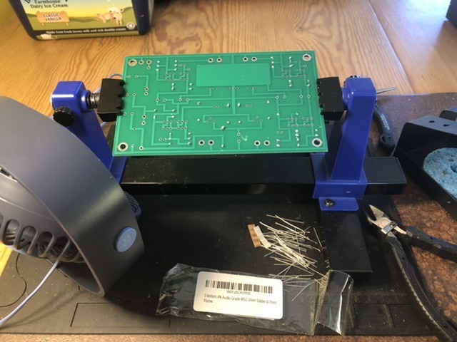

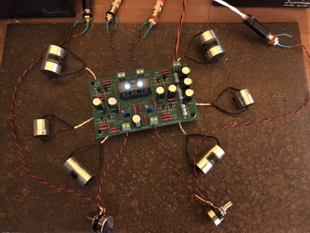

Update - so last year, after a couple of false starts I built Nelson Pass's wonderful B1-K Nutube pre-amp.
Nelson generously provided some matched Toshiba JFETS along with the initial batch of boards.
I managed to blow up a few caps - turns out wiring your DC input the right way round is important.
Got there in the end, though, even modestly upgraded a couple of components.
I will never forgot the thrill on switching it on and hearing music play through something that I built.
Since then it's been calibrated, is stable and in everyday use connected to our living room multimedia PC. A new DAC last year too - it's really singing through the B1-K.

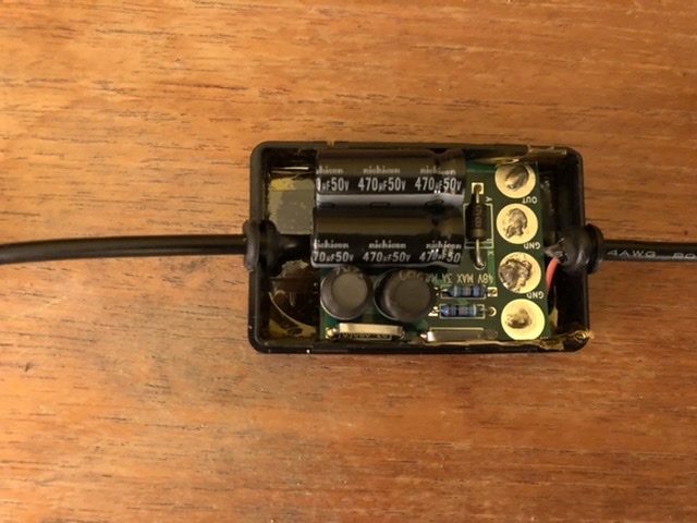

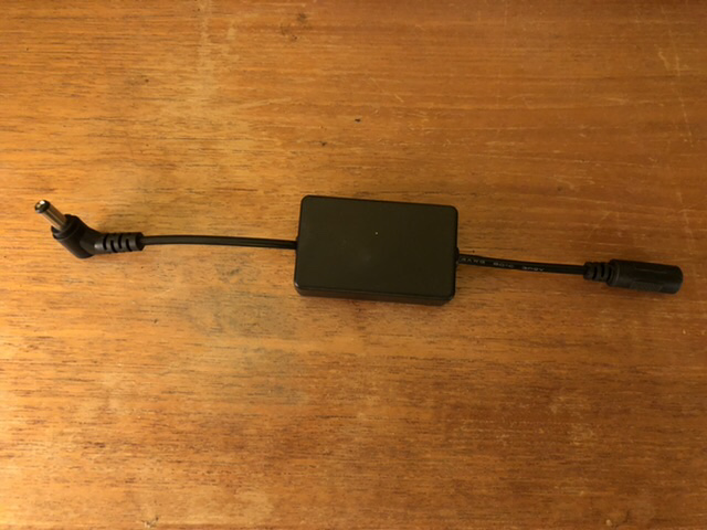

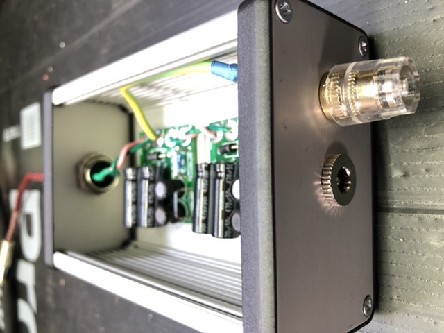

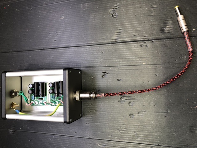

Next further B1-K development - Mark Johnson's PO89ZB inline DC filter, then a Silas UltraBiB power supply - I participated in a group buy for the parts and also managed to score a suitable Toroidy transformer. Then, I've got my eye on some ex-BBC (Sowter?) mu-metal output transformers, to correct the B1-K's phase inversion.

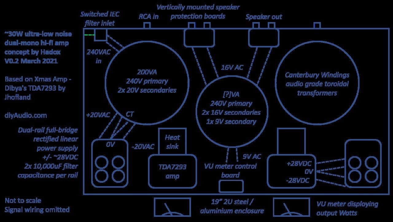

Next project - TDA7293 chip amp.

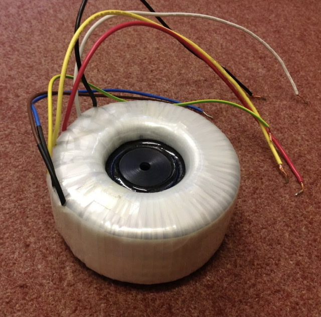

Some parts collected, including the TDA chips themselves, a fine pair of Dell heatsinks and two magnificent NOS hand-wound audio grade toroids which are massively over-specced. Sensible and proportionate, I mean.
The amp designer recommends the use of speaker protection circuits, as the TDA7293 is known to fail. The trafo man has another multi-secondary toroid which would fit the bill.
Going full monoblock adds ££ and I've seen a good price on a blank 19" 2u amplifier enclosure.
Here, then, is the current concept.

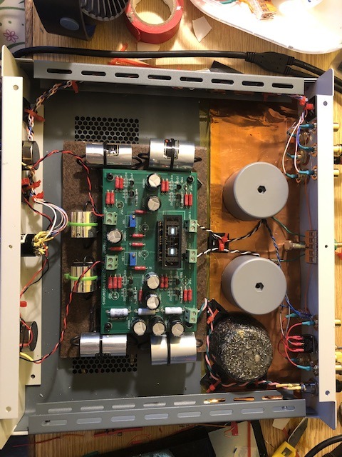

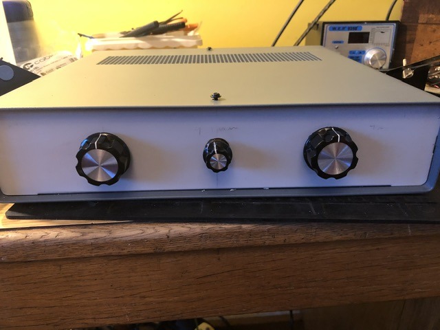

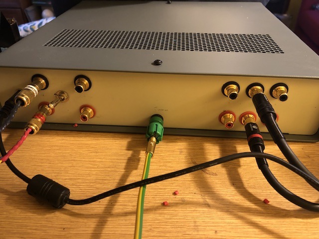

Completed B1-K build, in donated chassis.
Added a pair of mic input transformers, kindly supplied by Rex Halfhide at RCH Audio Engineering, to correct the circuit's phase inversion.
Switchable outputs mean I can connect to a headphone amp and maintain my favoured negative phase harmonic profile.
Rotary switch is a NOS mil-spec Blore Edwards, found on fleabay.
Grounding post on the rear connected to signal ground and chassis - pre-amp now acts as a grounding hub for source components and their respective PSUs.
I'm really pleased with how this has turned out.
